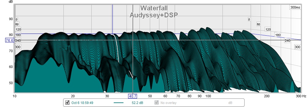

I'm ambivalent about adding the color grading. It doesn't add any new info to the viz and adds another dimension for confusing the observer. Notice the color grading is dependent on choice of vertical scale. 85-25, 75-15 and 75-15dB respectively. Right away, first's colors can't be compared with the second and third, yet, rest of the waterfall data can be.
That wasn't my choice, after updated to 5.19 beta 7a, that's the default setting. I was too lazy to change it.

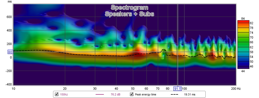

Oh! There it is... a couple more graphs.
View attachment 22570 View attachment 22571
This is both subs and speakers together with filters from REW. I haven't done anything manually or run Audyssey yet. The crossover is set at 150hz for this particular sweep. I just wanted to change the color and show a much improved waterfall and Spectrogram. Turning off all the noisy stuff in the house helped for sure.
This ain’t bad. Looks fixable. Bump at 54, gap at 75. Welcome to my world.

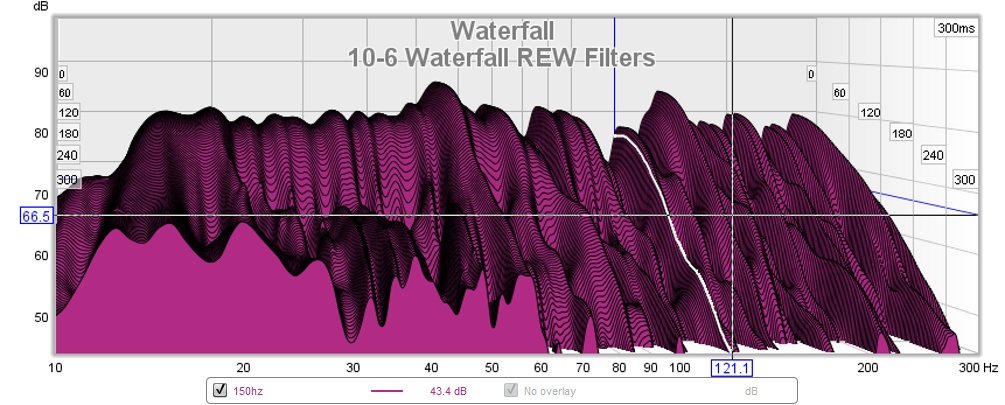

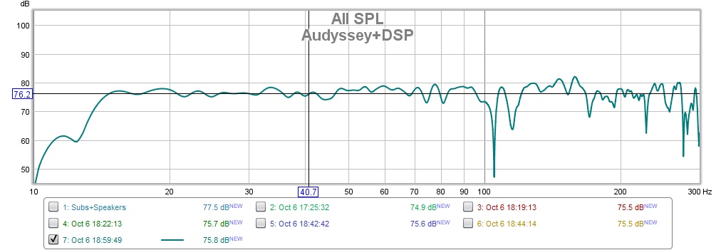

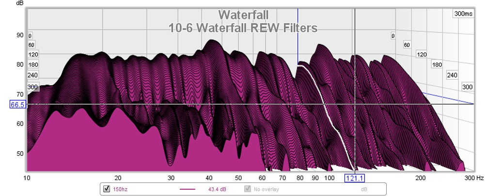

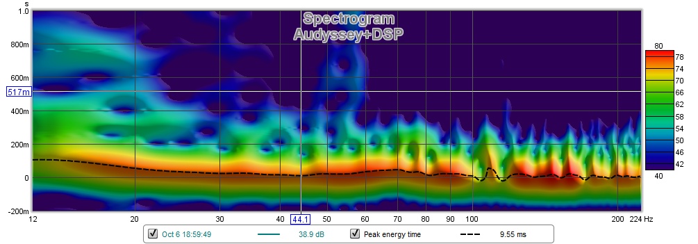

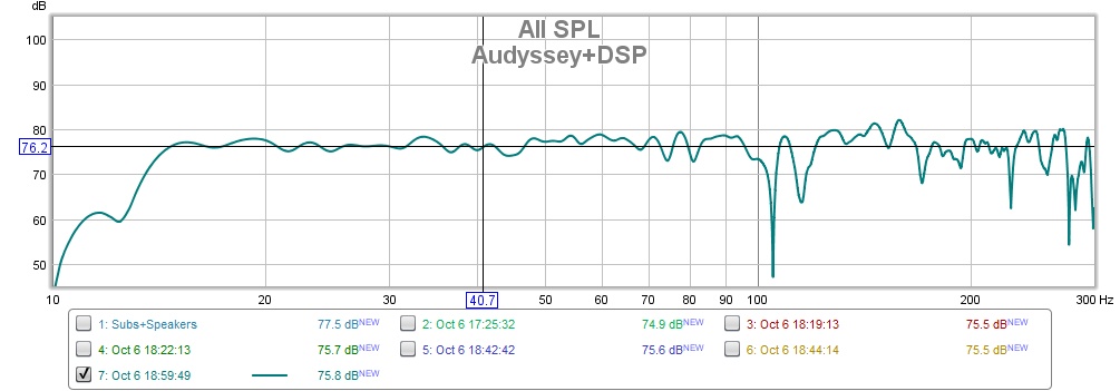

Put some effort into it this afternoon and this is what I have right now.
It's getting a little late so I'm done for the night, but I left my stuff out and plan to hit it in the morning again. I really didn't adjust much manually. This is mostly Audyssey + mini. Straight stereo, no DEQ. No smoothing. Crossover is 120hz. I didn't touch anything above 90hz.
Is it for subwoofers only or with some other speakers? If it is for all channels including subs then we have very similar result and I highly doubt you can do much about the remaining dips. Bumps you can fixed with the mini but not large sharp dips. They are likely narrow enough not to be noticeable but I am going to try acoustics panels anyway, as I can't move any of them any more.

I guess I’ll speak for myself and say “I” can’t hear high rez. 1/6th makes better sense even for waterfalls.
I spoke to SVS about this before and they too, recommend using 1/6 for the FR plots.
That is both towers and both subs. Just how I'd be listening to music.
I'm sitting here looking at my measuring equipment and wondering what more I can do. It sounds freakin' awesome! I think you're right, there pretty much isn't much more I think I could do at this point. I might pull up last night's and apply some smoothing. 1/24 or 1/12 smoothing? I see you guys are talking about even 1/6 smoothing.

From 15-100 Hz, I have yet to see a better looking one. You can try all kinds of things but I highly doubt you can hear the difference. Room treatment may improve the higher frequencies though.

REW generated some heavy filters, but more of them were - than +.

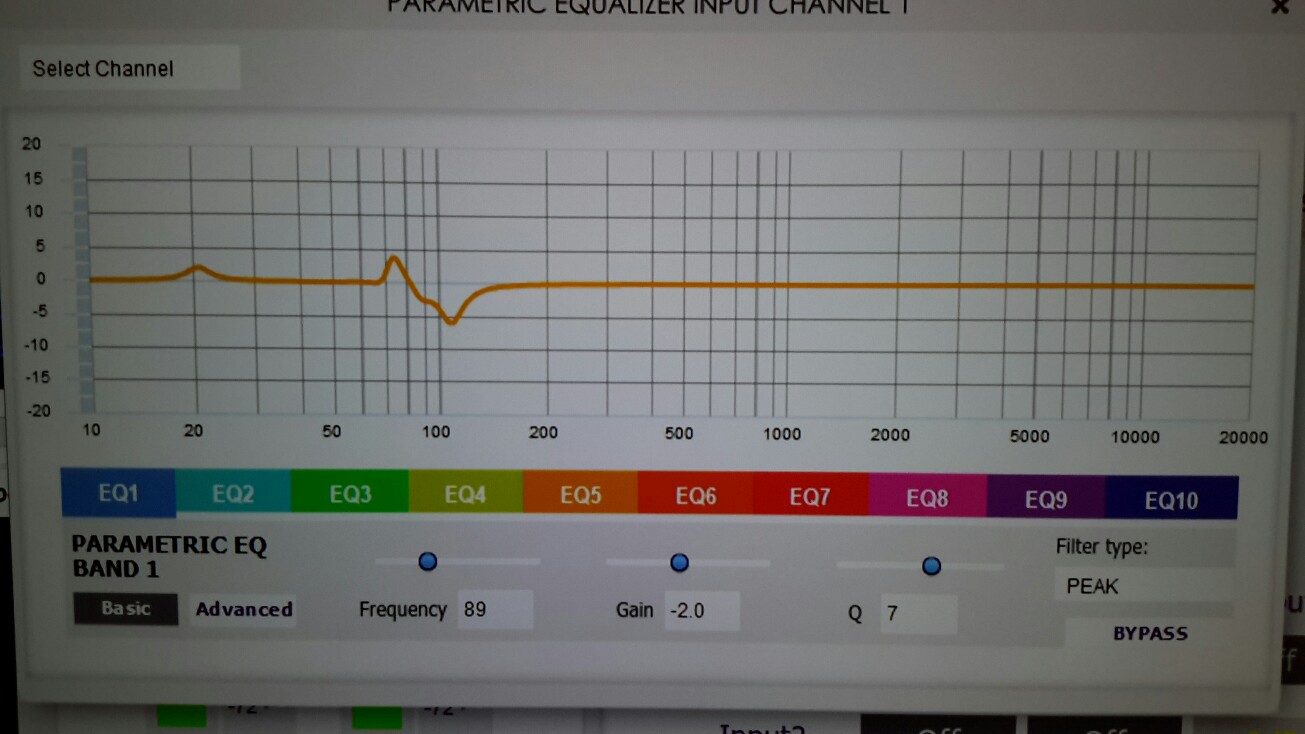

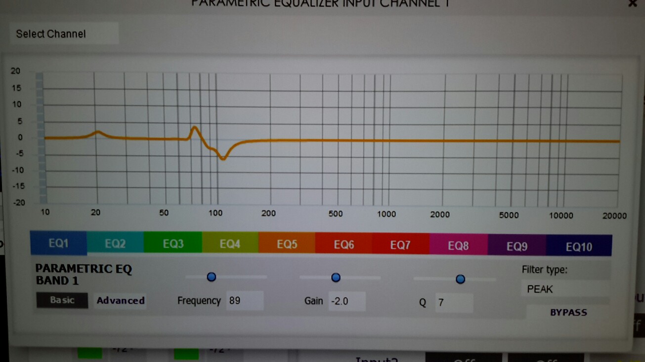

This is what I did at the input channels. I did just a little bit of tweaking manually. Just a couple of frequencies. This was the final touch after running Audyssey.
PENG
After running Audyssey I was able to improve it a little too with minidsp. It is really a matter of bang for the buck, I mean, can you really hear the difference with those very minor tweaks.

I just loaded up last night's adjustments and did 1/12 smoothing. Just now saw your post.
Like I said, I didn't touch anything above 89hz. That big dip at just over 100 bothers me...
I guess I did adjust above 100hz. Turned a peak way down. Maybe I should look at that one again...
