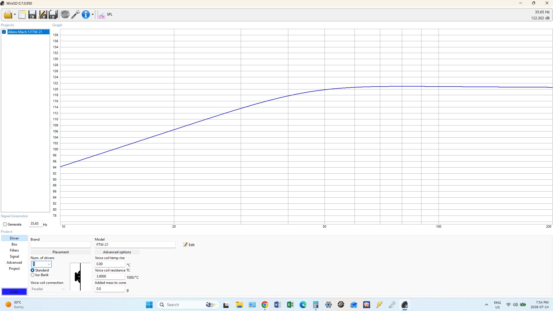

Here is my first attempt at WIN ISD. I put as much information as I had and set the imput at 600 watts, half of what the sub is capable of. I went with a 6.2 cubic foot sealed box. This is a really nice SPL graph on this sub and this is exactly how I was told the sub would perform.
94 DB at 10 HZ
104 DB at 20 HZ
I am not 100% certain I did this properly but I did my best to get it as accurate as I could

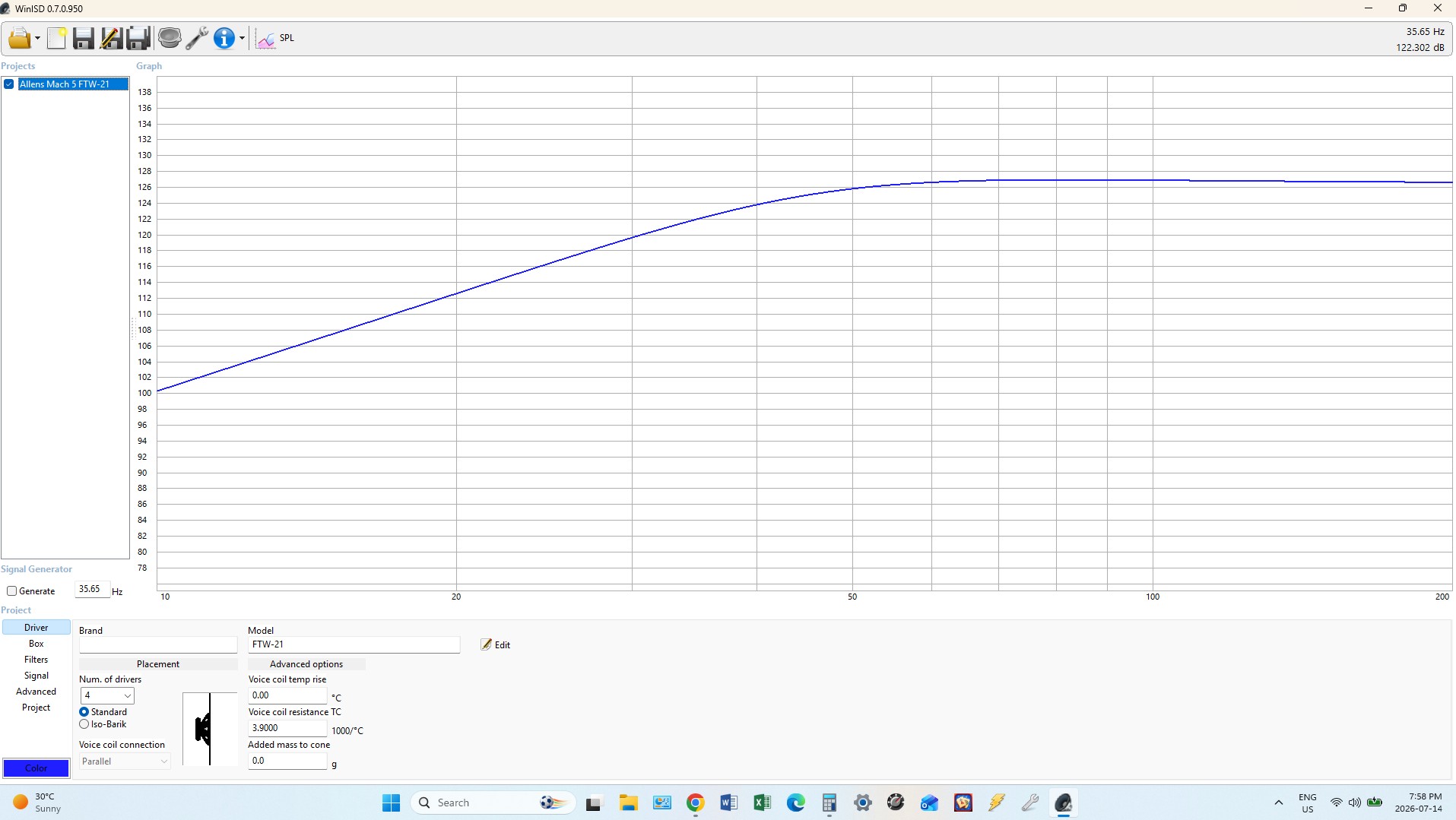

Here is a model with 4 FTW-21 subs. I obviously changed the driver to 4 , but had to multiply the box size by 4 to 25 cubic feet before the numbers looked right. Im not sure if this is the right way to do it but you can see at 100 db of output at 10HZ and 110 DB at 20 hz which is roughly 6 DB of overall increase , which makes total sense having the extra 3 drivers.
Again not sure if I did this right, but this has to be awfully close.

Did you look at the SPL modelling graphs for the 4 subs I posted?
How does it look to you?
Its my first attempt at sub moddeling and, It seems like a tonne of output right from 10 HZ right up to my crossover at 80hz.
This will definitley have more output than my 2 paradigm x12's
