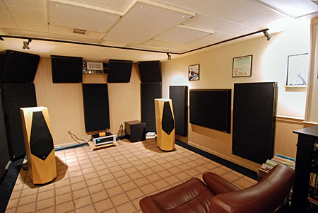

If at all you choose to work on improving the sound, the best bang for buck will be "stealth" room treatments to reduce bass energy dissipation time.
Can you provide more info on that, links etc.?

There wasn't a specific product in mind. "Stealth" room treatment referred to NOT this,
The best I can offer is, to use custom printed art and DIY panels.

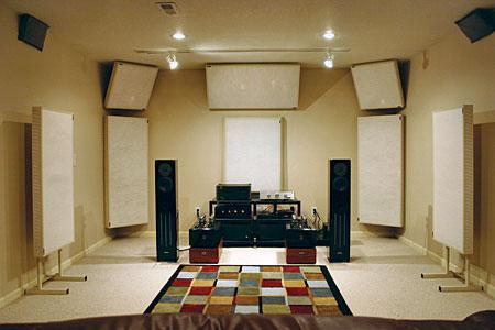

I bought a few ceiling to wall panels from ATS acoustics. I also got a corner trap. This was before I invested in the MiniDSP. Audibly my ears didn’t notice the difference @ the mlp but the dB meter noticed it right off. Behind the white screen is a tall thick ass corner bass trap. Note that you can buy colored panels and/or hide stuff. Pogre your measurements are as good as an anchovies chamber. Or is it anechoic chamber?
