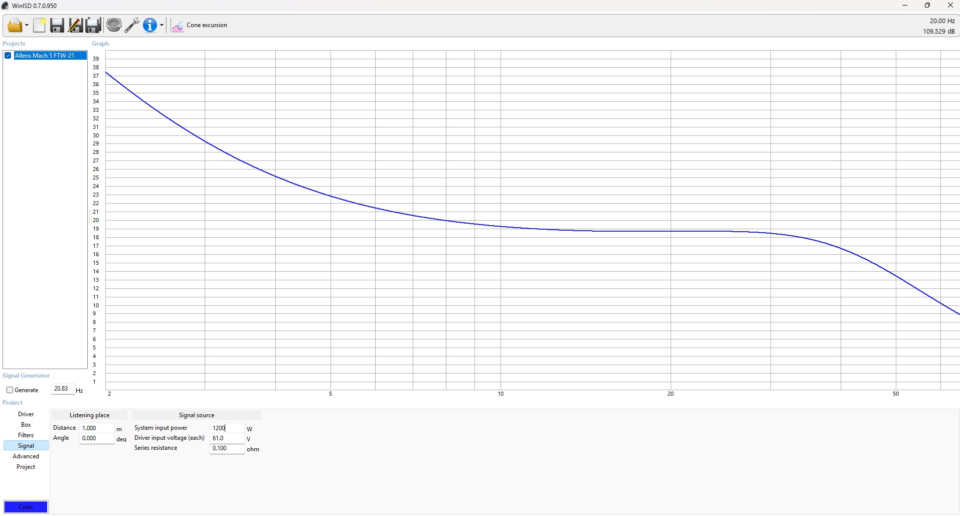

I know it was mentioned about the sub over extending at low frequencies and that I had to be careful where I set my low pass frequency cut off at.
I have been playing with WINISD and have a much better understanding of it.
I have entered in all the MACH 5 FTW-21" driver specs.
The box is sealed at 6.2 cubic feet and I set it at 1200 watts as that is the max I will be putting to eash sub.
I have included the "Cone Excursion" graph and this is the conclusion I have come up with.
I have 23mm of cone travel at 5HZ
I have just over 25mm of cone travel at 4HZ
I have just over 29mm of cone travel at 3HZ
So, I feel it's a pretty safe bet to set my cutoff in my Mini DSP at 5HZ for these subs.
I am also planing on adding poly fill inside the box as well.
I know the poly fill makes the box act like a larger one, but I was wondering if adding poly fill would affect the cone travel(XMAX)?
Im guessing no, but it does not hurt to ask
Anyone care to Chyme in on this?

I appreciate your feedback and experience, but I have a few questions about your findings as they differ significantly from my own modeling.
  • Xmax and Box Volume Discrepancy: The manufacturer's website lists Xmax at 29mm, but your data shows 34mm. Could there be a typo in your parameters? I noticed you modeled this using an 8.2 cubic foot box. My enclosures are 6.6 cubic feet gross; after subtracting 0.4 cubic feet for driver displacement and bracing, the net volume is 6.2 cubic feet. This volume difference somewhat explains why your simulation shows a lower cone excursion than mine.
  • Graph Scale Contradiction: Your cone excursion graph cuts off at 18mm, though it should scale to at least 29mm or 34mm based on your data. Because the graph stops there, it shows 18mm of excursion at 6 Hz, which directly contradicts your claim that the driver runs out of excursion at 15 Hz.
For comparison, I modeled this in WinISD with 1,200 watts of input power and triple-checked the data. My graph shows 19mm of excursion at 20 Hz and 10 Hz, peaking at 23mm at 5 Hz.
Additionally, the designer confirmed this sub can play down to DC (0 Hz). I have also personally verified four of these units playing down to 10 Hz via a calibrated microphone and SPL graph. Given these gaps, I respectfully disagree with your conclusions and would love to figure out why our models don't match.

I got my data from the Canadian importer. The difference in box volume will make a small difference and raise F3 slightly. Box volume does not make such a significant difference as it does with ported designs, where dimensions need to be precise. The smaller box volume will tend to raise F3 a bit.

Anyhow this afternoon I will alter the model for a 6.2 cu.ft box. I will research the xmax further, but that change will make no significant difference.
I have added the model to this thread also for completeness sake.
