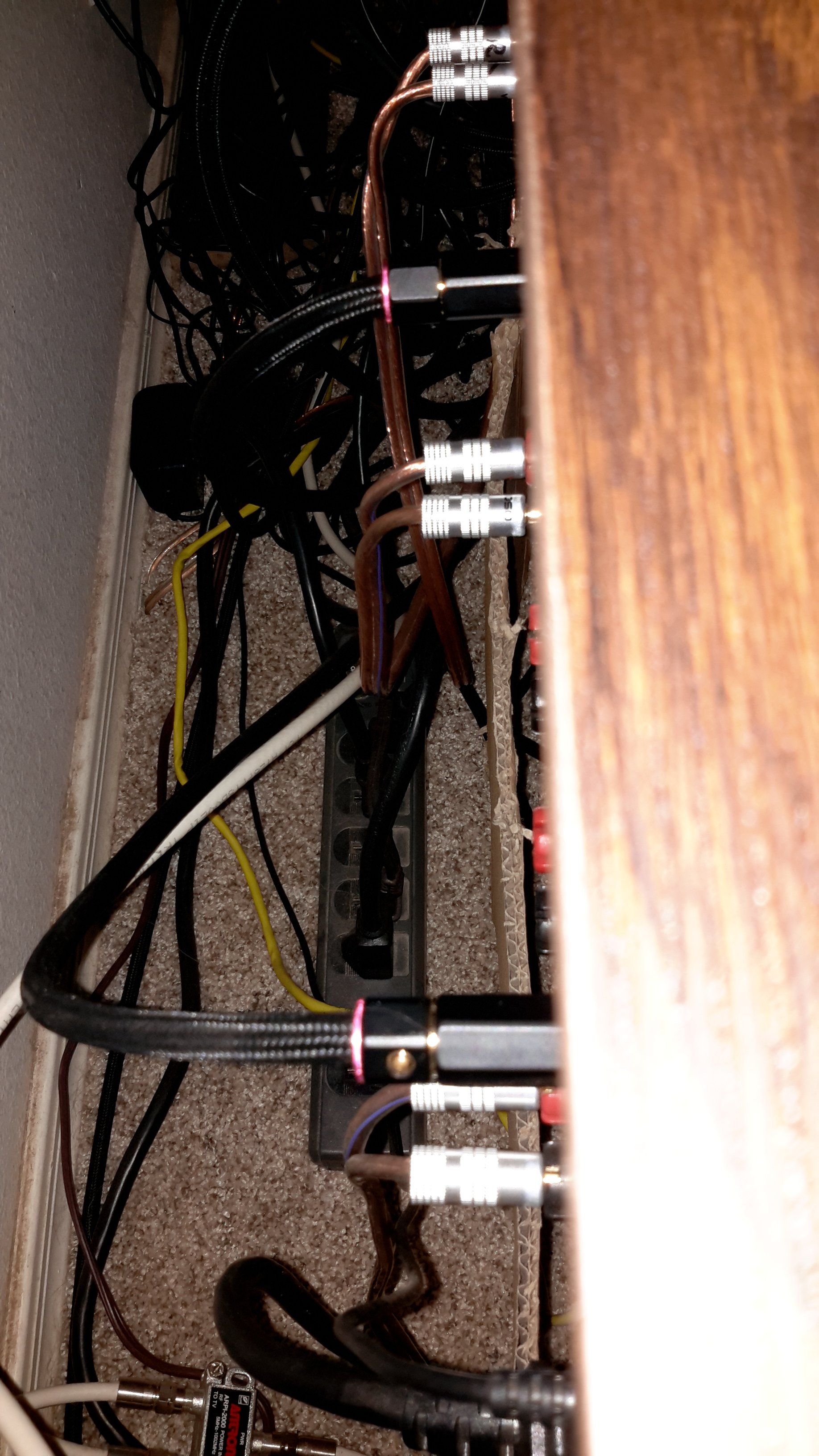

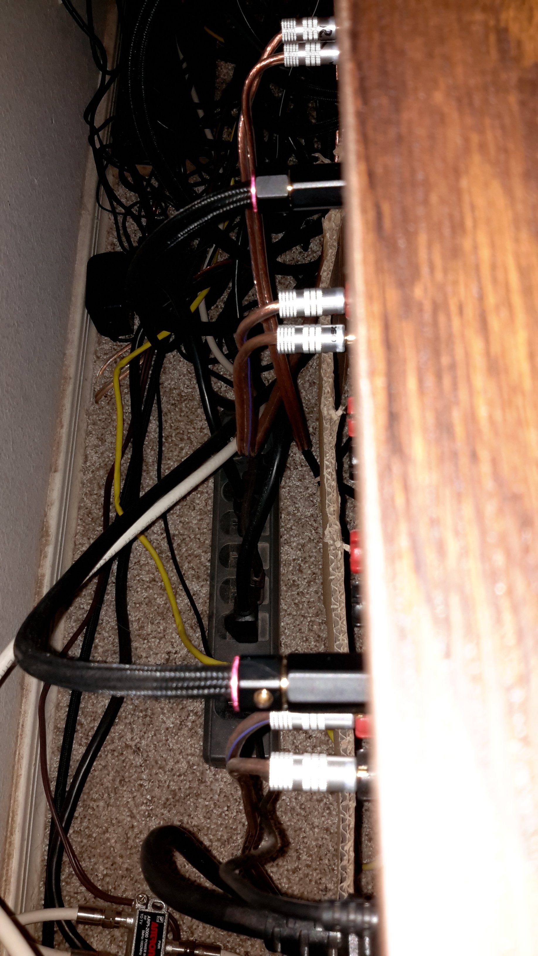

That's what I thought too, so I double checked to be certain. Everything was wired correctly. Red to red, black to black. I didn't expect anything at all. This was very noticeable. Even moreso when I removed the extra cable and put the jumpers back on. This is the first time I tried bi amping them at all. Vocals and instruments were all over the place. Sometimes it sounded like the singer was on both sides of me when he should have been dead center up front.
Weird.
The only way this is happening is the phase on one of those terminals is getting reversed when the jumper is off. Did you check speaker wires too?
Could you recreate this every time the jumper is removed?
Weird indeed.

Well its not the pre-amp, its not the power amp, its not a cable issue, so that leaves some sort of XO mumbo-jumbo as the issue. Bifurcating your towers' internals seems to be the only unknown.
Weird indeed.
Nope. Straight up rookie mistake. I had the wires for the top terminals of the right speaker reversed. :oops:

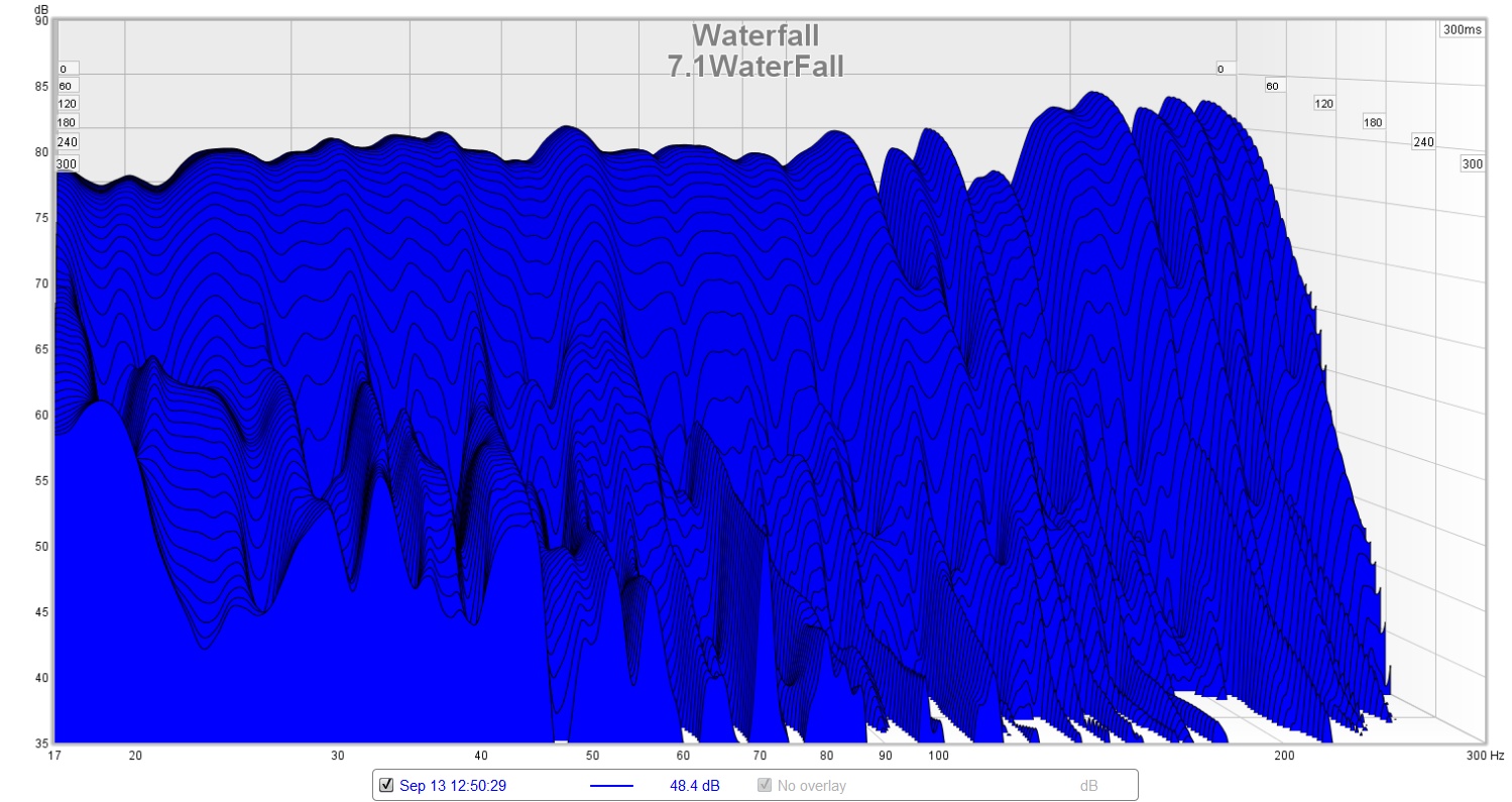

Y'all need to start measuring things one speaker at a time without EQ to get a clear baseline.
Then EQ plots for each channel.
Finally, channel+sub plots.
A 7.1 waterfall is practically useless.

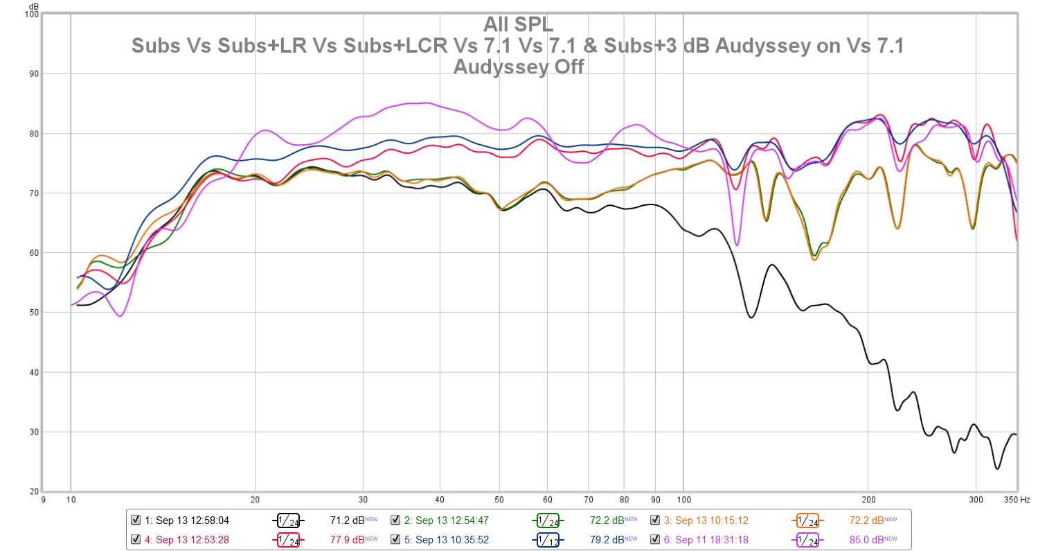

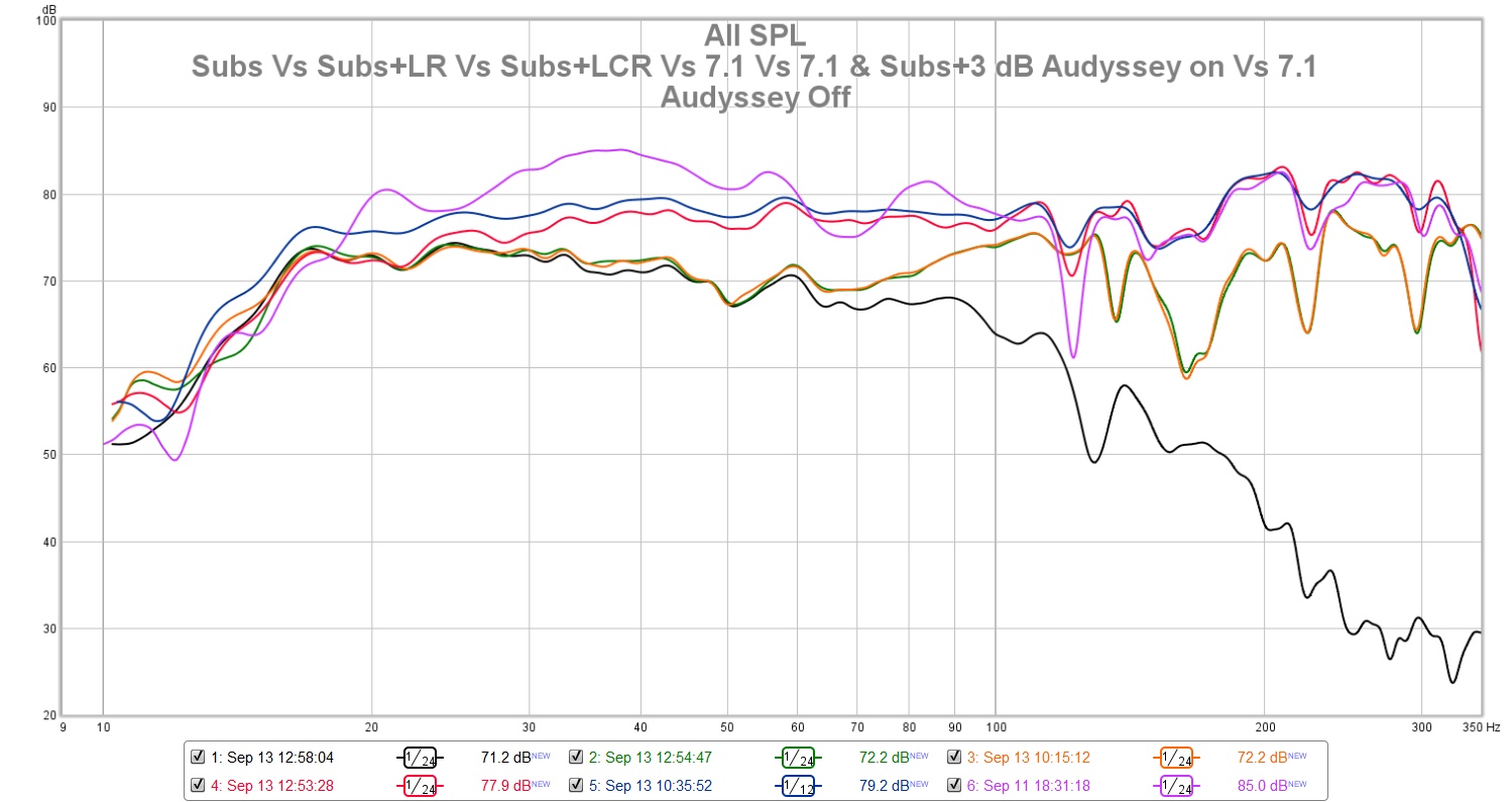

I know, that's why I included the one with Audyssey off. I also did L, R, L+R, C, Sub1, Sub2 as well, I can post them all, but I already know the best looking one appears to be the 7.1 with Audyssey on. You can see why in my case I am quite please with Audyssey. It left something on the table, but if that's all I can have, I am fine with it though that won't stop me from keep trying. Trying different things to improve on something already decent is just as fun.
By the way, thank you for the feedback but at least for the moment I disagree with you that 7.1 plots are useless. To me, 7.1 plots are very useful because it tells me how all the speakers and subs would play together. I don't listen to 7ch stereo but do have quite a few 7.1 movies. You can have a straight line Stereo plot, but your 7Ch plot may not look good.
I plotted the individual speaker and subs only for information and analysis purposes so I may have an idea what to do for manual adjustments.
This is why I calibrate the sub alone with REW. After that, I find the best place for the towers, measured alone, no sub. Then I let Audyssey take it from there. After that, that’s when I do some sweeps with LR, and C with subs, fine tuning distances, and tweaking a filter here and there for best results.

Yes, but you, and probably agarwalro too, seems to be talking about calibration, I am not. I plotted those graphs after calibration, just to see how all the speakers/subs play together. I thought we are sharing the results there, hoping that someone may be able to recognize potential issues and room to improve, then we could be talking about calibration again. So I guess we are not in disagreement, right? Again, I could post all the other plots for individual speaker and you will see that after calibration, the 7.1 one appears to look the best, in just in response, but waterfalls as well.

I couldn't find the ones for the surround and surround back speakers/subs with Audyssey off. They were plotted back in 2014. Below are the L,R,C,Front Sub1, Sub2 that I could find. Black and Red are the FL,FR, green is center, blue and yellow are the subs.
To show the phase, impulse and waterfalls, I would have to post each individually.

My issue with the 7.1 is that audio aberrations with one speaker will be masked by another. The only insight I could draw is speakers vs sub(s) level match.
I don't understand what you mean by "how well they play together" and what it would correspond with on the 7.1 waterfall plot.

I meant whether there are cancellations and boosts, i.e. the overall frequency response. We all know XOs are not brick walls so the speakers/subs do overlap and interact with each other. I understand your point about the audio aberrations thing that is obvious too, but it is what it is, you can't ignore the effects. I guess we will agree to disagree on this point.
As for waterfalls, i only look for the decay time while trying to find out how else I can make use of them.
PENG
After optimizing L (for example) and Sub individually you'd measure L+Sub to ensure optimal coupling at crossover.
I tried so many things back pre audyssey so I might have tried that one too.:D Honestly though, there are so many things to play with by measuring, manual adjusting, with and without REW and minidsp that while continue to play around, I really have to give Audyssey the credit for doing a good enough job so quickly. The after Audyssey calibration REW plots look good, the system sounds good, all for 30 minutes of work. Again, that buys me all the time I need to play outside of Audyssey.
So are you suggesting that the waterfall graphs generated by REW are useless, or somewhat useful, and how?

What's your noise floor?
Could you repost the 7.1 with lower limit same as Subs only?
I am not sure about my noise floor but from the REW plots I think it is probably around 25 to 30 dB.
Below are the REW plots for different combinations of channels from 10 Hz to 300 Hz, hopefully that's what you meant by "with lower limit same as Subs only".. My subs really don't have much below 15 Hz.
That’s very low, usually 40+
