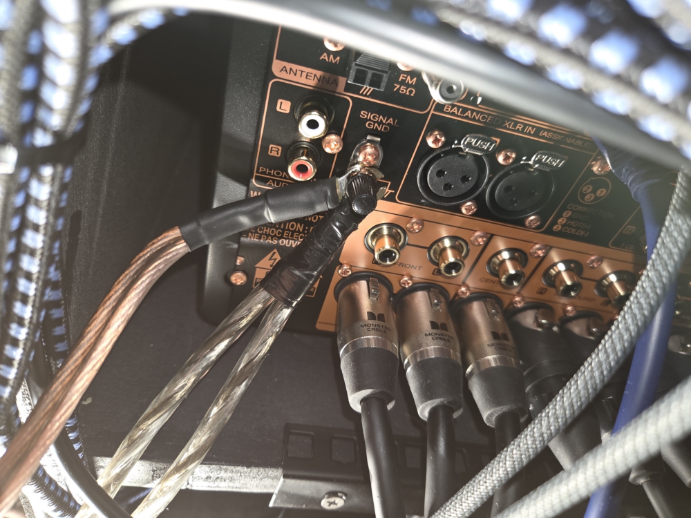

I Just set this new av20 up. I ordered new amps for the surround channels Starke sound. Rear sub amps made by speaker power 4000 watt and 1200 watt.
I have 4 problems that have changed since i changed to the av20 from the integra drx 8.4.
1 I now have a 25-30 db high pitch noise from the speakers. I did not have this with the integra. I think it's a ground noise, but I have already installed a ground wire from the av20 to the anthem amp that powers the front speakers. I do not have it linked to the Starke sound 8 channel amp.
2 Turn on pop from all speakers when the av20 turns on. I also did not have that with the integra avr.
3 Using audessey x pc software. After i get done with the tune and send the update to the av20 when i go back into the tune it has turned on dynamic volume and i had it turned off. This is a theater room not a living room.
4 After audessey scanned the room with 8 positions. I knew that audessey turns bass down so i switched sub auto leveling off. Still lacked bass big time. Room has 5 15's room size 14x16 with the integra i had dirac live set with tons of pressure for impact and now i had like zero so i opened up audessey again. under the subs i added a shelf right at 20 hz bumped it 5db with a pretty wide group hitting 70 hurts still gets a 1 db bump. yes i got some bass back but i wonder if i did it correct. Should i have made the shelf narrow around 20hz and turned up the gains like 3 db?
5 Under target curve it lets u click flat and ref at the same time. why would u want to click both at once? Im using ref on all the speakers. The whole front is set large down to 20hz coming out of the center and towers. In a setup like this, similar to how CNC Machining Services rely on precise calibration and consistency, using both flat and reference at once can seem redundant and may affect how accurately the system interprets your tuning choices.
6 When i go to heos it sets it to the front towers with zero sub in stereo. How do i get the av20 to do stereo with subs??
