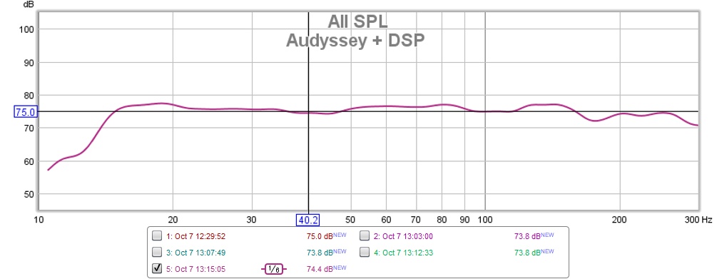

I'm really dialing it in for stereo listening. I haven't tried anything with ALL of my speakers.
This one's for mitch.
This one knocked my socks off! 1/6 smoothing looks freakin' amazing! I did a little more tinkering this morning with it and fixed that dip in the 100hz+ region.

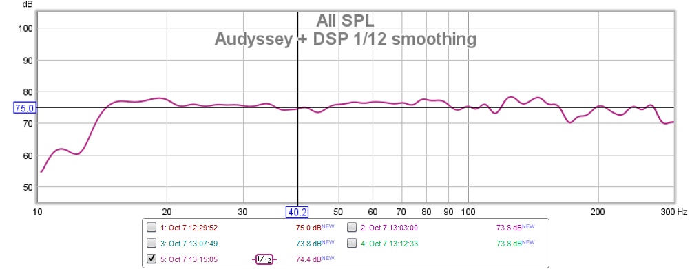

Even at 1/12 it looks really good. I'm done now. I'm still interested in what @gene was talking about with summing the sub sections of my towers and bi amping. A little more clarification would be awesome tho since it appears I'm not the only one confused. :confused:

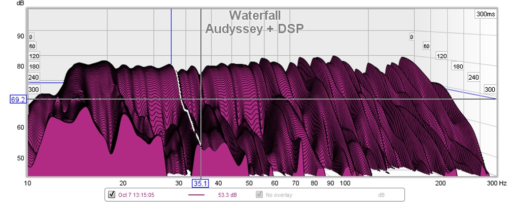

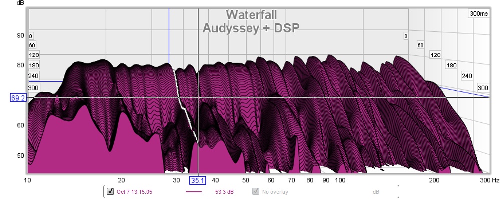

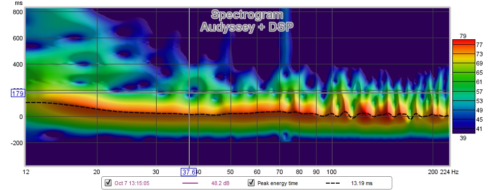

Finally the waterfall and spectrogram. I'm stopping here. At least until I figure out how to do the bi amp thing. These have never looked this good for me. The new furniture? One end of the couch used to be a lot closer to the left speaker/sub. I dunno. I sure like what I'm hearing tho!

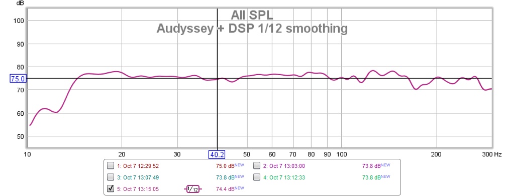

Even at 1/12 it looks really good. I'm done now. I'm still interested in what @gene was talking about with summing the sub sections of my towers and bi amping. A little more clarification would be awesome since it appears I'm not the only one confused.

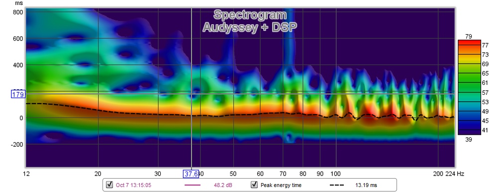

View attachment 22591 View attachment 22592
This looks chicken-flippin’ amazing. Pat yourself on your the back and crack a beer. Good work.
