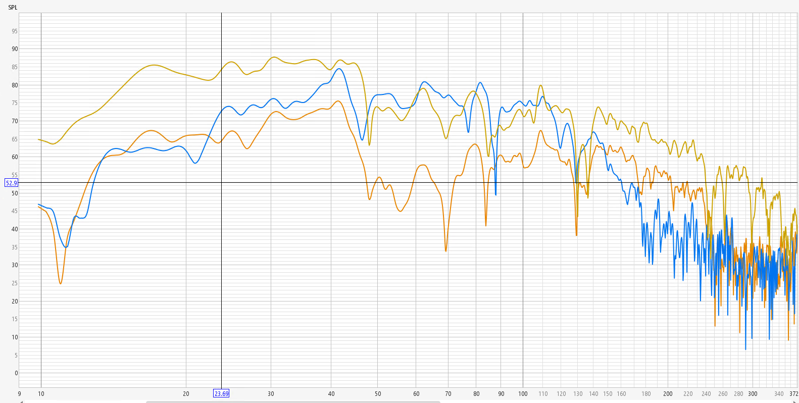

For those curious here is what Audyssey (default, no app modifications, yellow) and Art (about 6db boost in base, blue) and pure direct (orange) gives. This is with no smoothing measured at the prime location, with Art run with "focused" because I was too lazy to take enough measurements for really wide.
I think it shows that my impression that Audyssey had more "boomy" base is merited (the yellow).

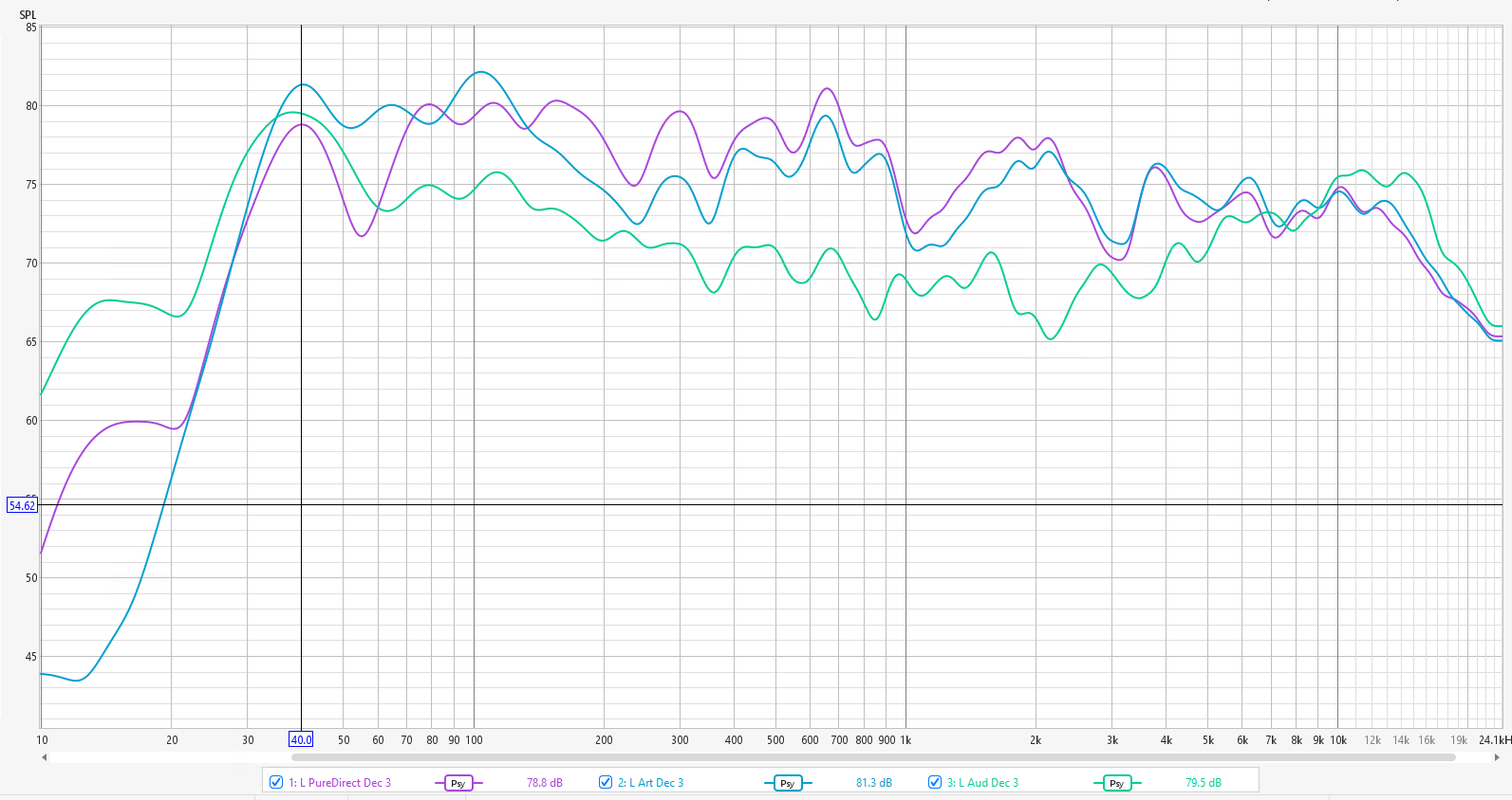

Here's the left speaker (smoothed with the psychoacoustic). I think this is also going to be kind of loud base, as the lower audyssey level in the mid range will head one to up the volume.
I tried to make sense of some of the decay measurements without any success, it looked like pure direct was dramatically better than either, but maybe I am reading them wrongly.
