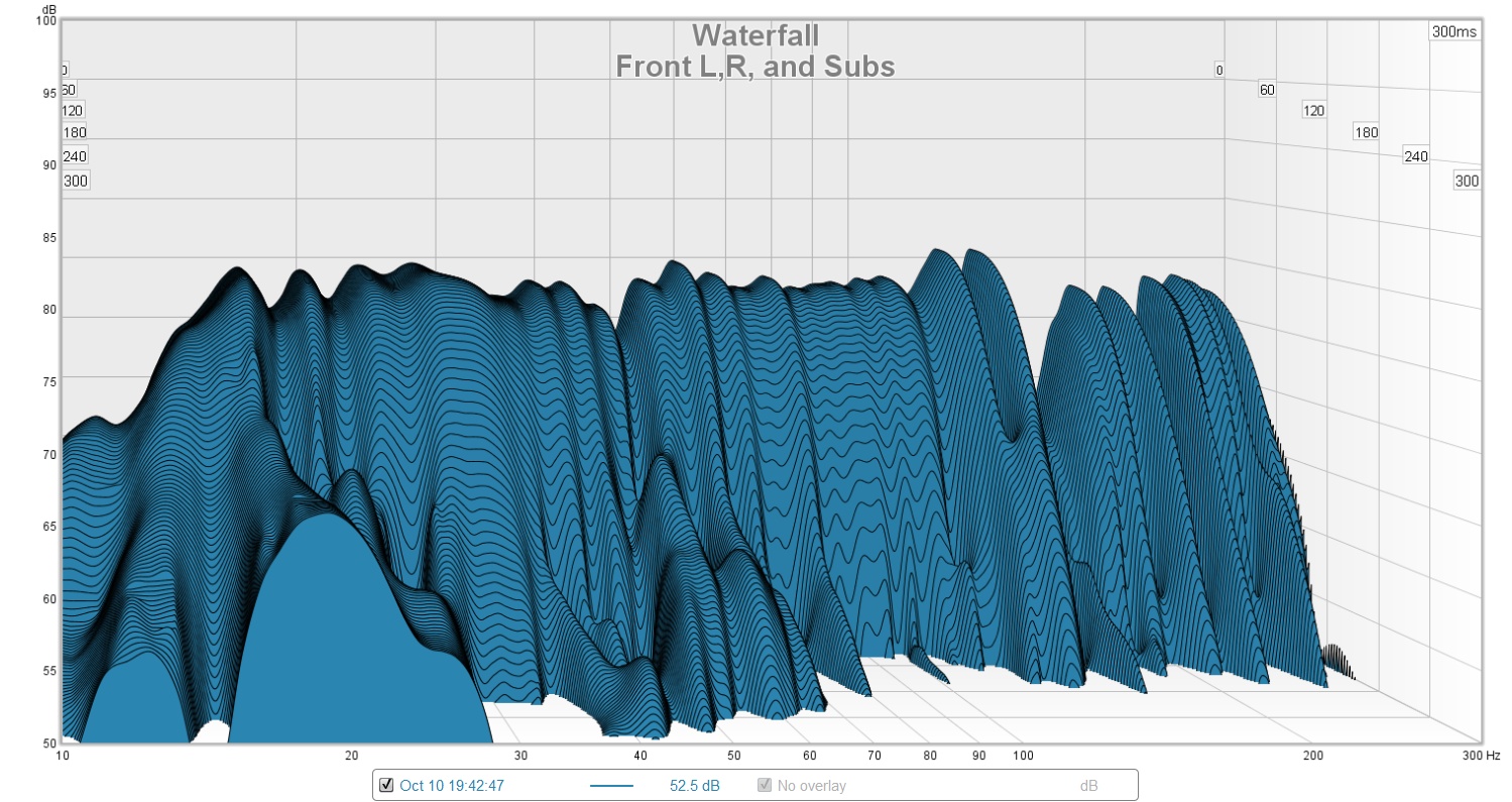

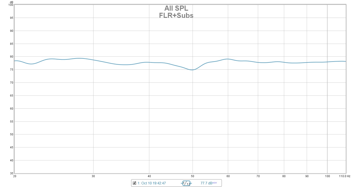

Honestly, it didn't bother my ears but it bothers my eyes, thanks to REW.:D

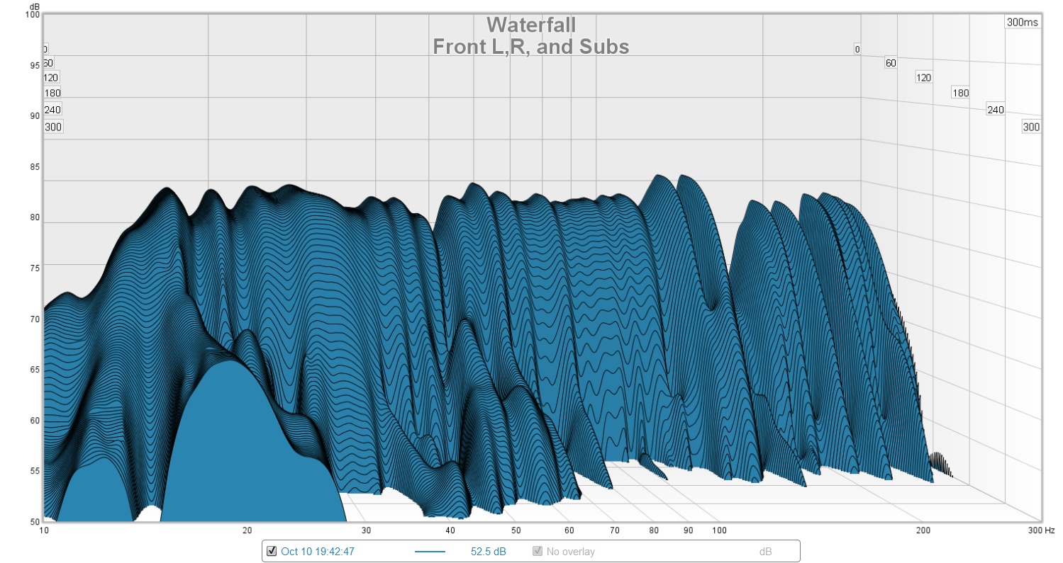

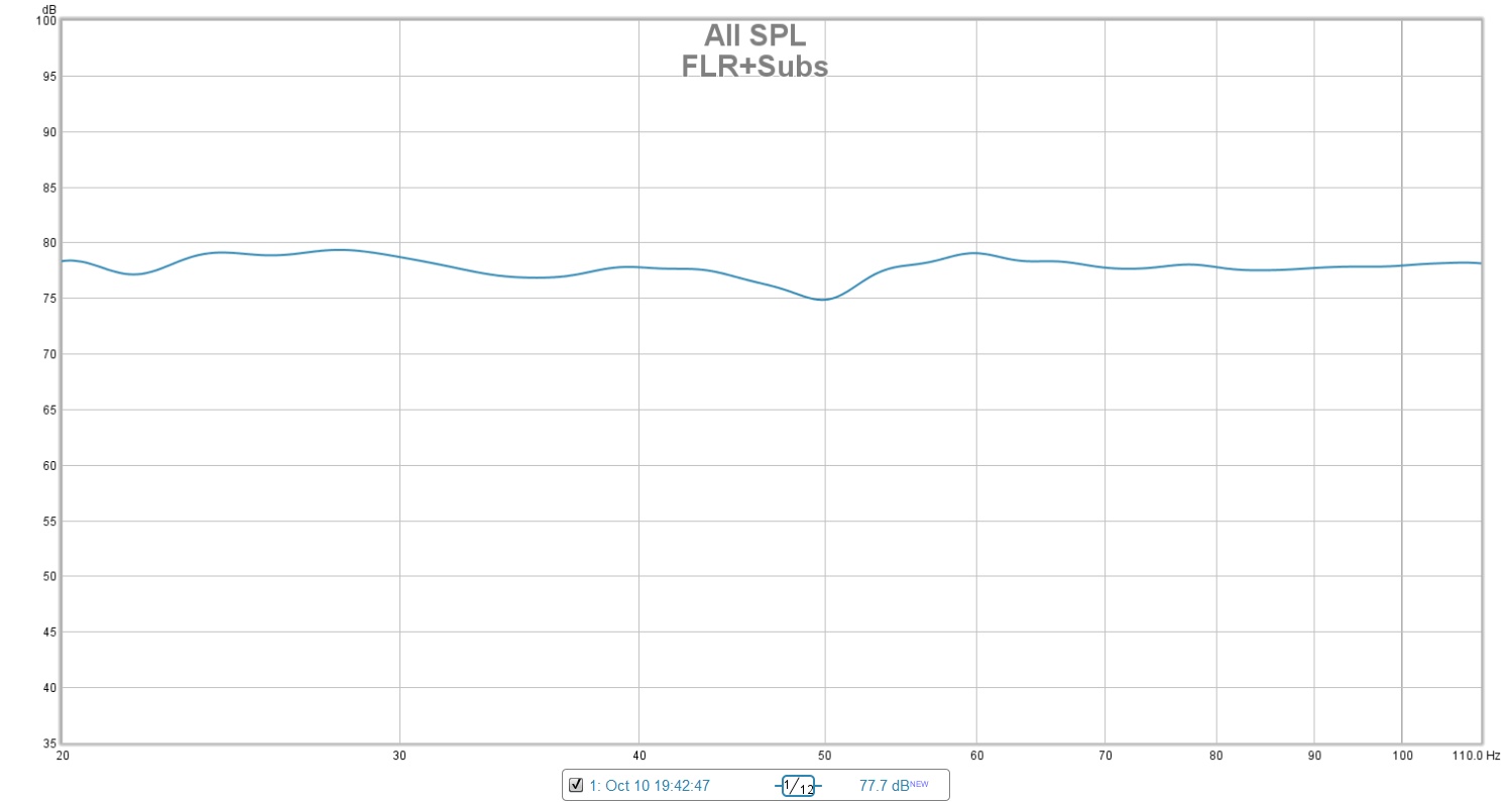

Anyway, I have some time on my hand so I spent a few hours manually tuning the two subs using the phase knobs and the PEQs. Adjusting the phase had no effect on the 50 Hz dip, but the PEQs did get me the last 1.5 dB. So the final graphs no longer bother me as much now.
That looks great Peng!
PENG
Thanks, almost as good as yours now but not quite. I am definitely going to spend lots of time watching movies this weekend, after all the hard work.

Peng, that waterfall plot looks very good (IMO, better than Pogre in the time domain). There's some running at 15-30Hz. You'll most likely need targeted room treatments for it.
What's going on at 150-200Hz at t=0? Looks like a big suck out.
Thanks again for your support, and I will be searching for treatment solution as I don't like the idea of using brute force. Audyssey supposedly set a limit on boost, 6 dB maximum, now I applied another 3 dB using the Sub's PEQ, and the 50 Hz dip is still at least 2 dB down. The suck out you noticed is a problem that I hope room treatment can improve. There are worse ones higher up but at least those are very narrow dips.
When I have time later on this week I will plot and post some graphs so you can get more info of the suck out area and maybe you can suggest some quick fix. I don't expect a total fix, but any improvements at all would be nice. Oh, by the way, the suck out probably look several dB worse because I increased the subs level and forgot to lower it before doing those sweeps.
