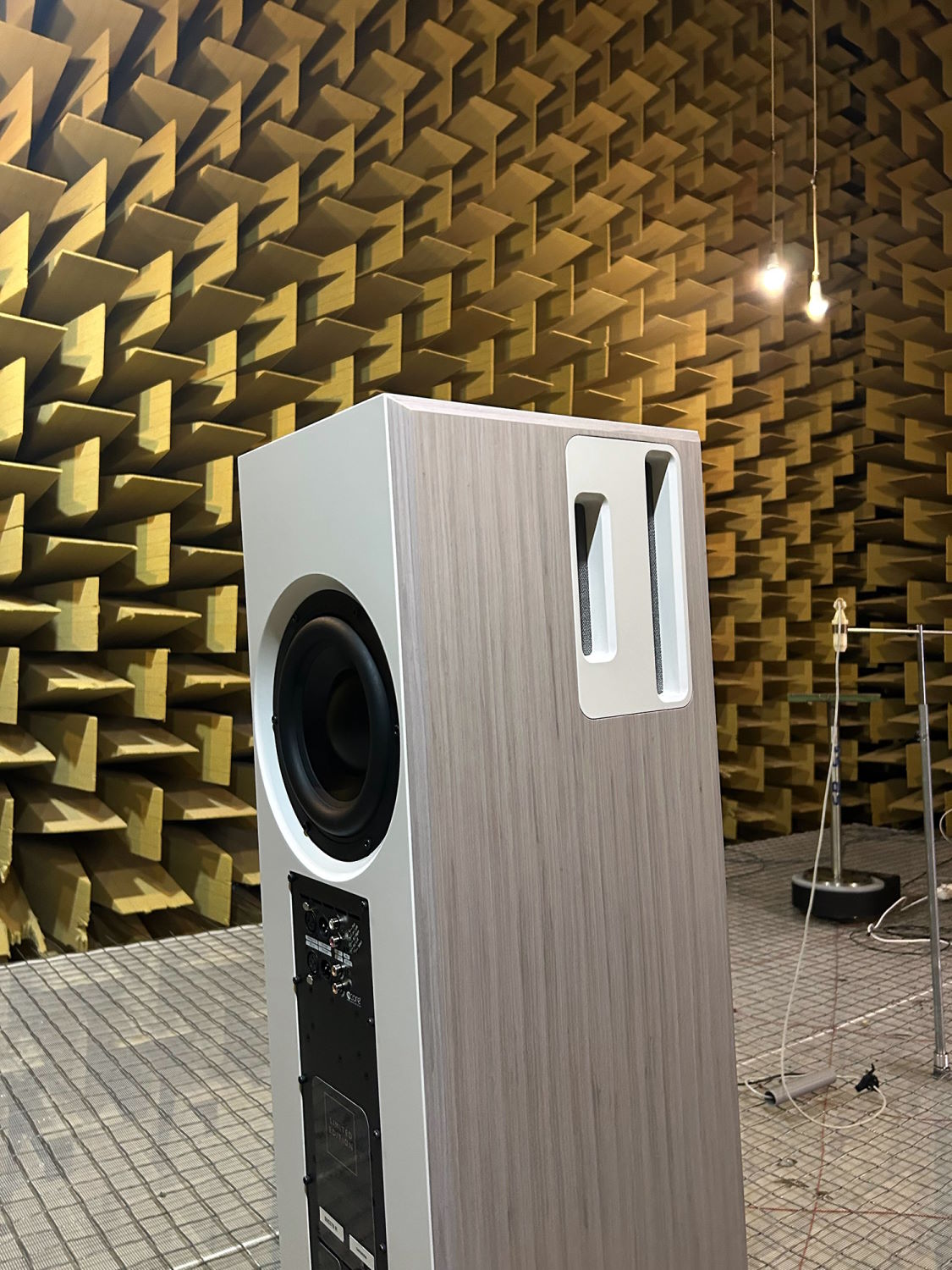

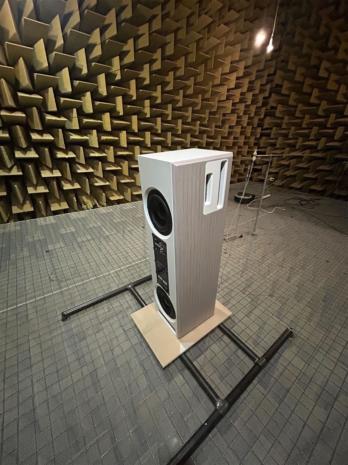

Turned out the simulation/compensation in the bass was a bit rushed, having looked at earlier measurements of the prototype that had the bass drivers in the front + some outside groundplane measurements, I think this is more realistic:
Unaltered groundplane measurement for reference:
Some pics from the session in the anechoic chamber:
View attachment 73781View attachment 73782View attachment 73783View attachment 73784
