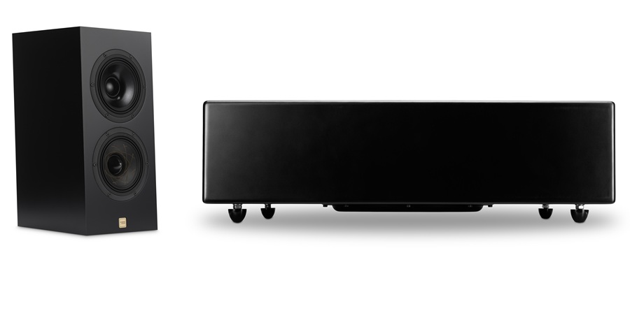

Directly to your concern:
Our speakers are not likely to fail prematurely, we have taken great care to monitor temperature / cooling etc. But in that unlikely case, they are fully serviceable.
Both drivers and amps can be replaced by basically anyone who can hold a screwdriver. I would happily trust my 8 year old to do it. :) We have a five year warranty and we promise to stock spare parts for a decade. We use the best amps we could possibly find.
The speakers are also not designed to be a one stop shop, they're speakers with digital filters and power amps. You still need preamp and a source. This means there's not really any tech inside that grows obsolete or stops working. No app or streaming functionality that are no longer updated.
You can connect your preamp or streamer to the speakers via xlr / rca / optical / coax and you're up and running. This will still work perfectly fine 20 years from now. :)

The article is not intended to be groundbreaking. It is intended to help our customers set up our speakers so they can get a good starting point for good sound, in the case that they don't have the knowledge to do so already. :)
That so many don't appreciate how important speaker placement, be it spacing location to rear and side walls, etc. is apparent by the many photos of systems on line I visit, especially FB audio groups. Very common to see people having spent serious $ on a system only to have speakers placed poorly. No doubt forums like this help people not do that, and get the most from their gear. Many (most?) of us have limitations on placement to deal with and have to work at optimizing the space we have to work with.

It's even smaller in person than I'd expected.
Just to be clear, the 122dB figure is from the Manta. The max spl for sbs is 116dB, which is still very loud.
I can't from the top of my mind think of any similarly sized speaker that comes close.
