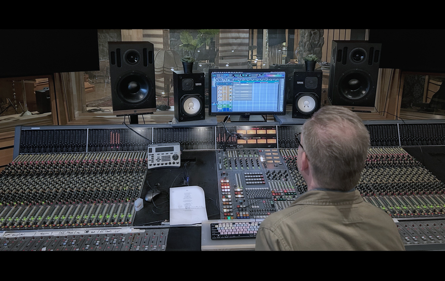

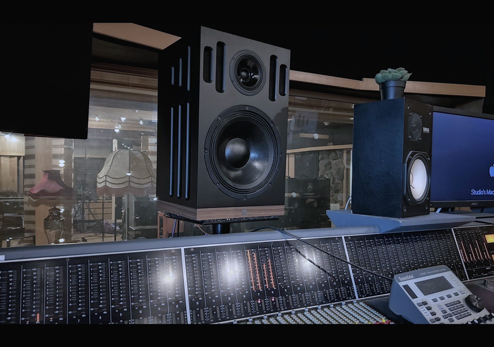

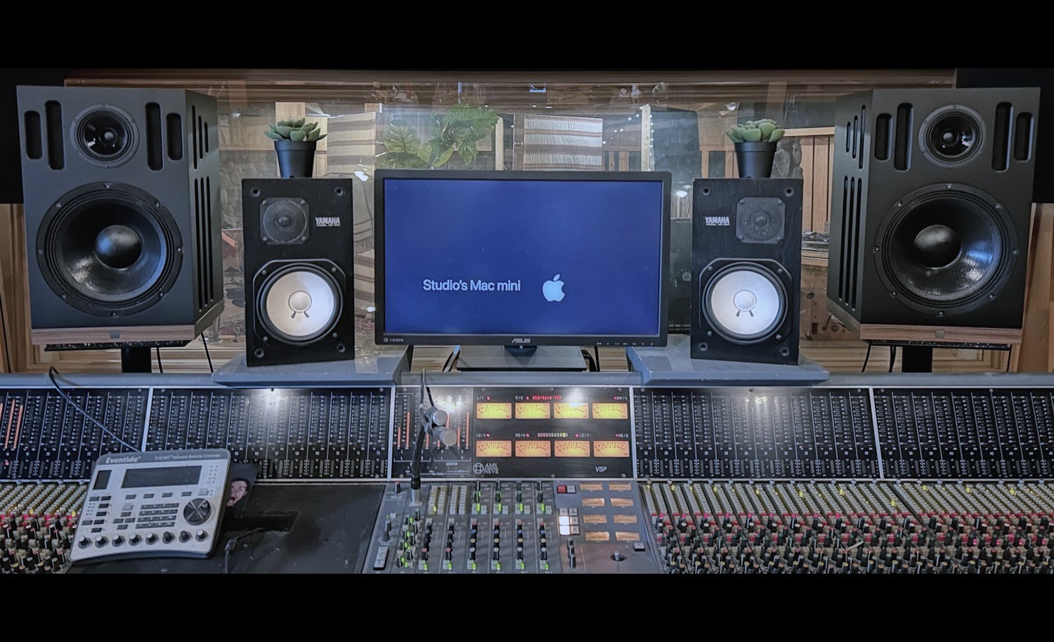

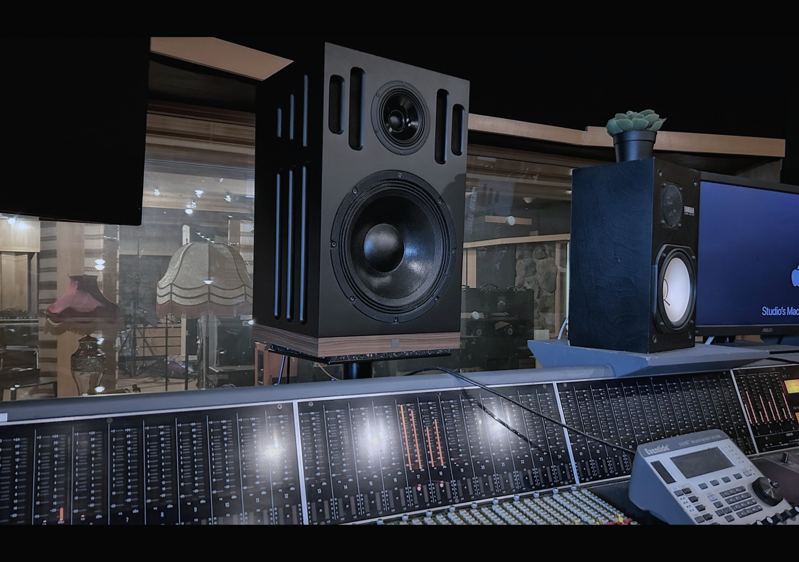

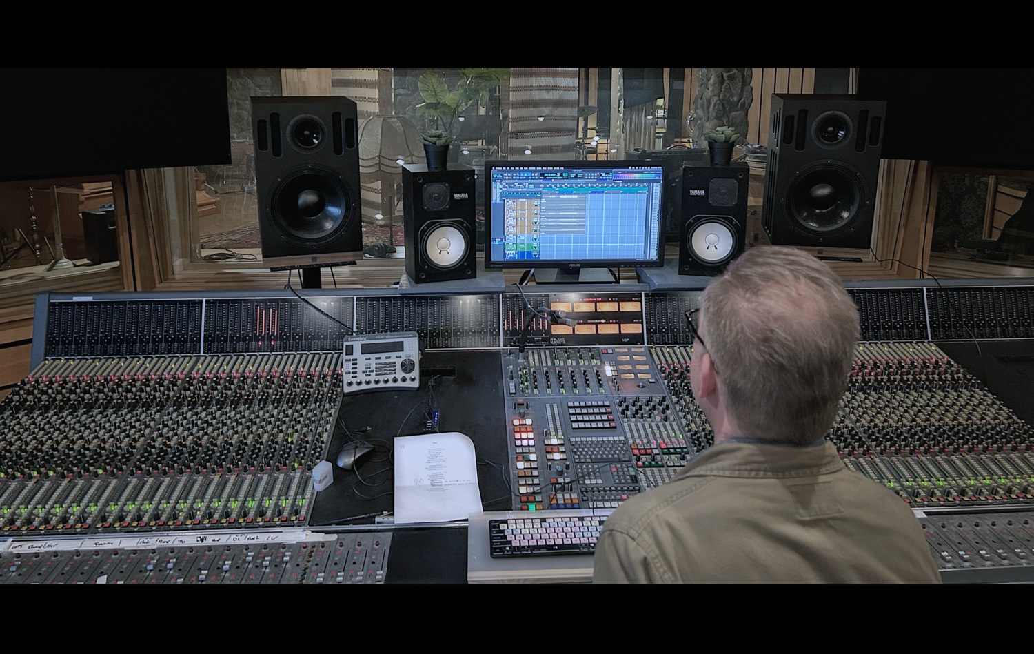

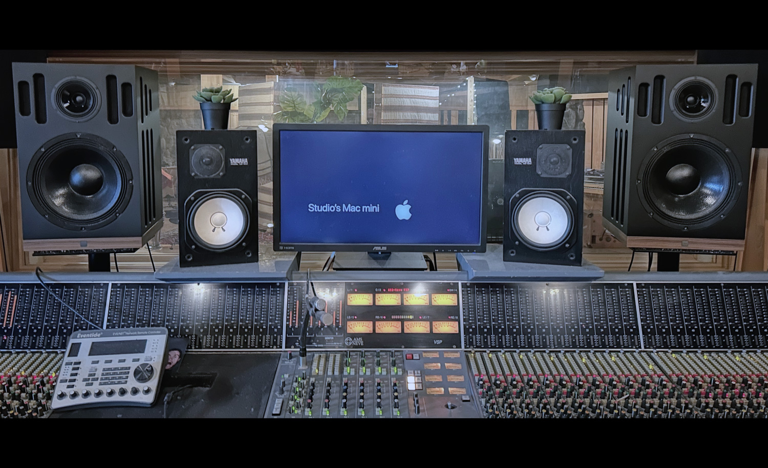

Today a pair of Manta monitors and dual 10D subwoofers moved into a large recording, mixing and mastering studio close to Oslo, Norway, where they will be setup in the recording studio and be part of a studio project for the next couple of months! :D
The engineers immediately commented on the bass extension, midbass tightness and overall sound quality ("This sounds so good it's nuts!"). They were also fascinated by the even dispersion across both the entire mixing area and the rest of the room (lounge area where the band and others hang back to listen to the recording). It will be interesting to follow the recording process and how the Mantas perform as tools in their daily work!
View attachment 61166View attachment 61167View attachment 61168
They look really good. I have never been more curious to hear a speaker other than those.

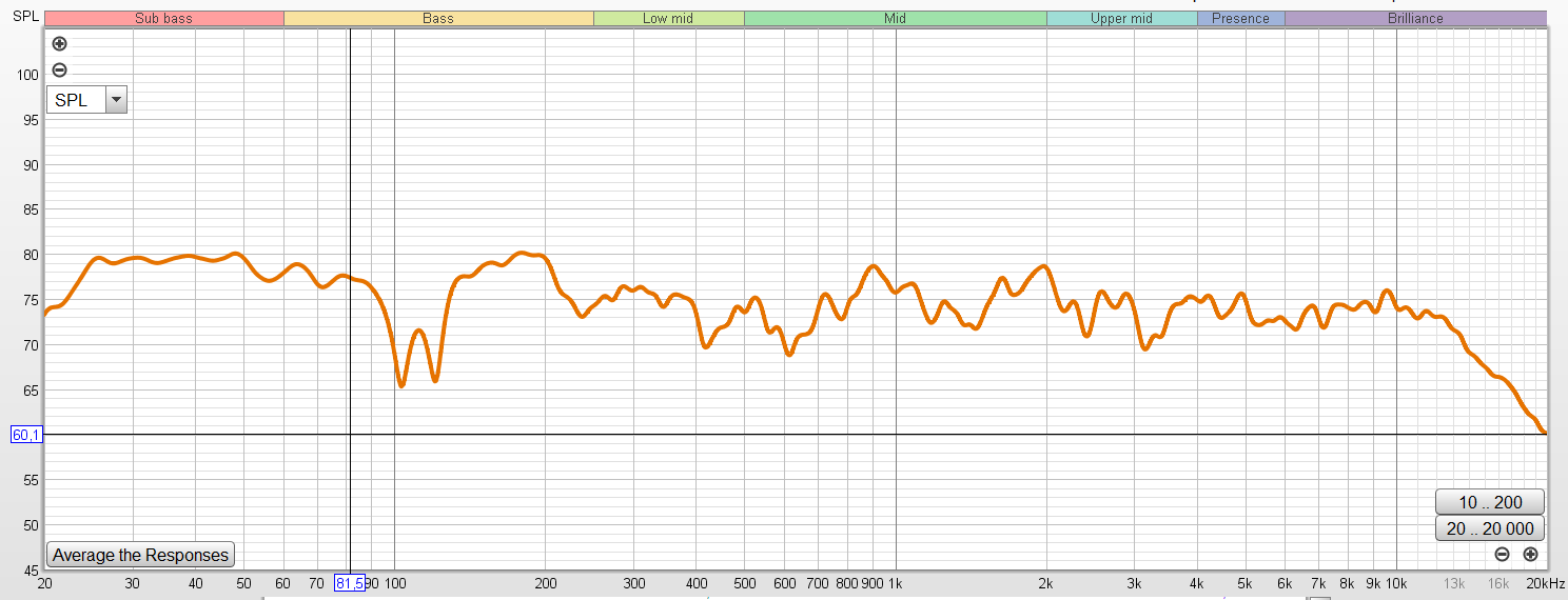

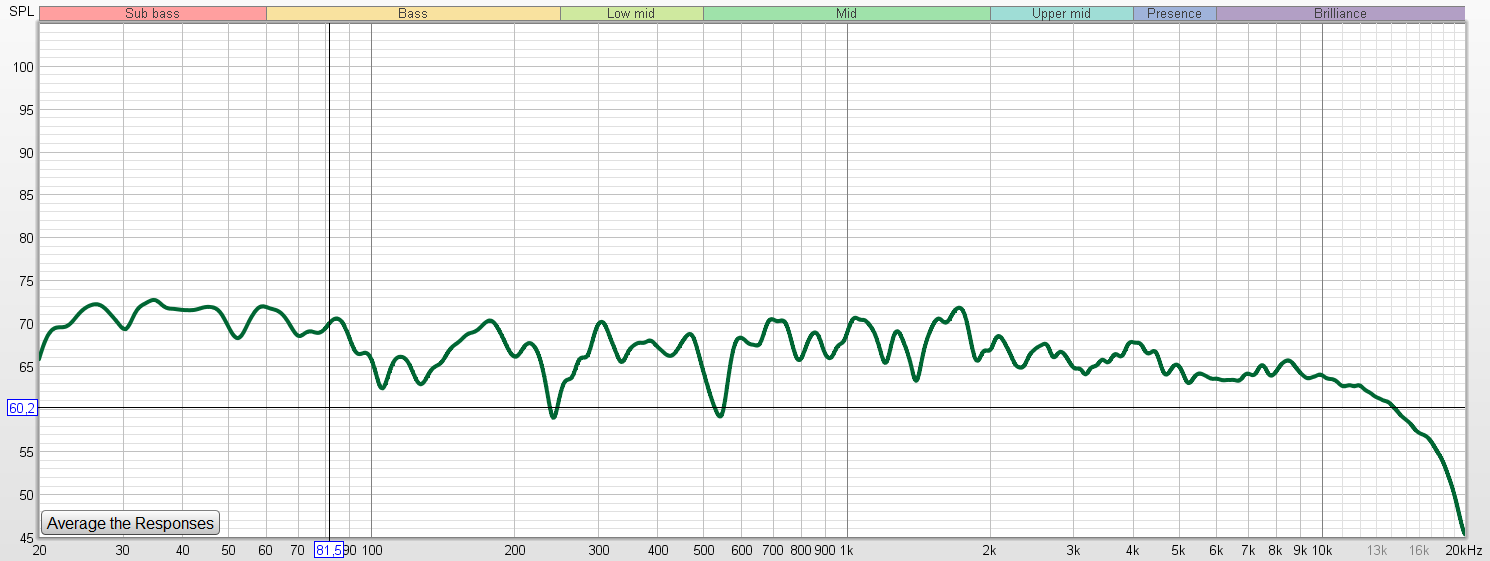

It looks like Manta is pretty room friendly / adaptable to different situations (which is some of the point with the cardioid technology as well).
Here are responses (left+right average) of a pair of Mantas + dual 10Ds in two very different rooms. I think it's interesting how tidy and relatively similar this looks. Note that none of these setups have any EQ applied above 100hz.
First one is around 18m^2, low ceiling, system set up on the longest wall, slightly assymmetrically (my dedicated listening space), moderately damped with acoustic treatment:
Second is same setup (Manta + dual 10D) in a professional studio in their recording / mixing studio (the control room for the actual recording studio where the band records the music). The room is relatively large (around 35m^2), normal ceiling height, almost square form. Also moderately damped with acoustic treatment. The system is set up symmetrically in the middle of the wall separating the control room with the actual recording room. The dip around 100-120hz is suspected to be due to the cavity behind/under the mixing console, need to work more on subwoofer placement to fix that.
Both setups both sound very good and also quite similar. :)

No doubt the Pot plants helped with the stabilization of the speaker cabinets
I see your not going to exhibit your speakers at Munich this year, instead you continue to promote the product on a low end home theatre forum.
It's not my studio, so the owner is free to decorate it as he see fit.
Promoting it here is one of many things we do. I didn't sit down in a chair, and go "Hm, should I go to Munich, or should I start a thread on Audioholics. It has to be either or."
Not sure where you're going with this. :)

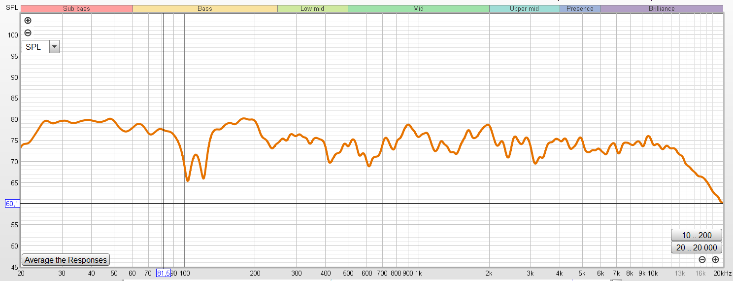

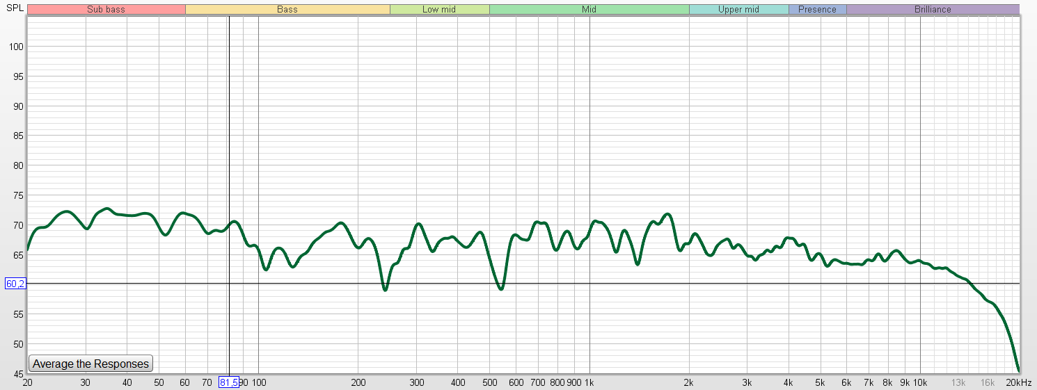

That looks very good. I suspect that null in the lower trace is reflections out of phase.
