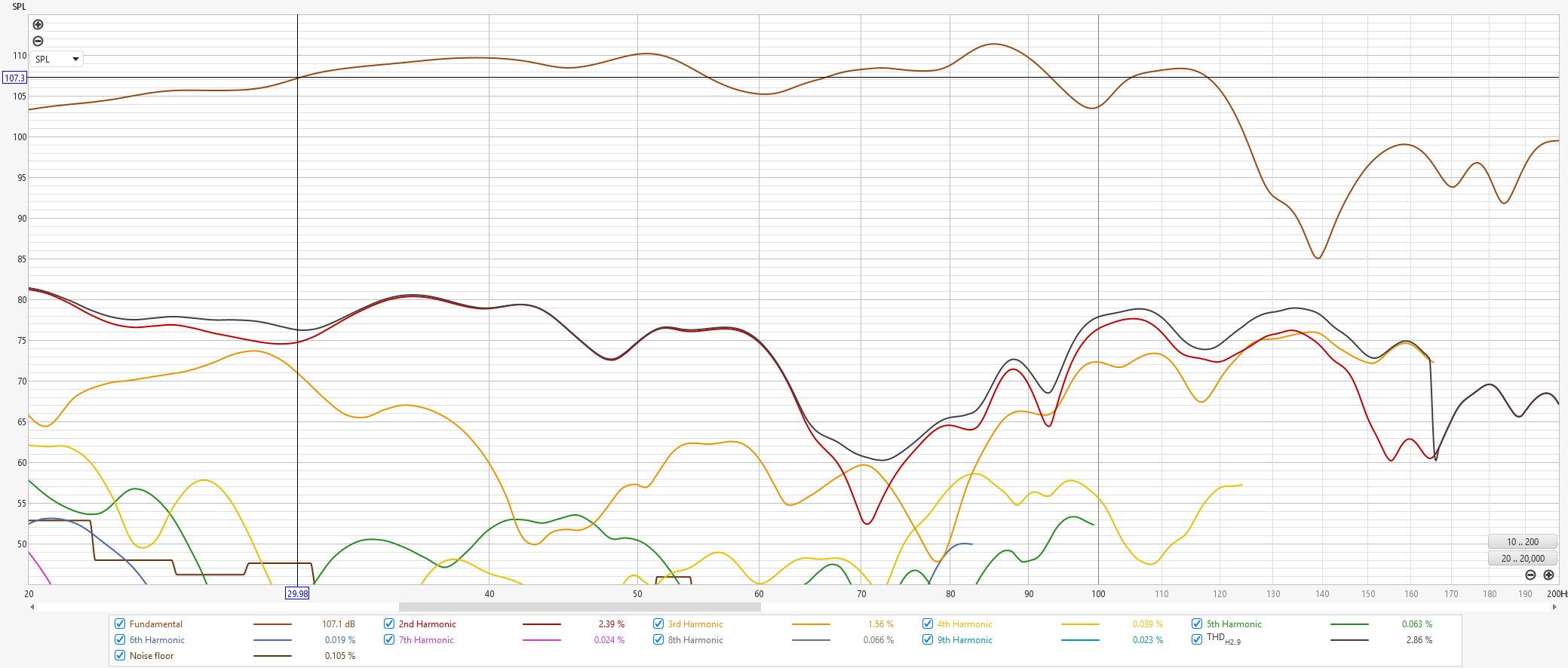

Early anechoic measurements of the Saranna show less than 1% THD at 96dB anechoic. But what does it translate to in real world performance, and what is the performance in the bass? Easy to brag about 20hz bass response if there's no SPL involved right?
So here is a measurement at 2 meters in-room (so with room gain) with a single speaker.
THD of less than 3% at 107dB@2m at 30hz.
THD of ~7% at 103dB@2m at 20hz.

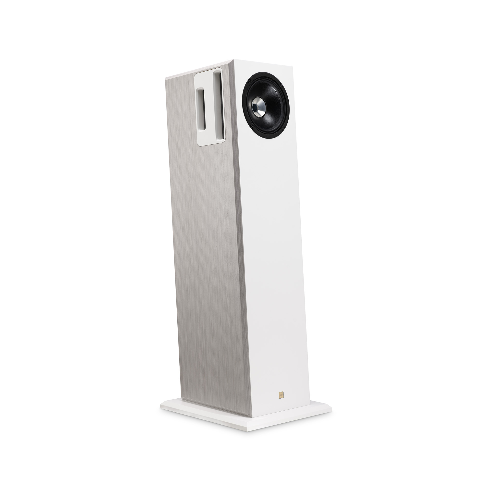

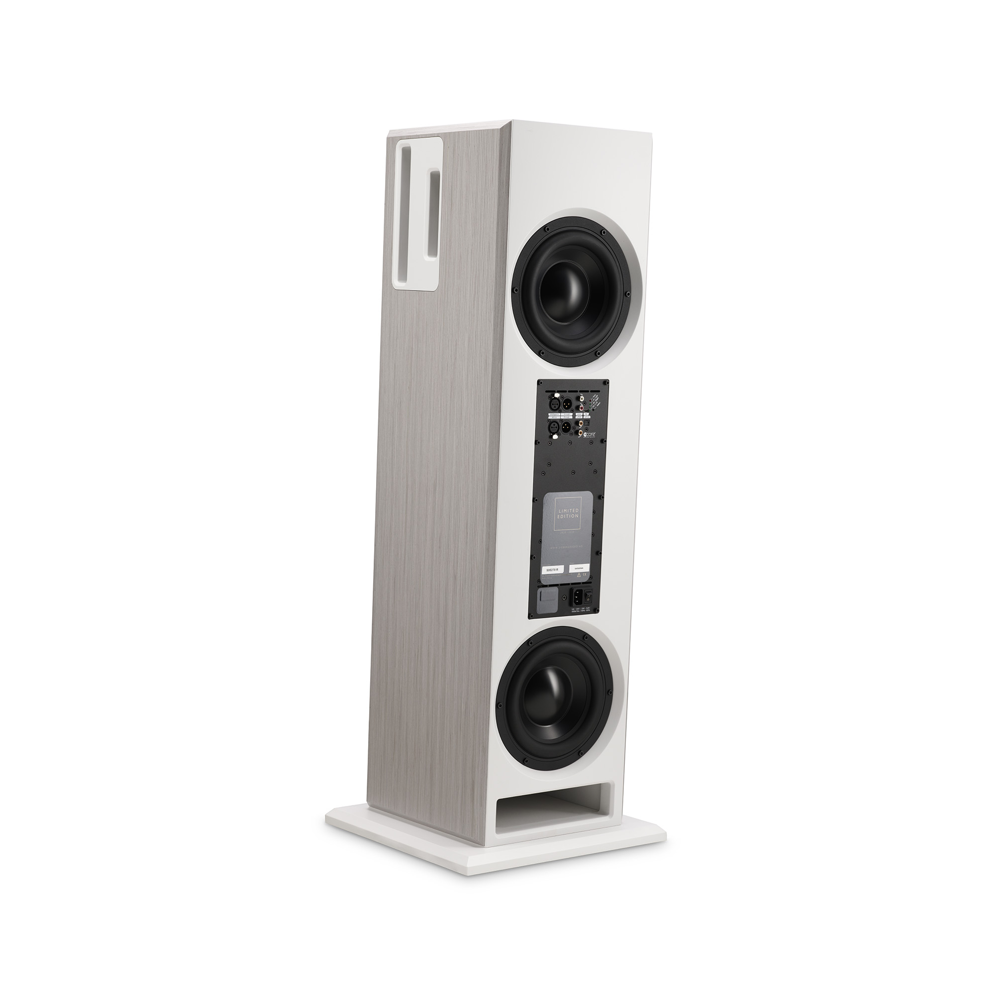

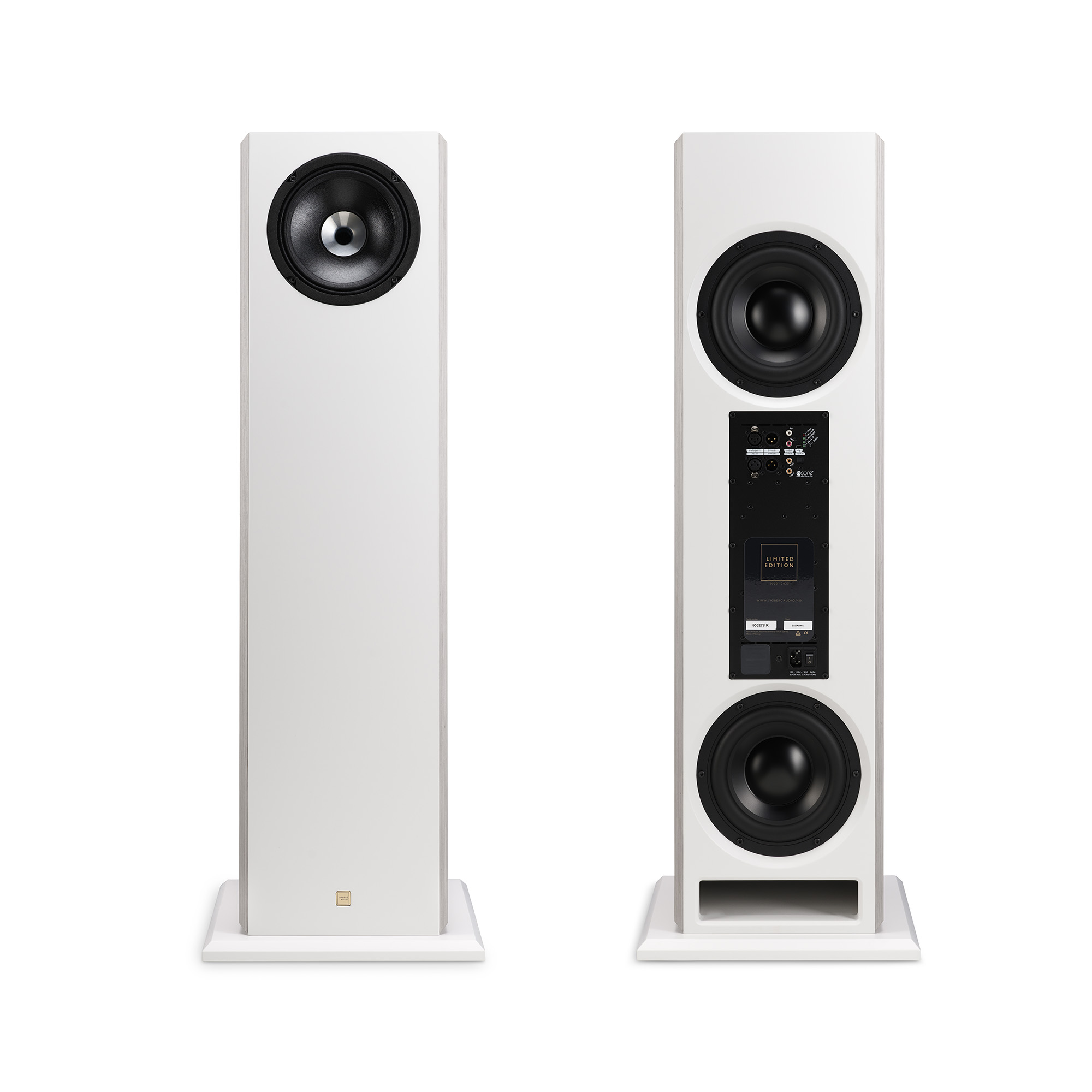

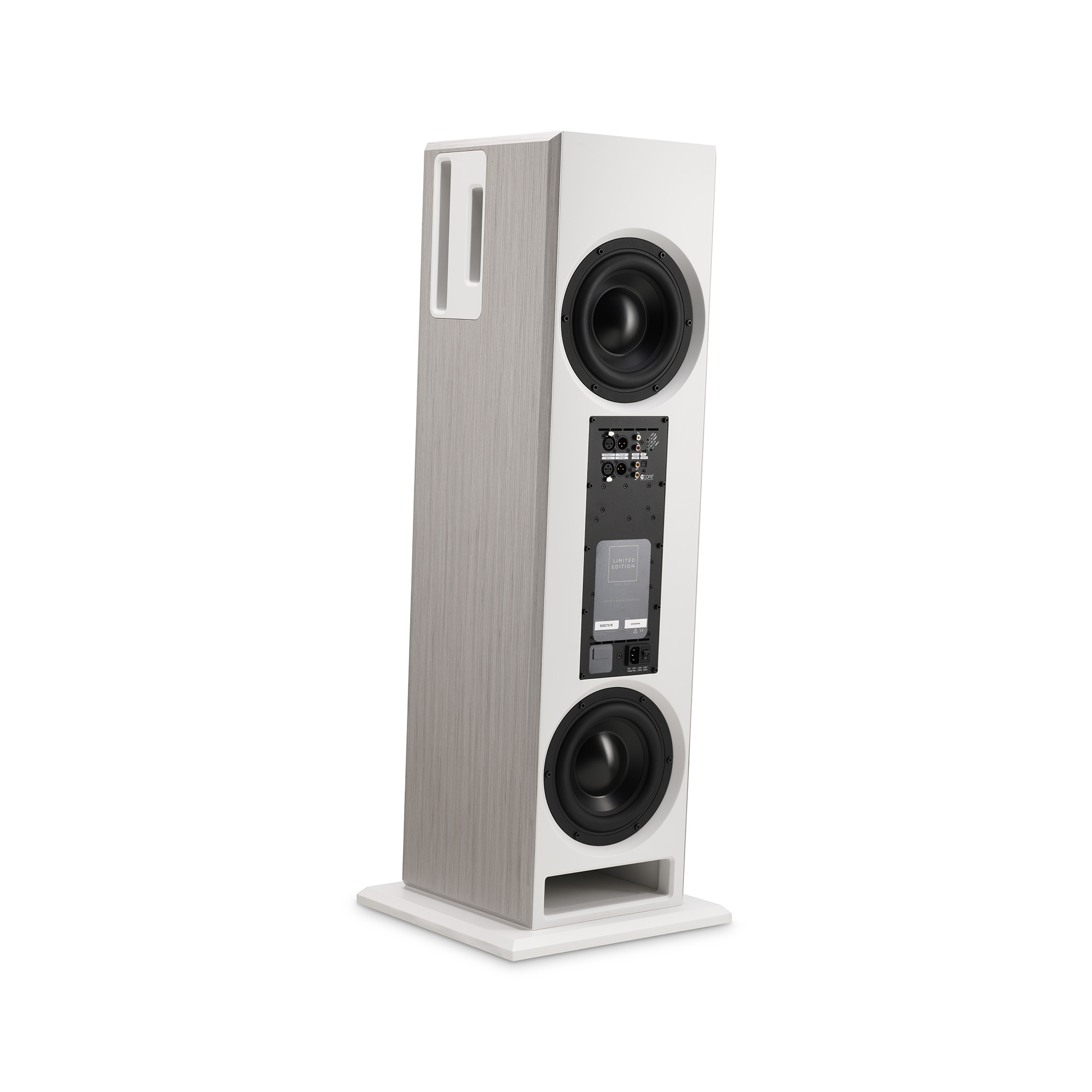

Product photos of the Shady White option is now finally available as well. :) - this variant looks absolutely stunning! :D
It features a paint in deep, silky white with a hint of grey. This is combined with Italian wood veneer in a neutral grey color that captures the light in a way that makes it take on a different hue depending on the lighting conditions.
All photos & product information:
View attachment 73696View attachment 73697View attachment 73698

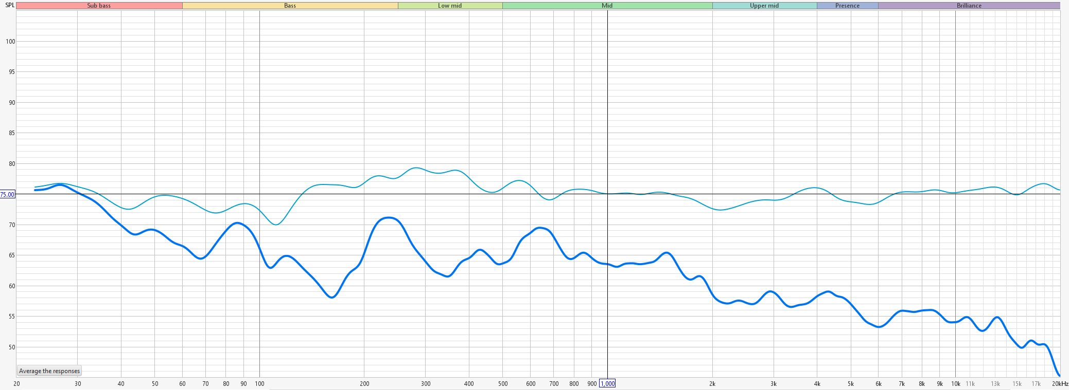

I have just got round to looking at this interesting and likely excellent speaker. If you have been following thes forums you will see I have been preoccupied with my own problems the last week or so.
Since this is essentially a full range speaker, I am wondering what that cardioid arrangement does to the omnidirectional forward radiation transition. In other words how does it affect BSC or even eliminate the need for it? Those rear bass drivers will I assume be operating below the baffle step frequency and the coaxial driver has its rear radiation substantially reduced, and so likely does not require BSC. I assume will all the care you have taken you know the answers to all this.

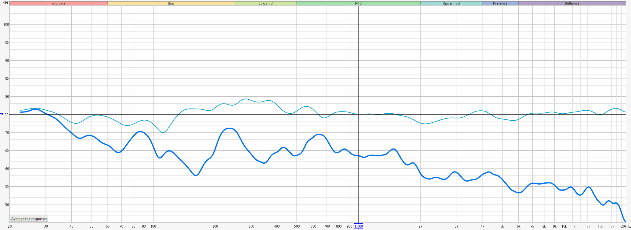

It does not eliminate the need for baffle step correction despite having reduced rear radiation.
I don't have new anechoic measurements of the final speakers (going to Seas to measure in a couple of weeks), but here are in-room measurements that give an indication of the cardioid effect:
The blue line is a summed average of 120, 150 and 180 degrees, while the green one is on-axis.
That looks really encouraging, and is very similar to what I am getting.
Do you have plans to combine the sub outputs that includes the LFE for AV use, or are planning the customer would need discrete subs?
I chose the former as otherwise I would have had to use separate TL subs, which would have been massive and not practical. The quality of the bass is so much better from well designed TLs compared to ported or sealed alignments. Once you have experienced it, there is no going back. I think it is because of the peculiar property of pipes in the way they couple to the air in the room. Organ builders call it the property of encircling. This has never been clearly understood in the realm of acoustic physics, but organ builders have demonstrated it to me. Often times a pipe organ will replace and electric instrument. So, if you set the level of the electric instrument to the same level as the pipes. You can only approximate this, obviously. But the experiment is dramatic. As you move away from the speakers sound intensity drops dramatically as you move away from the speakers, according to the physics of the square law we are all familiar with. But with the pipe organ the sound is very even throughout the space. Organ builders call this phenomenon exhibited by pipes "encircling". That is a good description of it. So, somehow the way pipes couple to the air in the space is somehow unique.
I note this with my TLs as the bass is very uniform indeed throughout the room with no hot spots. So I just wanted the 7 pipes in this system to carry the bass. There are actually 9 pipes but the mid lines in the rear speakers are fully damped with no output from the pipes, but there is no box resonance. The dual lines of the front left and right speakers are tuned half an octave apart, which gives driver support over about two and a half octaves which is the usual sub operating range of 20 to 80 Hz. Whereas a sealed design has no driver support, and a port gives support over a very narrow range.

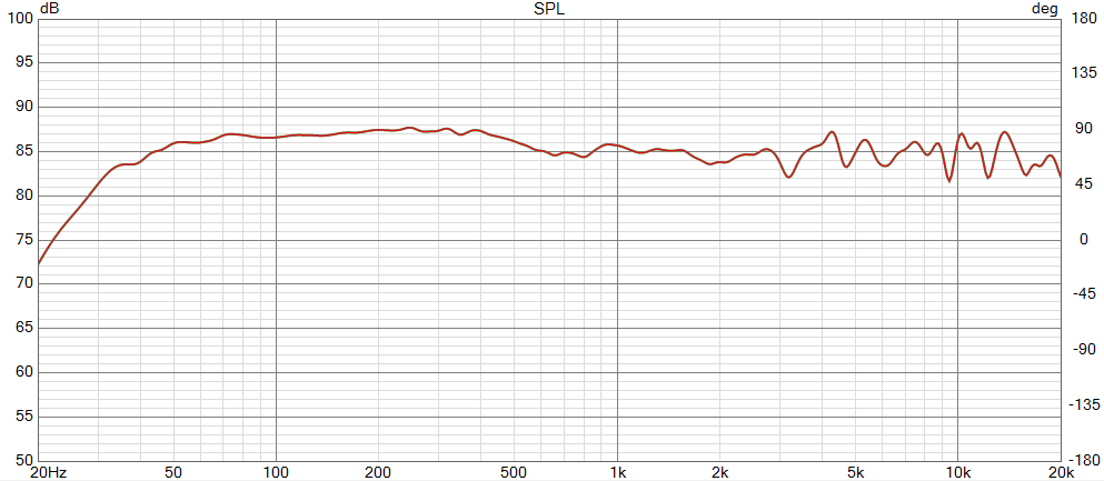

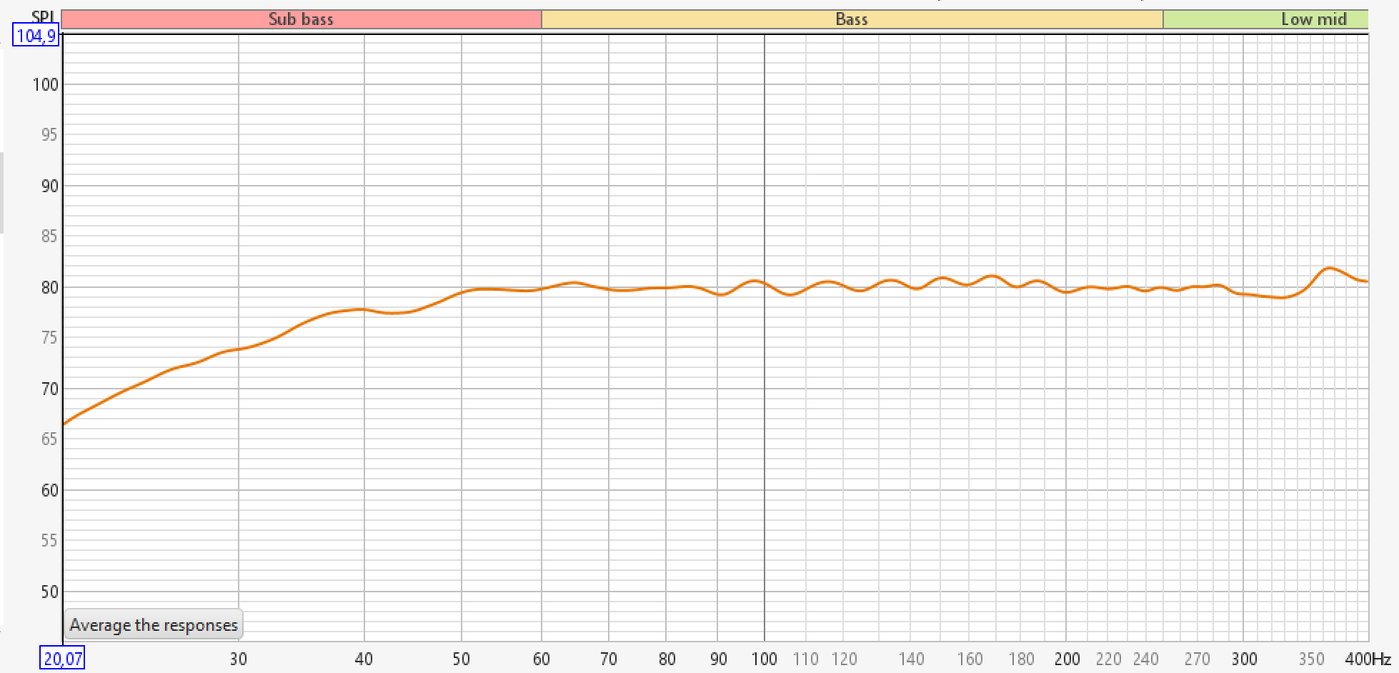

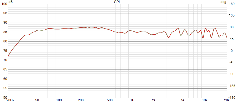

Some measurements.
Below 200hz the frequency response is partly a combination of on-axis and 180 degrees and partly simulated due to the fact that the anechoic chamber does not handle the summation of the drivers properly.

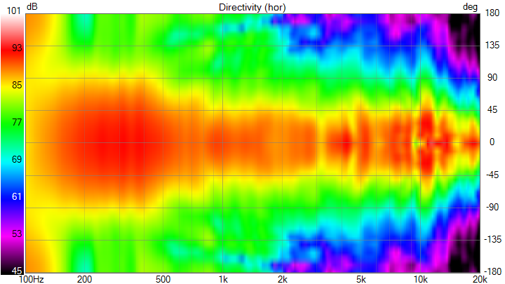

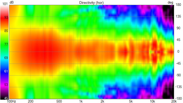

Horizontal directivity / polar map:
Some measurements.
That looks very good. I suspect those slight irregularities above 3K are due to reflections of tweeter and mid cone. Paul Klipsch published a classic paper on this problem of coaxial drivers years ago in a classic article in the AES journal.
I had the same problem in the design of my center speaker. Luckily I had two drivers, for my variable BSC arrangement and I was able to send a correction signal to the tweeter of that coaxial driver.

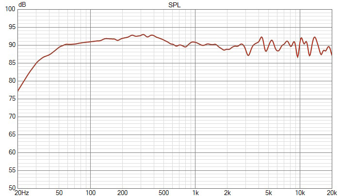

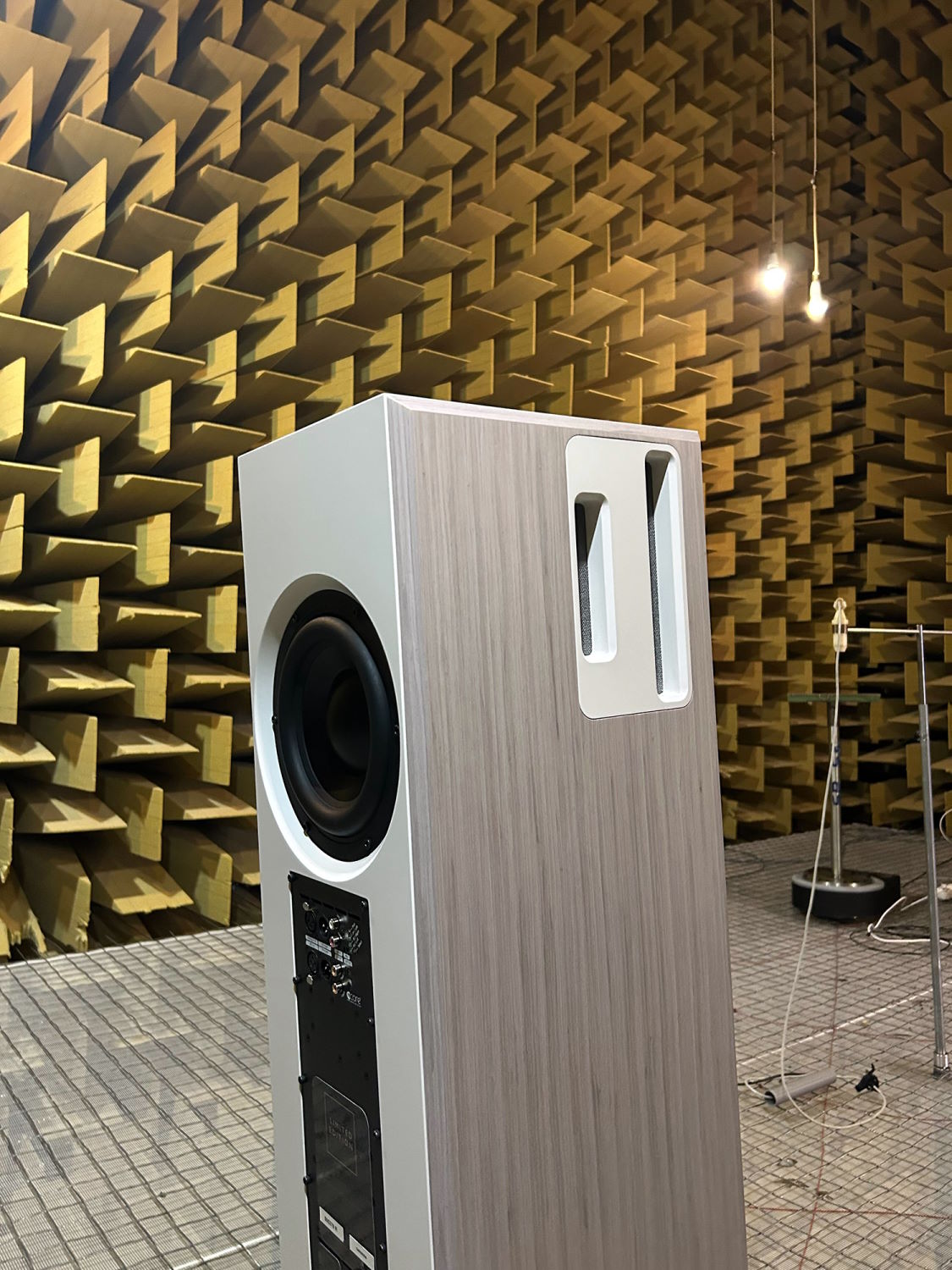

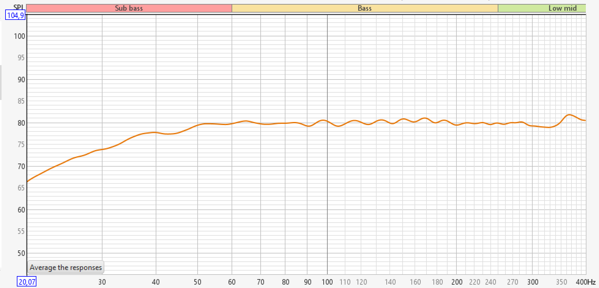

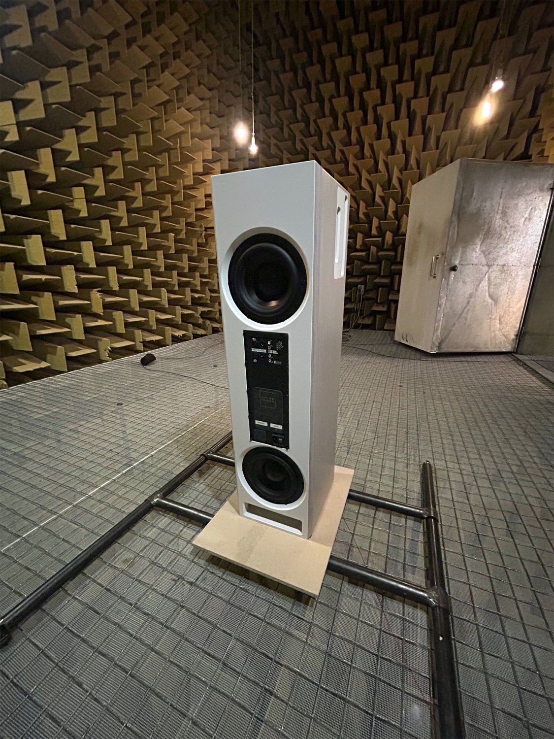

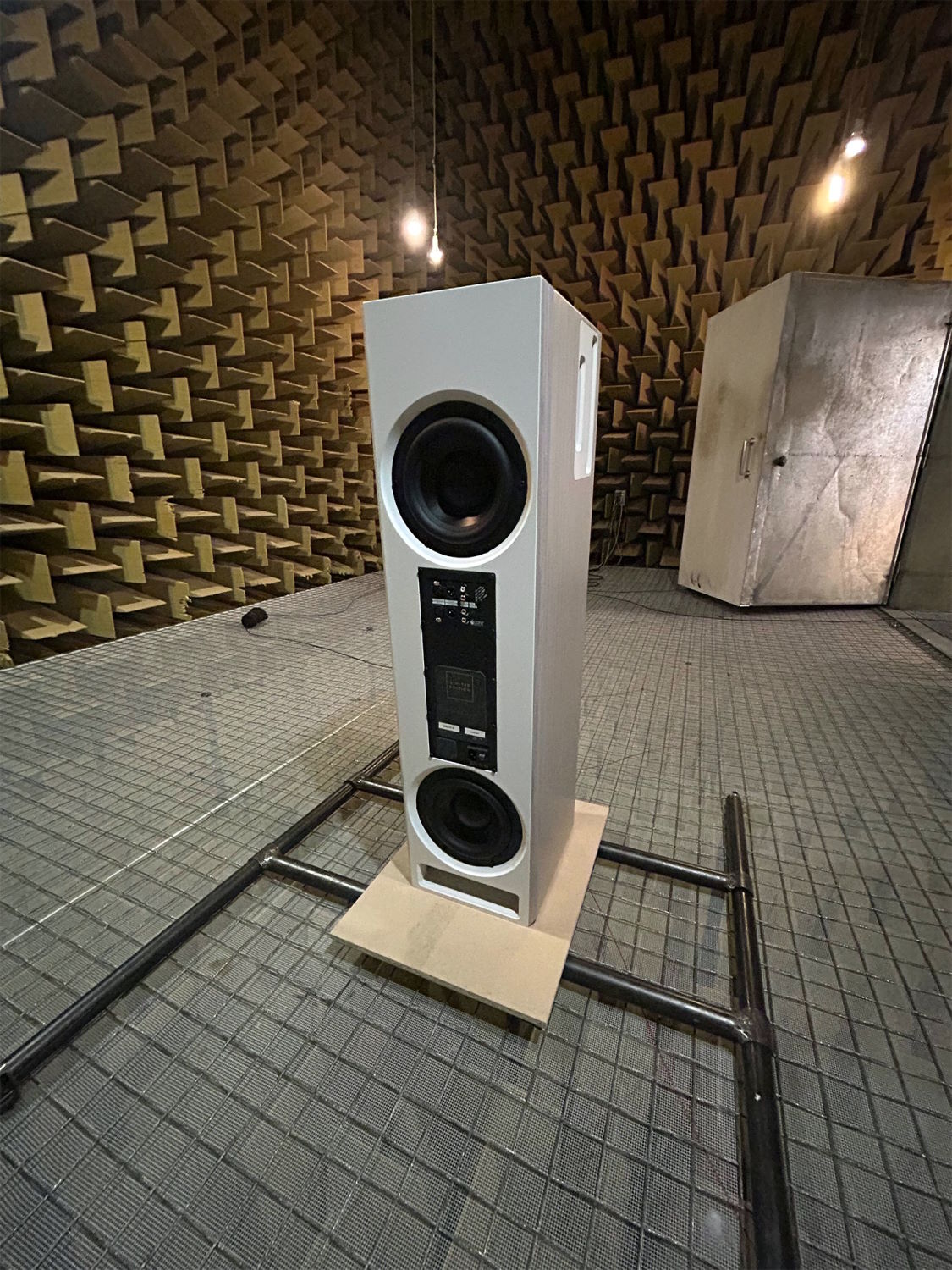

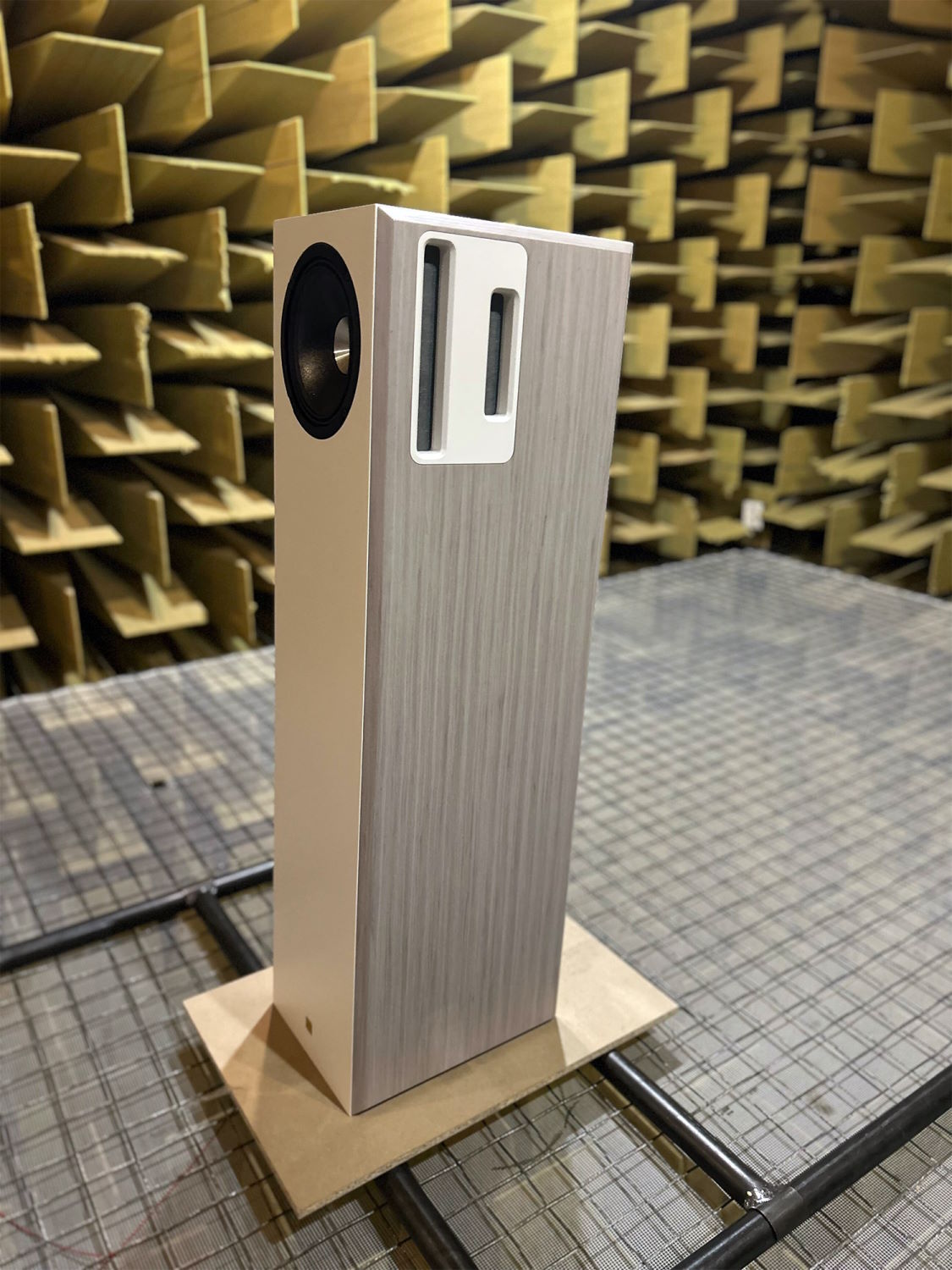

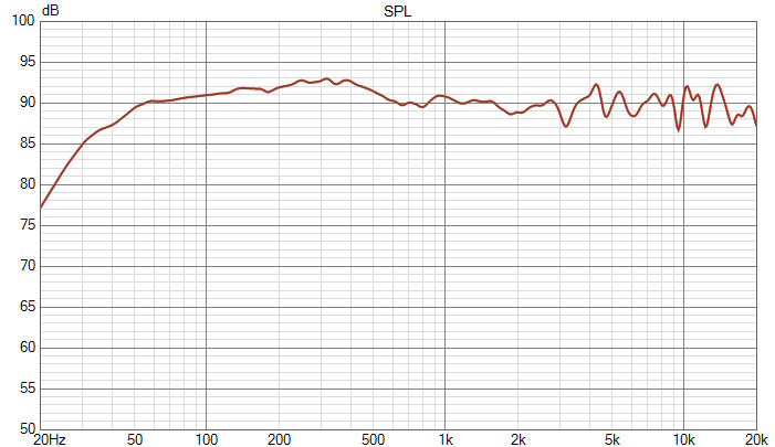

Turned out the simulation/compensation in the bass was a bit rushed, having looked at earlier measurements of the prototype that had the bass drivers in the front + some outside groundplane measurements, I think this is more realistic:
Unaltered groundplane measurement for reference:

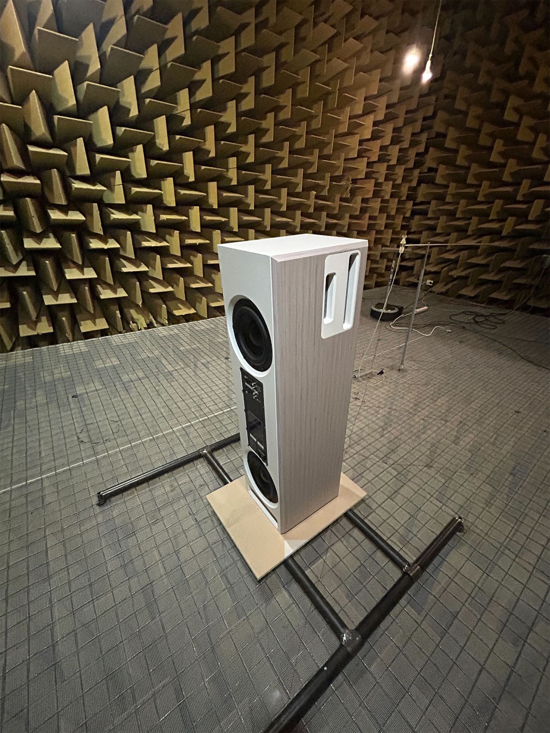

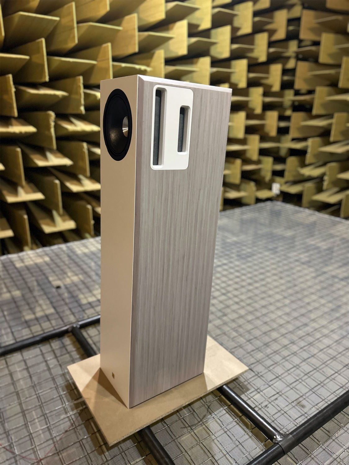

Some pics from the session in the anechoic chamber:
View attachment 73781View attachment 73782View attachment 73783View attachment 73784
