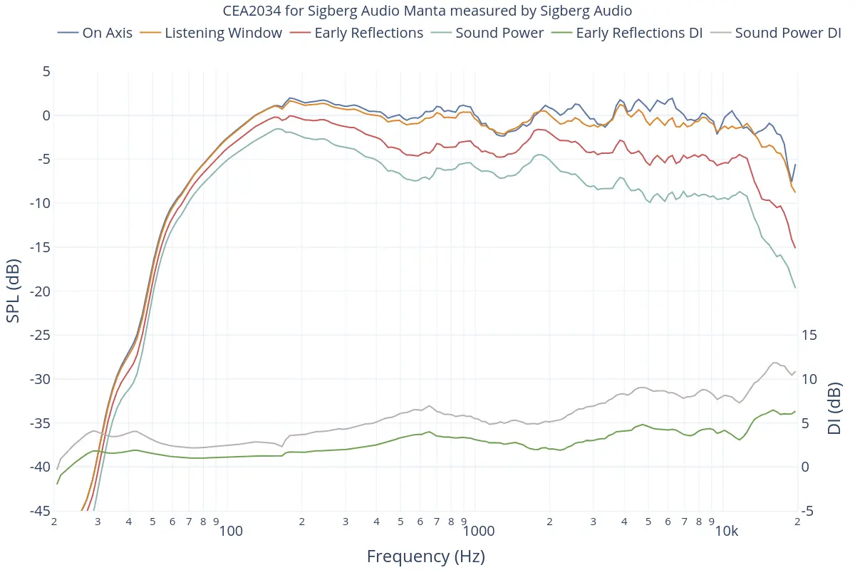

The production cabinets have a different and somewhat thicker type of felt in front of the ports, so I had to to do some control measurements and final adjustments to the internal dampening. With these final adjustments the production tuning has been finalized, and the first pairs are on the way out the door. :)
Some coaxials have a somewhat untidy on-axis response (which isn't necessarily very problematic since you typically listen slightly off-axis), but I'm consistently impressed by this driver. :)
Here's a gated measurement on-axis @1m (non-anechoic), 100-20,000hz:

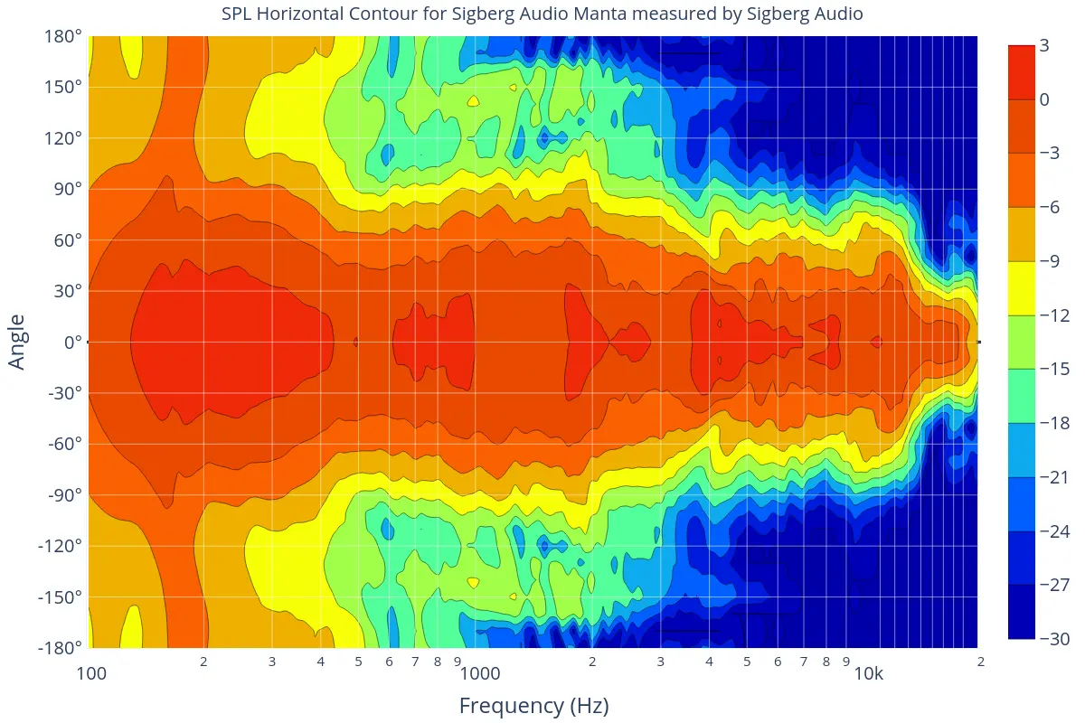

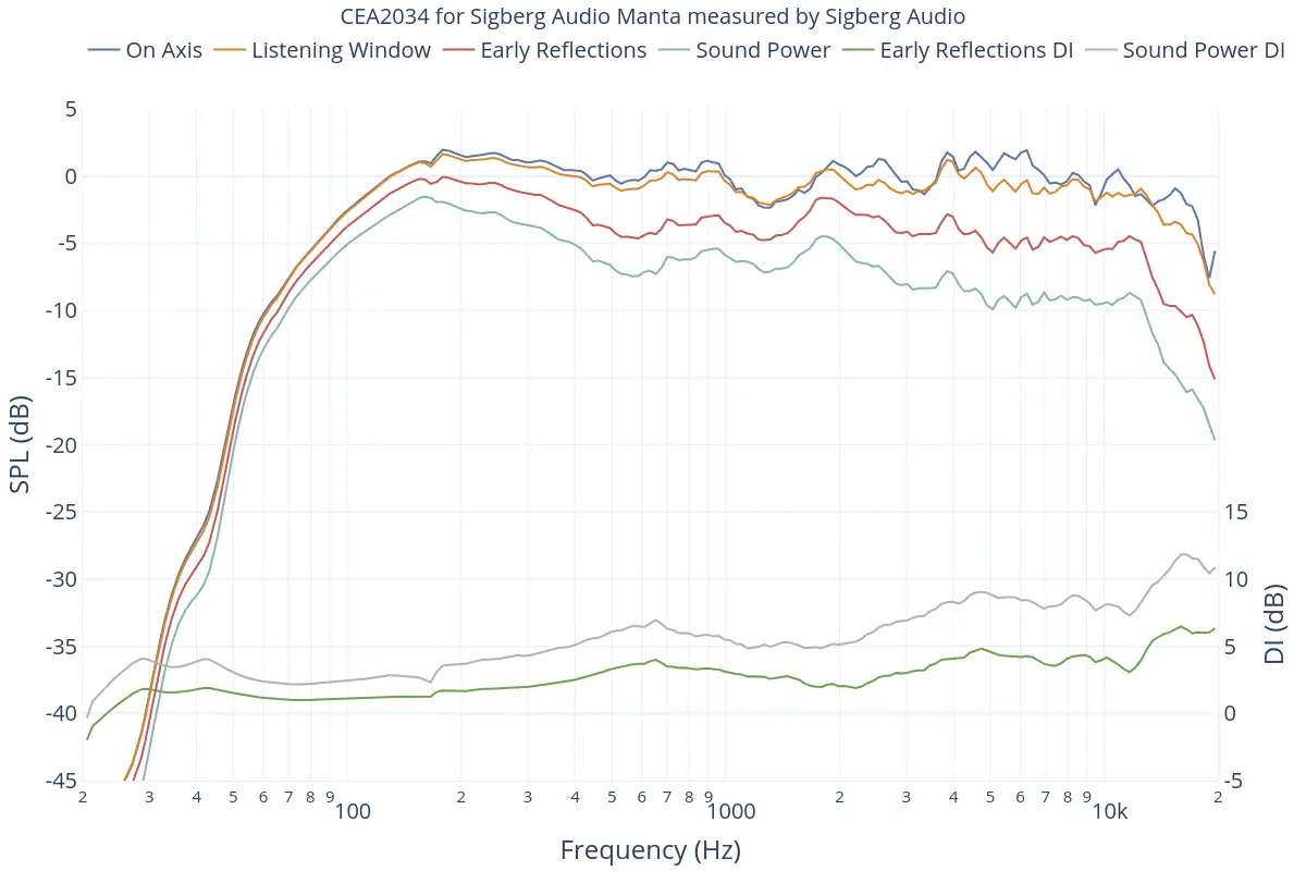

A full suite of measurements of the Manta has now been shared on spinorama.org, see the following link for all the graphs:
https://www.spinorama.org/speakers/Sigberg Audio Manta/Sigberg Audio/index_vendor.html

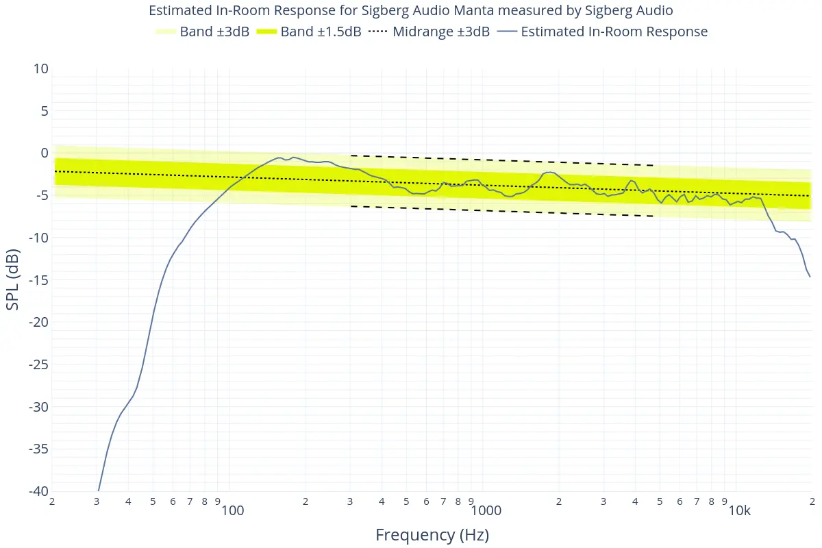

There seems to be a definite problem centered around 1.5 KHz. That is an area where the ear is very sensitive and you don't want problems. Have you any idea of the cause and possible remedy?
Well, you'd definitely rather have a slight dip than a peak, that's for sure. :)

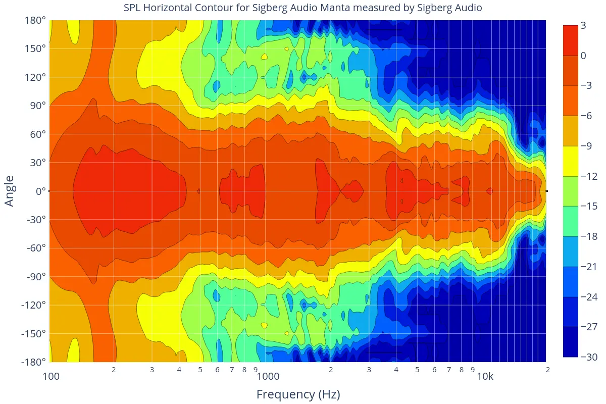

Beyond that, the full picture is a bit more complicated than the on-axis response. There's a dip on-axis, but there is excess energy off-axis. Here is on-axis vs 40 degrees. Which means "fixing" the on-axis response here, doesn't necessarily result in a balanced sound when off-axis is taken into account.

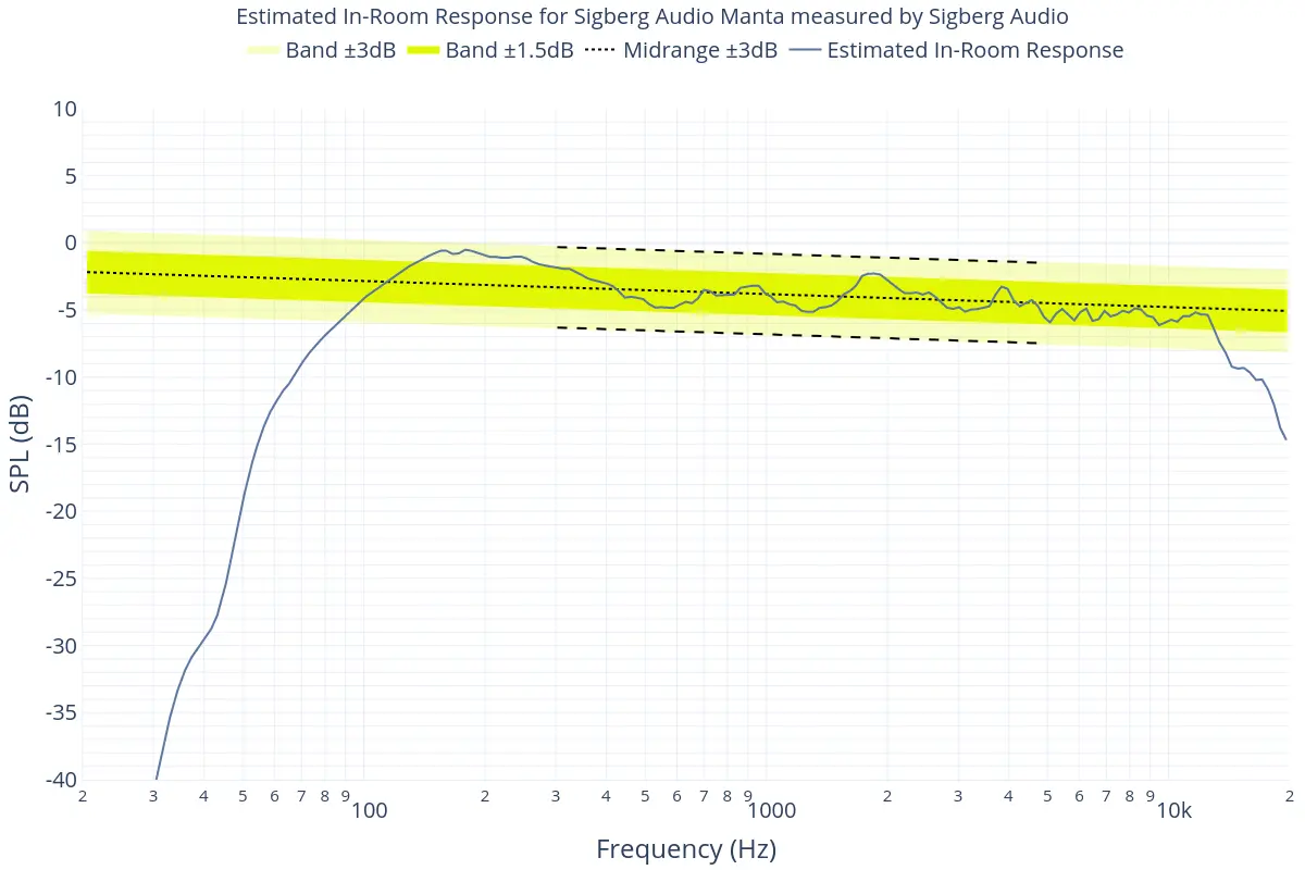

And if we look at the estimated in-room response, we see that what may seem like a significant dip on-axis, is only about 1dB deviation from overall trend in that graph. The dip and subsequent peak is within +/-1.5dB. I'm not sure I would categorize that as a "definite problem", and the overall in-room sound sounds balanced.
listening window shows slight dip between 1-2khz, and minimal peak at 2khz.

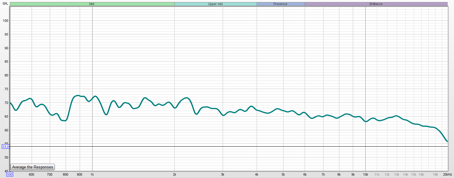

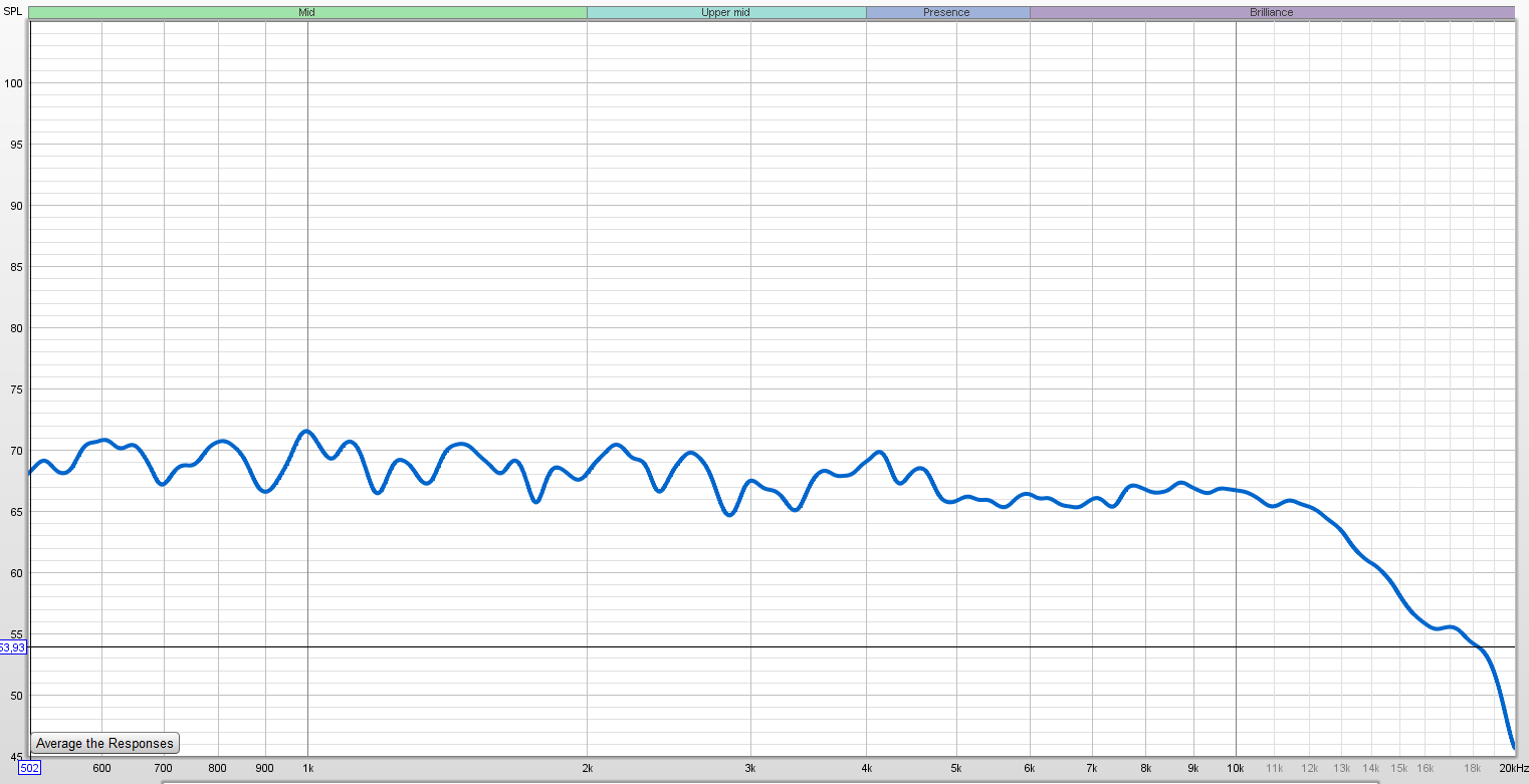

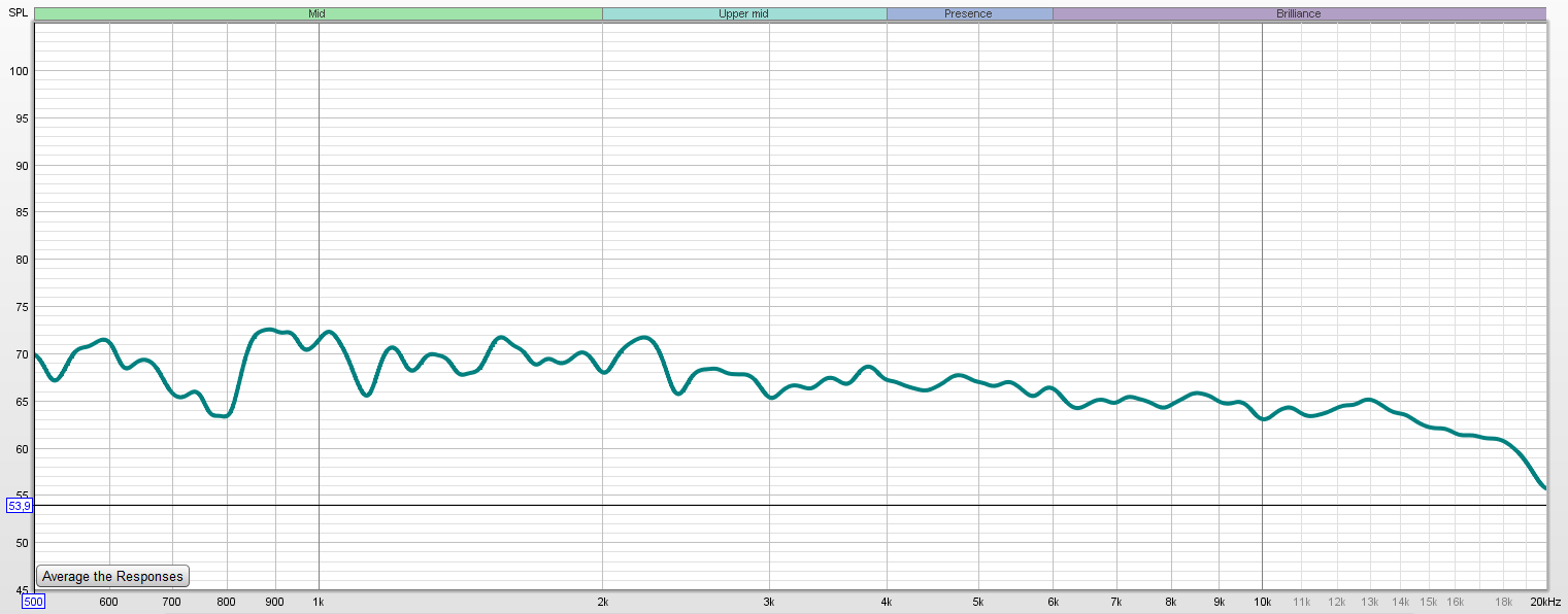

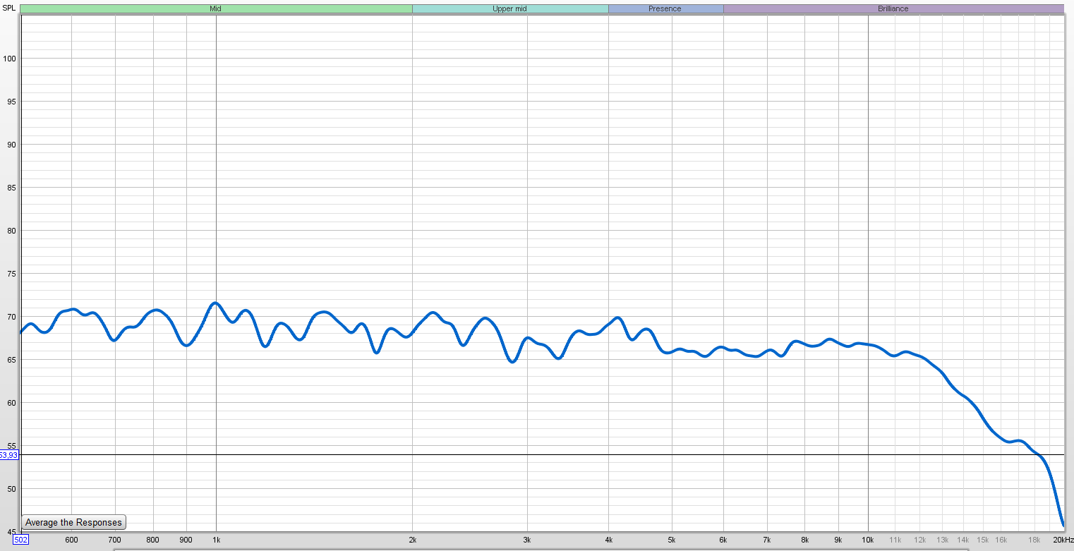

A possibly interesting additional data point, here we can see two different in-room measurement of the Mantas (average of left+right) with no EQ. Two different rooms. (500-20,000hz).
As you can see, they're both balanced across the 1-2khz region. At least for me, this (balanced in-room sound) is the goal, not picture perfect anechoic measurements.
For sure I would rather have a dip than a peak. Sins of omission are always preferable to sins of commission. However that midrange band is an area of special concern, and one really has to get that region as free of defects as possible. That is why I avoid a crossover in that 800Hz to 2,500 Hz band like the plague.

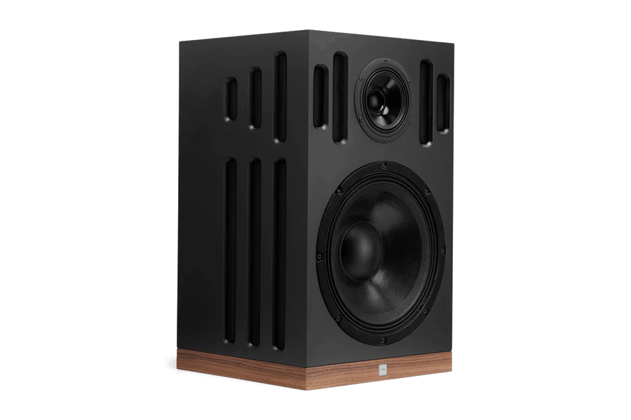

I see I haven't updated this thread in a little while.
The Manta is now available in White as well! :D
