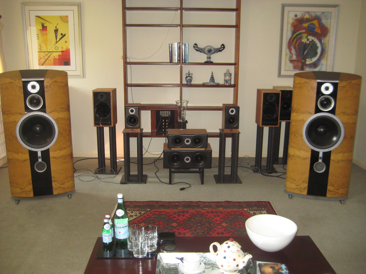

Sorry for the tardy reply. Yes, I do have pictures, but members here will likely have seen them before.
The equipment consists of AV equipment an HTPC, a DAW loaded with WaveLab software and an RME mixer/Dac. There is a 16 channel mixer in the draw below. There is an assortment of vintage digital equipment, and especially of vintage disc and tape equipment, which I call the museum part of the system. There are three vintage turntable and vintage reel to reel equipment from Studer/Revox, and a rare Brenell MK 6 of the type used by the BBC, there are DOLBY A units and free standing dbx I and II decoders, including a dbx LP decoder and a free standing Dolby B decoder. There is a TEAC Z2000 cassette deck and a studio NAK deck.
The crossovers in the first rack are 3 modified Shure SR 106 crossovers for the front speakers, which I have had since the seventies sometime, and a Crown VFX-2 for the rear backs. I bought that in 1977. I personally did a total refurbishment about seven or eight years ago, and upgraded all the IC op-amp chips, to more modern lower noise devices.

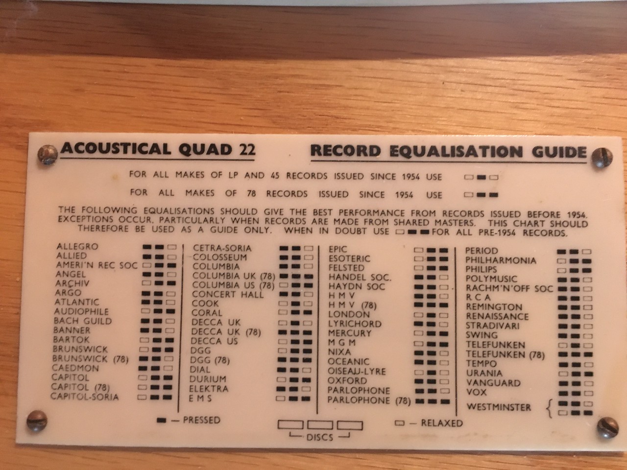

It can even play 78s
The system is powered by 18 power amp channels providing just over 3000 watts. This is provided by 7 Quad 909 amps and two Quad 405-2 amps.
These are the front speakers.
The left and right speakers are dual transmission line speakers with the lines tuned half an octave apart. The center is TL coaxial 2.5 way. Four Quad 909s power the front three.
Center TL which is a though wall design.
A main dual TL
This is a view of the rear of the room. You can see the surrounds, which are totally active and the bi-amped rear backs, which are also dual TLs, these were my main speakers from 1984 until 2006. The surrounds used to be my location monitors when I made broadcasts for the local radio station. They were built in 1984 and use Dynaudio drivers. The rear backs use two KEF B139s in each line and three Dynaudio drivers in each line, a cone mid, and dome mid and a 3/4" soft dome in each. These drivers use first order filters and are slightly staggered to optimize the phase response. These speakers were deigned in partnership with the good folks at Dynaudio, who were also designing a speaker using first order filters at the time. These speakers are powered by two Quad 909s. The surrounds are powered by one Quad 909.

I also have a 3.1 in wall system in our great room and a 2.1 system in our family room.
