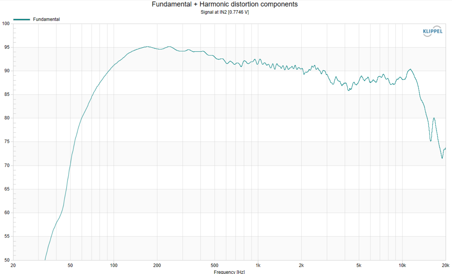

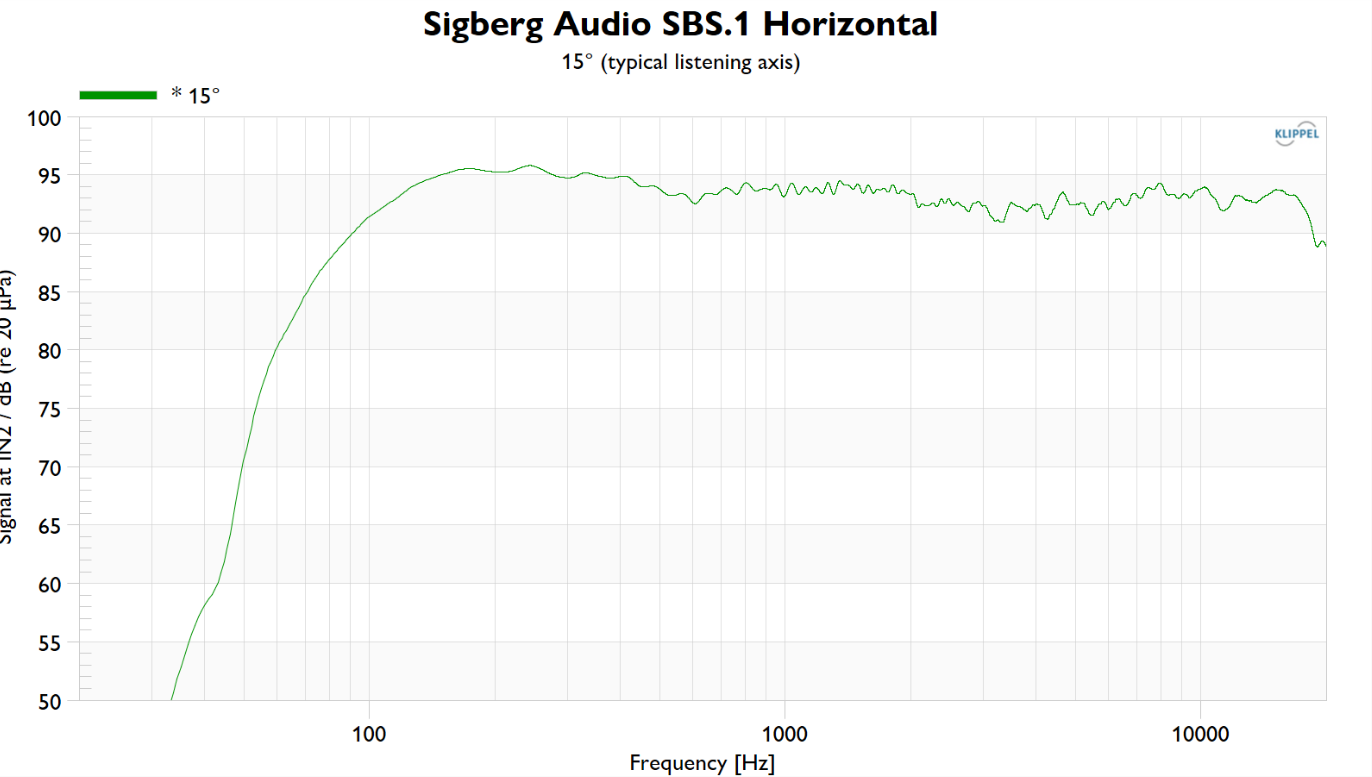

The performance of a speaker isn't easy to gather by just reading the on-axis response.
Compromise always needs to be made between on-axis and off-axis response, one needs to understand how the speakers interact with a typical room, etc.
It's also worth mentioning that these speakers are designed to be placed parallell with the back wall (zero toe-in). That means on-axis will not be the listening axis. Typical listening angle would be around 15 degrees:
On this axis you're pretty much at +/-2dB, and the curve you see is by design, not deviations. The slight rise in the low end is not an accident. We could have made this +/-1dB if we wanted too, but that would not give the best result if you also consider off-axis response, or how it sounds. Also note that there is no craziness even above 10khz at this angle. :) Finally, the cabinet has a 4 degree tilt, which means there's slightly more top-end energy sent into the room than the graphs indicate.
On this axis you're pretty much at +/-2dB, and the curve you see is by design, not deviations. The slight rise in the low end is not an accident. We could have made this +/-1dB if we wanted too, but that would not give the best result if you also consider off-axis response, or how it sounds. Finally note that there are no craziness even above 10khz at this angle. :) Finally, the cabinet has a 4 degree tilt, which means there's slightly more top-end energy sent into the room than the graphs indicate.
This is a good point. A lot of the devotees of the CTA-2034 crowd miss that not every speaker was designed to be listened on-axis, in fact, quite a few are not. So the intended angle of listening can be between 15 to 30-degrees, and I have seen many instances of this myself. Probably something I should have emphasized in the review!

@Sigberg Audio what is happening in the 2-4K range, please?
That is an intentional drop, again partly to compensate for off-axis response. As a quick example to emphazie the point, let's look at for instance 45 degrees. We will see that we're suddenly flat / have an even drop all the way to 3khz, so the dip present from 2-3khz on-axis is gone, it's almost a slight rise. This range would be too powerful if the on-axis were flat.
Building a good speaker isn't just measuring and hammering the on-axis response flat. I've spent hundreds and hundreds of hours listening to all kinds of different music on these speakers, during that time we sometimes find things that stick out or sound wrong despite an even on-axis response. And when inspecting with measurements we can find things like this, making it evident that we need to do adjustments that ensure that also the off-axis response and early reflections are balanced. :) If it had sounded better with a flat on-axis response from 2-4khz, that's how they would have been tuned. But that is not the case. I won't chase perfect on-axis response at the expense of the overall sound, even though I know that means some will misunderstand what they're seeing when looking at the graphs.
I get it.
I know it is not a Mid Range Compensation as I commented earlier. It did pique my curiosity, though, as it was evident in the On-Axis, and LW plots from the Spin. That said, it was not mirrored in the Early Reflections or FR DI plots.
