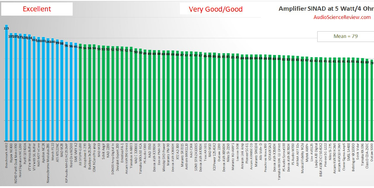

If you want to be sure the power amps have low enough noise and distortions, look for one that measured well on the test bench in SINAD (that is same as THD+N with a minus sign). The following ASR chart should give you a good indicator to help you narrow down the best ones you can safely choose from.
Starke Sound AD4.320 Review (Multichannel Amplifier) | Audio Science Review (ASR) Forum
Note that I have to include the top 80 devices measured (as of Sept 28 this year) that are power amps and other devices that have build in power amps, to include the Outlaw 5000 in the chart ranked by SINAD/THD+N measured at 5 W output into 4 ohm.
So are you clear with the so called "gain matching" now? That you have nothing to be concerned about as the Trinnov's approx. 6 V rated balanced is nothing unusual. Even the very popular Yamaha and Marantz AVPs can output 8 V (balanced). The actual output you need will depends on your listening habits, the gains of the power amp of your choice, the impedance and sensitivity of your speakers, and your seating distance etc. For example, if you don't listen very loud, have speakers with good sensitivity in the 90's, your 6 V capable Trinnov may never even reach 2 V.

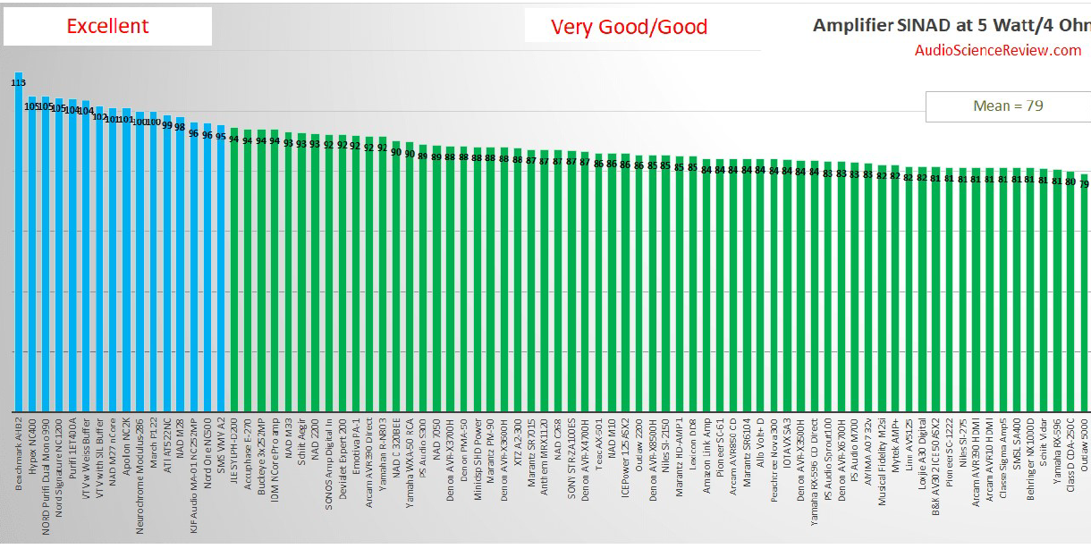

In terms of noise floor of the Outlaw amps, based on specs only, the 7220 should be fine as far as matching the Trinnov's. The Outlaw 5000X does not even have a noise spec., but based on the measurements of the 5000 that should be very similar, I would bet the 5000X would in fact have a noise floor that would become the bottleneck. That being said, it seemed reasonable (based on the measurements of the 5000) to expect THN+N for the 5000X to be about -80 dB. If that's the case then you should hear hiss and/or hum when you are close to (say within a meter or two) during the quiet passage in music and movies, otherwise for practical real world use, I highly doubt it would be an issue.

I finally took a look of the Trinnov Amplittude's spec., and read a couple of posts on the AVForum and now I understand why you are concerned.
  • THD+N Single Ended:0.0015% - 8Ω, 5W (2dBu)
Based on that, you would in theory be in the sweeter spot in terms of achieving better THD+N at the lower output level. Practically speaking, that may or may not translate into "better" overall because at higher levels, say if you listen to near reference level, sitting far enough and have speakers that have low sensitivity and/or low impedance then things change, and you could suddenly do worse. For example, if the combinations require the power amp to remain well below clipping at up to 300 to 400 W into 8 ohms, then 6.15 Vrms is not going to cut it because it would only drive the 16 dB gain Altitude 16 to 200 W. To reach 400 W, both the Altitude and Amplitude amps are going to be clipping!! So as I said before, this so called gain matching thing is more complicated than some forum talks may led people to believe.
In one of the post, you hit the nail on the head, that is, ideally you need a different power amp that could match the Altitude 16 better. That is, the use of attenuators can get your AVP closer to the sweet spot in its operating output voltage range, but it won't help your power amp at all as its gain will still be 28 dB if that's its spec. One poster, obviously didn't understand the concept, that is, attenuating the input signal by 10 dB to his 29 dB gain power amp does not improve the noise level because the gain of his power amp will still be 29 dB. Again, it will improve the preamp/processor's THD+N at lower output levels, say below 1 V, by a few dB.
Simply put, based on Amir's THD+N vs voltage graph you would ideally want your preamp/processor to stay in the output voltage range of say around 0.5 V to 6 V most of the time, for it to have THD+N no worse than about -90 dB. That is a very tall order though, if possible at all. The only power amp that I know may fit the bill is the AHB2, bridged only. So even to do just the LCR you will need 3 units for about $10,000, not a bad match with the $16,000 Altitude 16. That will get you 380 W into 8 ohms and you will have the best possible overall SINAD for the AVP/Power amp combo, for the front 3 channels.
Keep in mind, we are discussing the theoretical numbers. In practice, even if the Altitude's THD+N increased to -80 dB, or 0.01% at <0.3 V (no idea what the Amplitude's would be at but I doubt it would be better than 0.01%), can you really hear a difference, when any such distortions and noise would likely be buried in your room's noise floor?
I attached two graphs below so you can see that if the best possible THD+N by matching AVP output to power amp input is so important, to the couple of fellows on AVF, they should just pick up a Denon AVR, or for Marantz fans, the SR8015 (much better results than the AV8805A). :D Obviously they know THD+N is not the only important factor for the best SQ..
The SQ difference they claimed hearing on that forum would most likely be due to a combinations of:
- Not doing tightly controlled tests, ie level matched, pure direct, everything else same...etc.
- Sighted test only.
