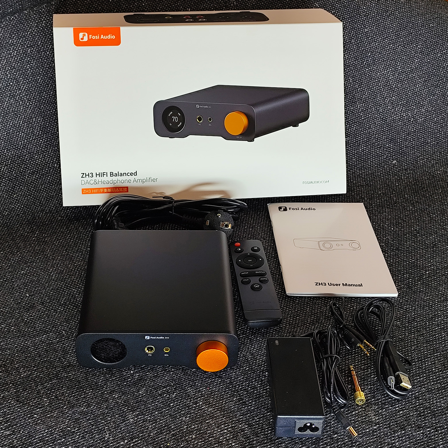

Let's see what we find after opening the box:
1. ZH3 DAC/Headphone Amplifier/Preamplifier
2. External power supply
3. Variable USB cable, already familiar from the Q6 DAC
4. Remote control
5. 6.35 to 3.5 jack converter
6. Trigger cable
7. User manual
At first glance, it's clear that it's part of the "Z" series. The dimensions and shape of the housing are the same as the ZD3 and ZA3 models. You could say that this is an new version ZD3, but the difference is immediately noticeable in the front-panel headphone jacks. This is a new device.

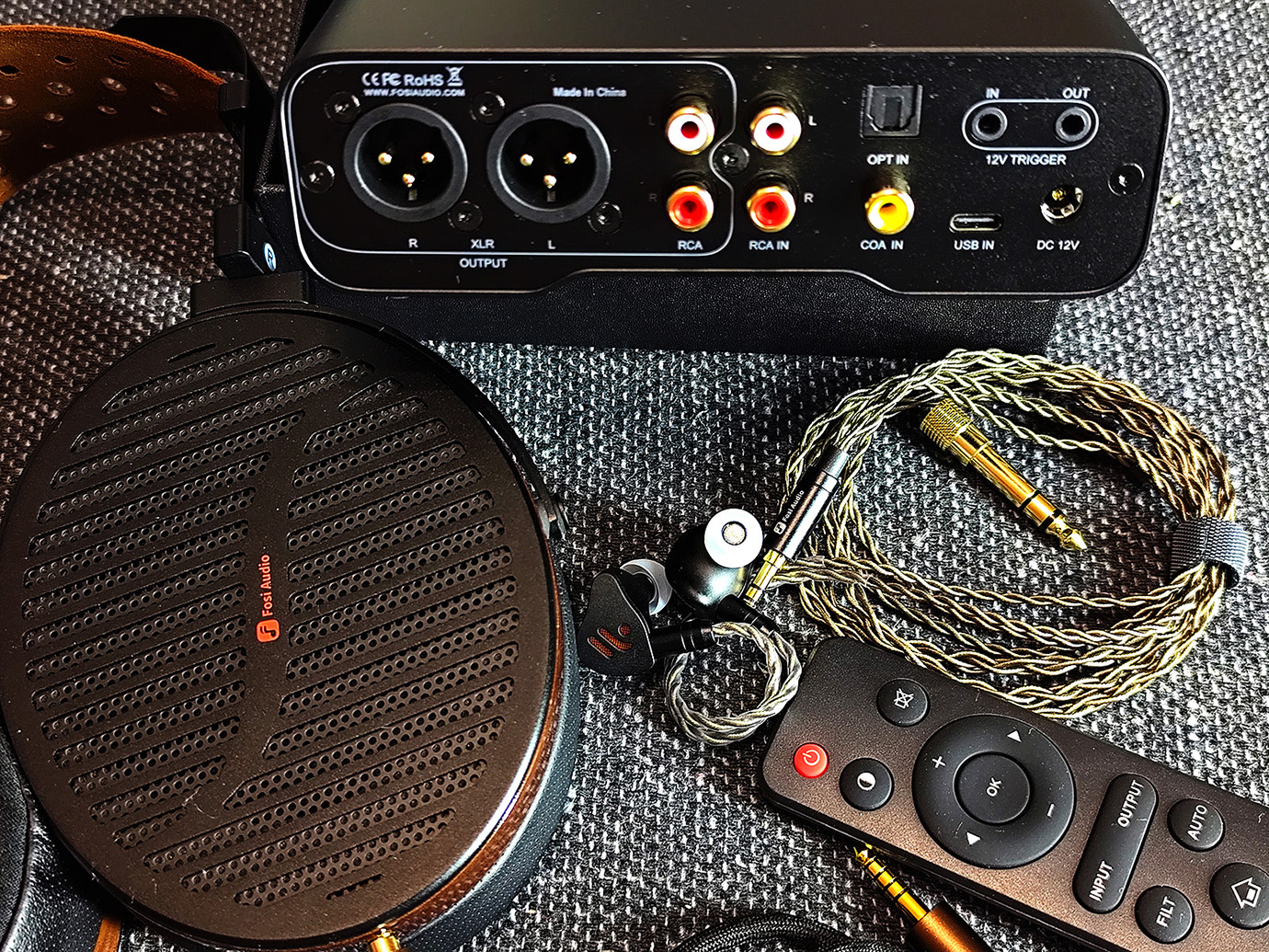

Backside and connectors:
Backside connectors list: Outputs: XLR output. RCA output (which can be used in parallel at the same time!)
Inputs: Analog RCA, digital coaxial, optical, USB-C input, trigger in/out connectors and power input.. I am very happy about this analog RCA input, i always big need an (i.e. more and more) analog input. USB-C input, well, I regret this somewhat, because my special hifi USB cable is not equipped with a USB C plug, but I see this trend with several manufacturers and since the ZH3 sounds very good with the factory cable, I will accept it.

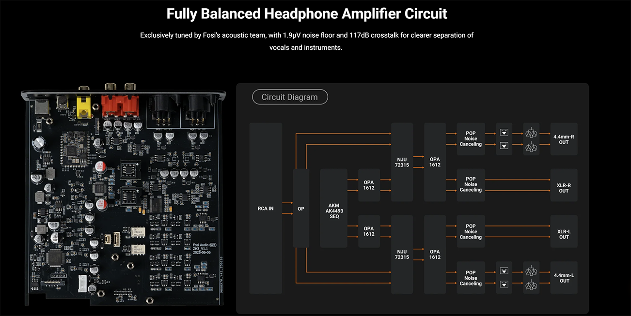

Inside and circuit diagram:

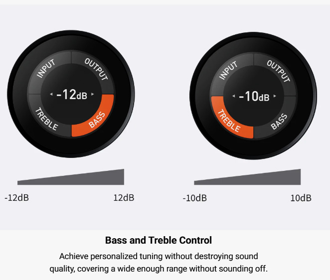

The ZH3 itself has three functions. 1: DAC – 2: Headphone amplifier (in PO mode) and 3: Preamplifier (in AUX mode). The preamplifier can be used with a volume control (AUX) as desired, for example in monoblocks or amplifiers with fixed volume, or (in LO mode) when the volume control is turned off and the full volume goes to the power amplifier. I only recommend this for amplifiers with adjustable volume or active speakers, as it outputs maximum volume. This setting is easily done from the menu. The ZH3 has an equalizer, which is also available from the menu. The equalizer can only be used in headphone mode. Unfortunately, it is not available on other outputs.
With headphones, the effect is +-12db for bass and +-10db for treble.

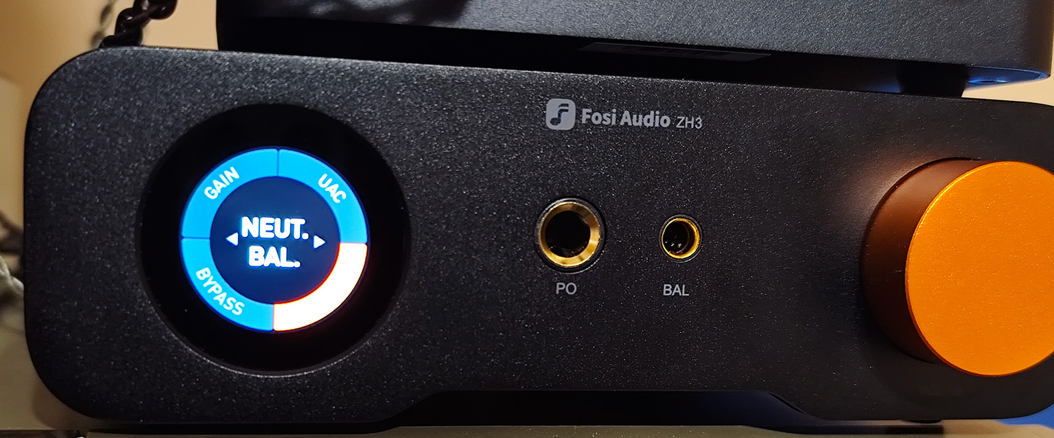

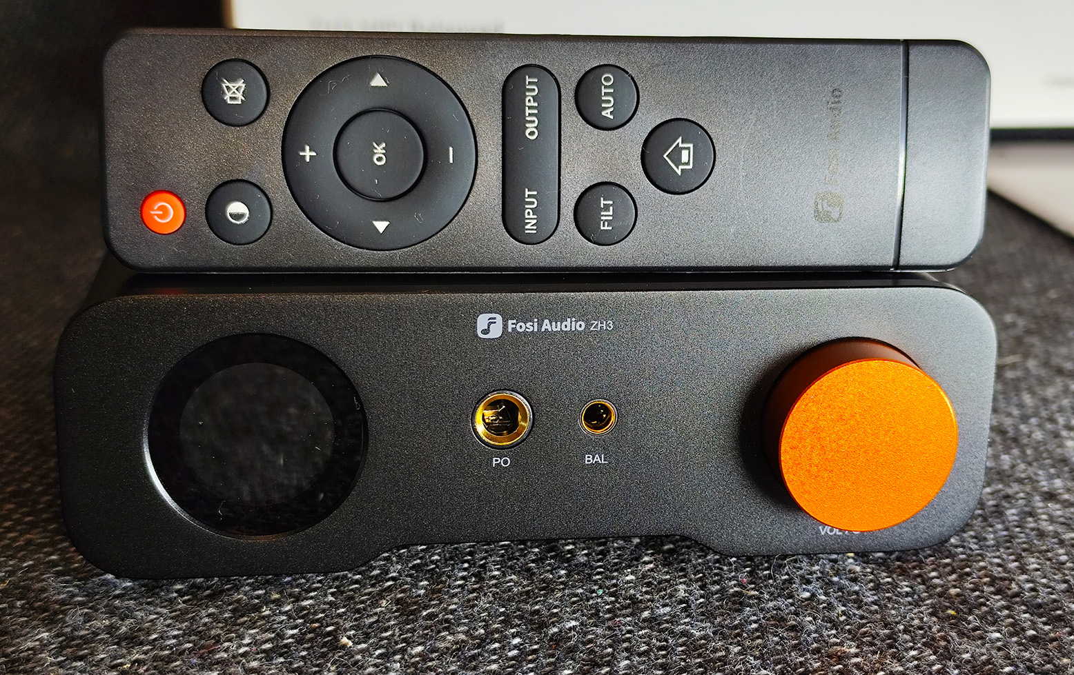

The ZH3 menu structure is clearly visible and easy to use despite the single button. All functions are easy to find and easy to adjust. Here you will find the input selection. the output selection, the filter setting and Tone and of course everything else. Output settings Headphones are set to PO, preamplifier to Aux and the full output volume is set to Lo output. The menu system is very user-friendly. I found only one small drawback. For me, exiting the menu is not the best solution, since there is no separate button to exit the menu on the device and after completing the settings, the device enters the default state after 10 sec. This is quite a long time for me. At first I looked for a way to exit from there. But it exits by itself.. These 10 sec could it can be if possible changed with a software update, say by at least half (5sec). (this is just an idea, i don't know how this is possible.) It 10 sec is not very annoying, but I found it slow. However, there is a “home” button on the remote control, so for me it is “problem solved” In general, we can say that the remote control helps a lot in the operation, although it is a fact that the large control button on the device is very easy to operate the device.
But with the dedicated buttons on the remote control, it is always faster.
There are six types of filters. These are: Precise Analytical, Powerful Dynamic, Neutral Balanced, Extended Highs, Well Defined, Natural Smooth.
The effect of the filters is a matter of hearing and taste. For me, three filters are clearly audible, and I am unsure about some. Just as I am unsure about which one I like best. I think "neutral balanced" is the best for me, but I have turned on others a few times. The "natural smooth" and "precise analytical" filters. I wish everyone a good game and hope they find their favorite.

Very good, even outstandingly good! Once you understand the menu, everything is logical and easy. After switching it on, it gets ready very quickly (1 sec). I use the display in automatic mode, so the display turns off after two minutes and the device itself turns off after 30 minutes of complete inactivity if it does not receive an input signal. The display is very visible, sharp and informative, displaying all important information. The display brightness can be adjusted in four levels (25%-50%-75%-100%)
