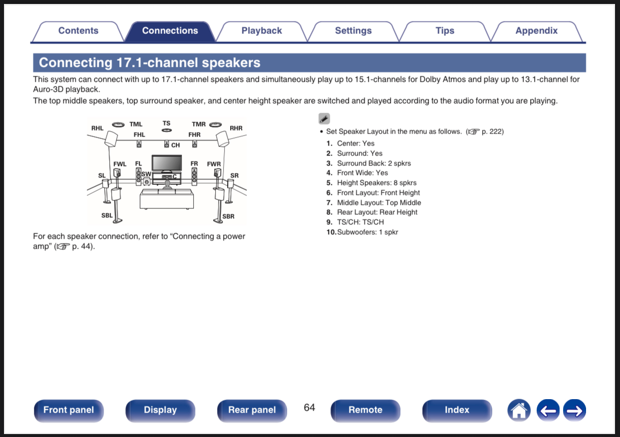

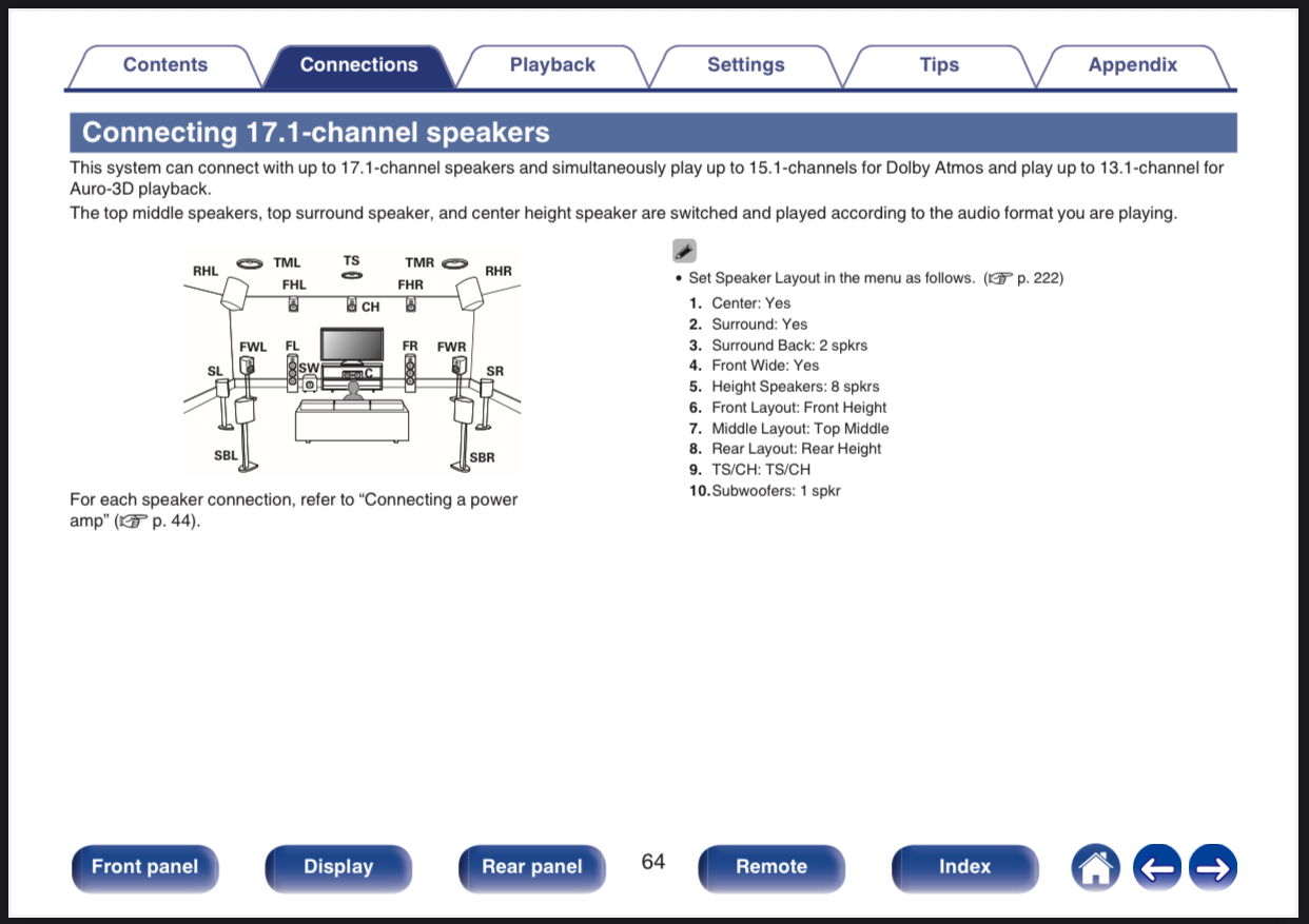

Now, for those who want their AURO-3D cake and eat their Dolby Atmos too, The AV 10 supports 17.1 channel speaker connections for a 13.1(7.1.6) channel AURO-3D configuration and a 15.1(9.1.6) channel Dolby Atmos configuration and will switch the output speakers accordingly based on the audio format.
When wanting both an AURO-3D and Dolby Atmos speaker configurations, the AURO-3D configuration will be compromised as SHL and SHR speakers will be replaced with RHL and RHR speakers. Dolby Atmos Top(Ceiling) speakers will be limited to the TML and TMR speakers. The Front and Rear Height speakers will be FHL, FHR, RHL and RHR.
Marantz AV 10:
This is a pisser for those wanting matching sets. The AV 10 supports 17.1 connections but the Amp 10 powers 16 channels. Those wanting 13.1 channels using the AV 20 are also f#%cked as the Amp 20 powers 12 channels.

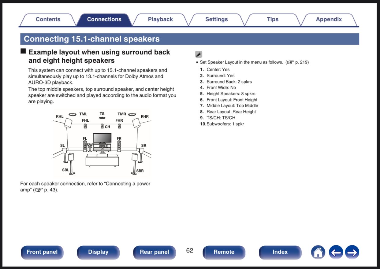

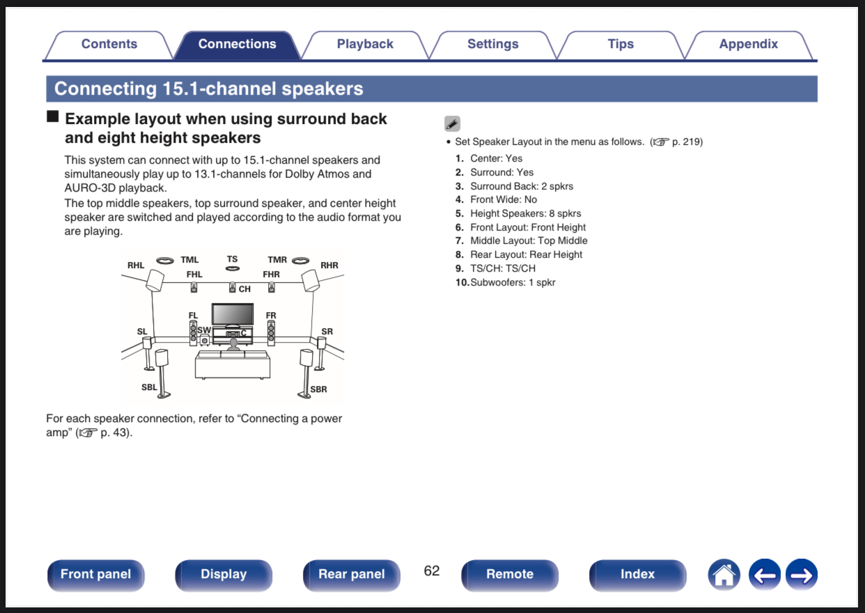

Now, for those wanting 13.1(7.1.6) for both AURO-3D and Dolby Atmos, the AV 20 supports 15.1 speaker connections. The same Height speaker limitations from the AV 10 would apply here.
Marantz AV 20:
In case anybody is wondering, while the Denon AVR-X6800H and Marantz Cinema 30 do process 13.4 channels, they do not support 15.1 connections like the AV 20 or 17.1 connections like the AV 10 and AURO-3D is compromised more still when configuring for both it and Dolby Atmos.
Finally, for those wanting separate AURO-3D and Dolby Atmos 13.1(7.1.6) speaker configurations and a pair of new Marantz components, the AV 20(15.4 channel processing) and Amp 10(16 channels of power) will get it done… for a hefty price.

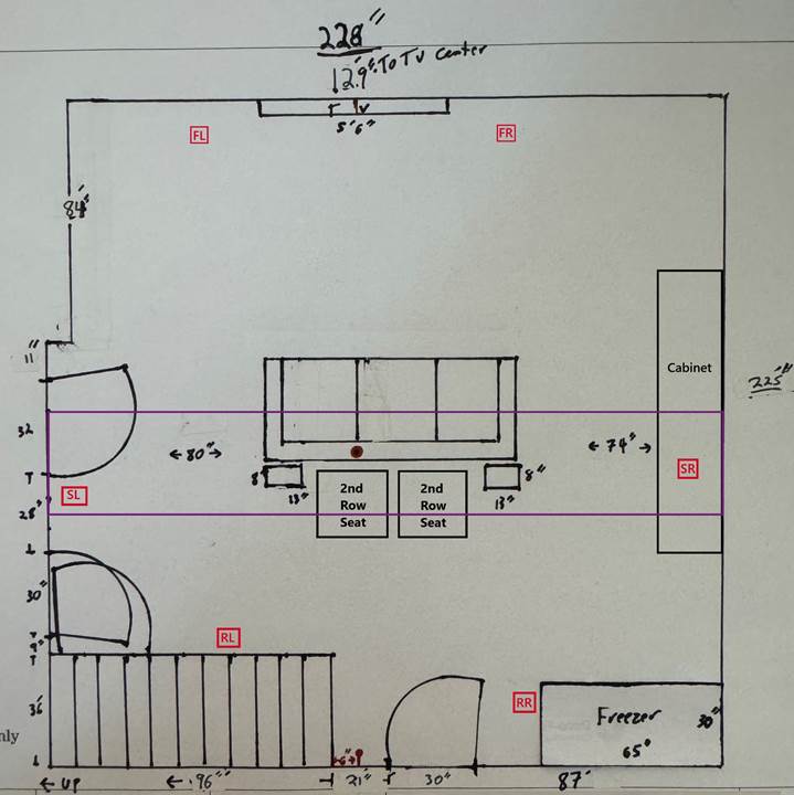

Excellent points. However, I’m specifically choosing to put my height speakers at 30 degrees. This is within the Atmos ceiling angle specs. Honestly I think this makes more sense that 45degrees.
If you imagine the atmosphere encoded with object based source, that is laid out in a square box. If the sound engineer puts a sound where the side wall and ceiling meet, then that’s where the sound should originate. That’s where your speaker should go. If your speaker is off the wall in-ceiling, then the sound source is shifted away from the wall/ceiling intersection.
I found this video from TechnoDad that cooperates this perspective:
Is this going to be noticeable? Maybe not. But I suspect that the soundstage would be significantly wider if you put the speakers wider. Dolby even came out and said that 30 degrees was a fine angle for peek performance. I suspect the reason they pushed so hard for a steeper angle was because of the Atmos-Auro3D law suit.
However, I’m an Auro 3D fan, so that’s my plan. Also, my space doesn’t need Front Wides. Worst case I’ll miss out on rear in ceiling atmosphere speakers.
Next, if you look at my room map (below), you’ll see two rectangles behind the couch and to the left/right of the 2nd row seats. Those are support columns. They block the angles right where my rear surrounds want to go, therefore my rear surrounds ended up being much closer together. Also, the purple lines are a lowered ceiling (which adds to the difficulty of getting good acoustics). As such, rear in-ceiling or rear heights wouldn’t work well. Or at least not well enough to justify the expense/effort.
Last, I like the Denon x6800h because in the future, if I REALLY do go with separates, it has 2 enhanced modes:
Mode 1. Turns off all of the processing and run exclusively as an external amp for another AVR. Effectively giving me an 11 Channel external amp.
Mode 2. Turns off all amps, isolating the Pre-outs to pair with external amp(s). Similar to a Marantz separate. Granted the Denon 6800h has WAY less copper plating for isolation and grounding, but I suspect that it is minimal.
I do have concerns that if I got a Denon x4800h and external amps, I would have buyers remorse and want to add a VOG and front height speaker.
If I wasn’t getting the denon x6500h for $3k then I wouldn’t be considering it. Still open to other opinions if anyone can offer a good 13 channel pre-pro for under $2500, that I can pair with $2000 of external amps.

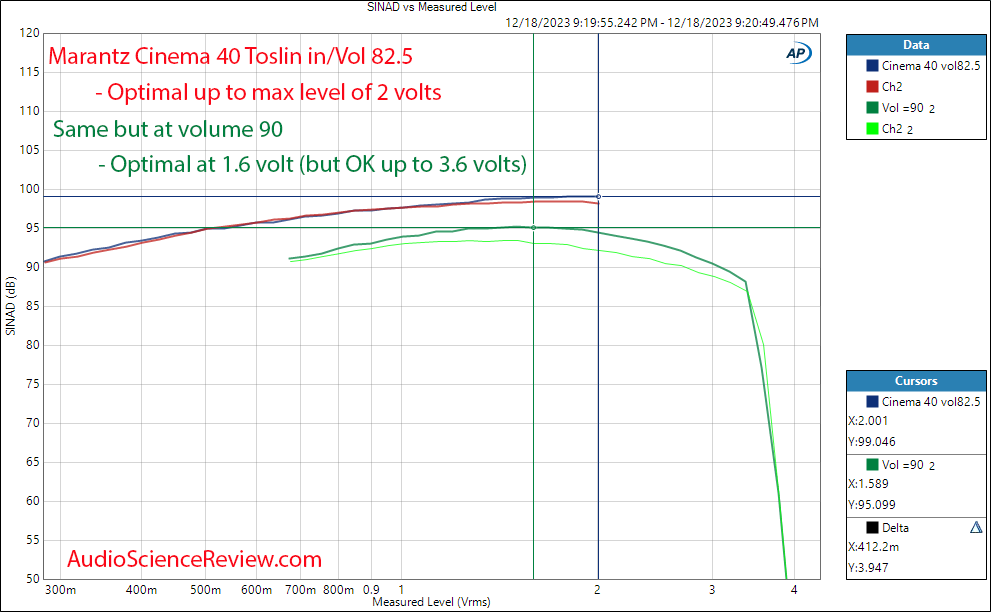

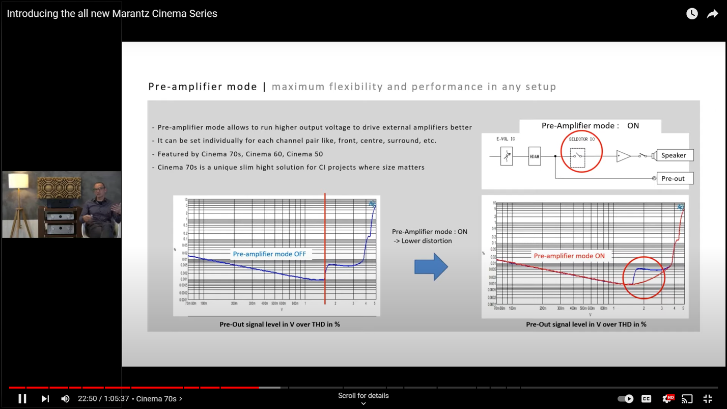

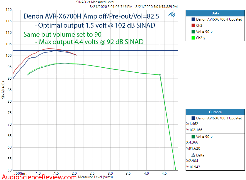

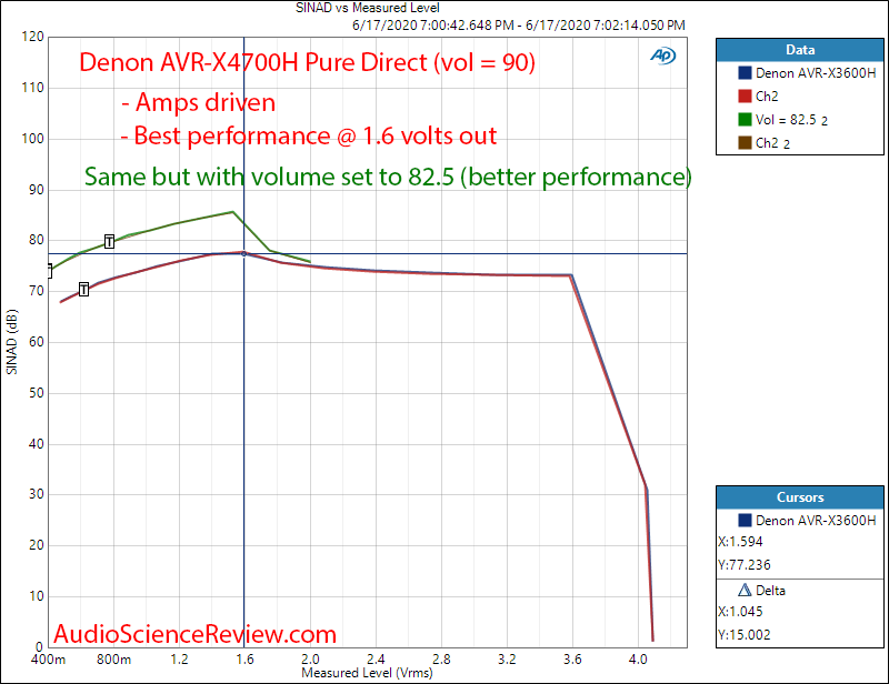

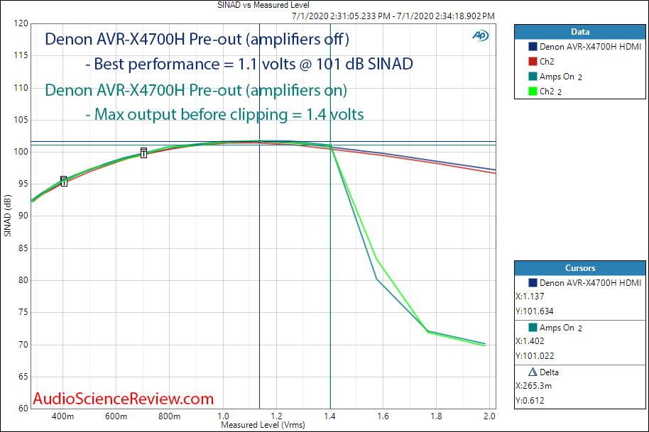

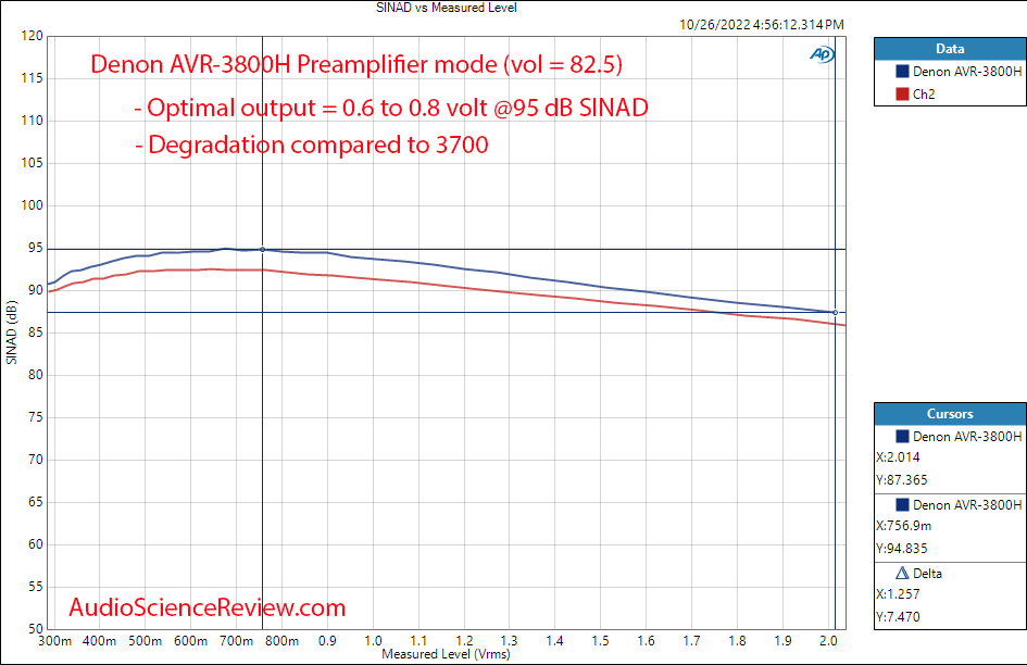

Keep in mind if you go to amp separates that the Denon can output about 2v during max output before distortion starts to rise so you want a amp that can reach full output at something around 1.6v for synergy and clean sound.
I'm with Peng on the output voltage thing....but how does amp sensitivity translate to "synergy"? How do you define synergy?
PENG

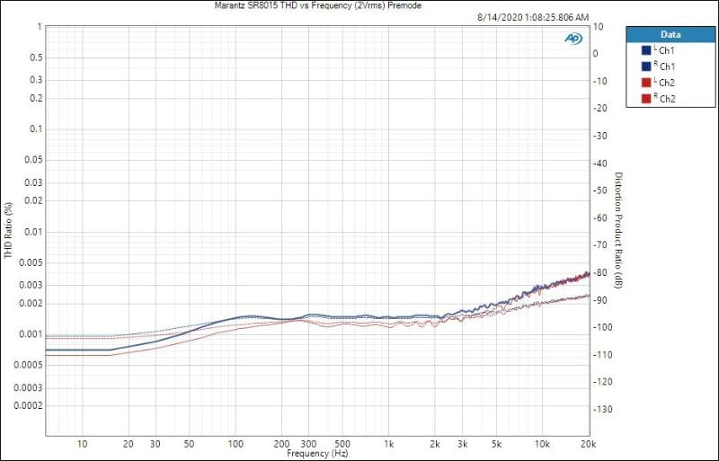

Now that the AVR DAC topic is brought up I would suggest people don't go by one single SINAD number but look more careful on a curve such as the following:
There are quite a few published on ASR and also a few on Audioholics.com, as well as Masimo/Denon/Marantz:
Note: below are just links to some examples, if you search for more you will find more, regardless, we can see that there are plenty of evidence that indicate Denon, Marantz AVRs can output enough voltage to drive most power amps including those with relatively low gain, say even down to 23 dB (or less depending one's speaker sensitivity, seat distance, and their max spl needs). So, time to stop worrying about not high enough pre out voltage if your choice happen to be one of the recent mid range D+M AVRs.
Audioholics.com:
Denon AVR-X3300W 7.2 Atmos/DTS:X A/V Receiver Review
Denon AVR-X3300W Preamplifier Measurements
One thing I really love about Denon receivers is they NEVER skimp on their preamp out circuits. Like past models, the AVR-X3300W had an ample amount of drive. I measured a whopping 4.5Vrms unclipped output, which is more than double the voltage needed to make virtually any amplifier reach full rated power.
Marantz SR8015 11CH 8K DTS:X Pro AV Receiver Review:
When driven to 2Vrms, the SR8015 exhibited excellent distortion results via the preamp output. THD+N was below .003% for the entire audio band and I saw similar results even when driving the preouts to 3Vrms. This is a clean preamp with plenty of output drive.
