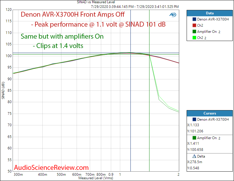

With regards to choosing an external amp to power the Denon X3700H I've been told that it's very important to get one with a specific sensitivity that will match the Denon's pre-out voltage gain. I had wanted to get the Rotel RMB1585 to pair with the Denon's.
The output signal from the 3700 in preamp mode is optimal at 1.1 volts and clips at 1.4 volts, meaning that ideally one would want to match it with an amp with an input sensitivity of 1.1 volts, meaning that with 1.1 volts of input is enough to drive the amp to it's full output power. The input sensitivity of the Rotel RB 1585 is 1.9 volts, meaning that it takes 1.9 volts of input signal for it to amplify that signal to it's full rated watts/channel. IF an input voltage to an amp is less than it's rated sensitivity, the amp will not come close to amplifying the signal to it's rated wattage.
Is my conclusion correct?

You are overthinking this a bit. because the db scale is log, that 0.5 volt discrepancy is not great. So you would in fact be fine.
The real problem is that receivers do not have enough head room on the preouts.

So do you think the Rotel RMB1585 will work as a power amp to the Denon? I don't wanna end up with the Rotel's and not having to be able to use its max capacity. Ive read a lot of people saying that adding a power amp to their existing AVR's didnt do much improvements.

Over at ASR they measured a sinad of like 96 or 97db and that's at 2 volts from the pre outs on the 3700. Btw those numbers are of the very best among avr's. You should go there and read the review, it's well done and thorough. You will be fine with the Rotel.

Whether that will help or not depends on other factors. As for the input sensitivity being 1.9V, it is not going to be an issue for the X3700H especially if you are not going to be using the AVR's built in amps. If you are, then you cannot use the preamp mode, and in that case the pre out would have higher THD+N, about -77 dB, that is 0.014%, still a reasonable to the Rotel amp's 0.03%. Even if you are using the preamp mode, you can still use the amp assign function to disconnect the internal power amps for the front left and right channel and then you will back to the 93 to 101 dB SINAD range from very low output to rated output level.
93 dB SINAD is 0.0022%
101 dB SINAD is 0.00089%

Below is Buckeye's response asking whether the X3700H is capable of driving external amp's that have an input sensitivity of +1.4V.
Reading Amirs review for the X3700, one need only worry about matching an amp that has an input sensitivity at or below 1.4v if you are using the amp for any speakers beside the fronts:
"So when selecting an external amplifier for channels beyond fronts, make sure it can output its maximum power at or below 1.4 volts"
That said, the NC252MP modules have a maximum power output when the input signal is 1.66Vrms (sensitivity) so there will be almost no audible impact if they are fed a signal of only 1.4v.
Depending on your speakers impedance, the 252's would give between 140-250w per channel.
1) My understanding from what Amir reported in his testing is that the Denon will output 2V (a standard value) if only using the preouts for the front LCR speakers and some of the internal amplifiers are used for surround speakers. But if you used external amps for all of your speaker and therefore none of the internal amps are being used, then the output voltage will drop to around 1.4.
2) You absolutely DO NOT need an amp that requires 1.4V or less. It's not a brick wall value. If you hooked up an amp that is listed as 2V input sensitivity and the Denon is still putting out 1.4V, the amp will work normally but it will just mean it can't get as loud as expected. And for such a small voltage difference we are talking about maybe 2dB difference.
Simple answer: if you used a Hypex NC252 that is listed as 1.66V and could only get the denon to output 1.4V, the amp would be only 1dB less "loud" at maximize volume compared to if it was being supplied 1.66V
3) So no, you do not need an amplifier with an input sensitivity of 1.4V or lower. The Hypex NC252 would work just fine.

Just for clarity, the pre out is actually capable of a little over 4 V maximum. Gene mentioned it, and Amir has measured it up to 4 V. The 1.4 V thing is, based on ASR's tests, that's where you can expect the highest SINAD, if the internal amps are connected, it will go higher as you turn the volume up, and/or the input signal increases with the media contents (music, explosions in movies etc..), but distortions will increase, that is SINAD will drop. So again, it is not like the pre out would somehow be limited to 1.4 V, amps connected, or 2 V amps disconnected, but SINAD would increase as the output voltage increase.
Pictures better than a thousand words, so take a look of the graphs below (noted that SINAD is the inverse/reciprocal of THD+N, that's why the two graphs look sort of inverted to each other):
The one posted by Gene:
Denon AVR-X3600H 9.2CH IMAX Enhanced AV Receiver Offers Best In Class Features | Audioholics
The one posted by Amir/ASR:
Denon AVR-X6700H AVR Review (Updated) | Audio Science Review (ASR) Forum
