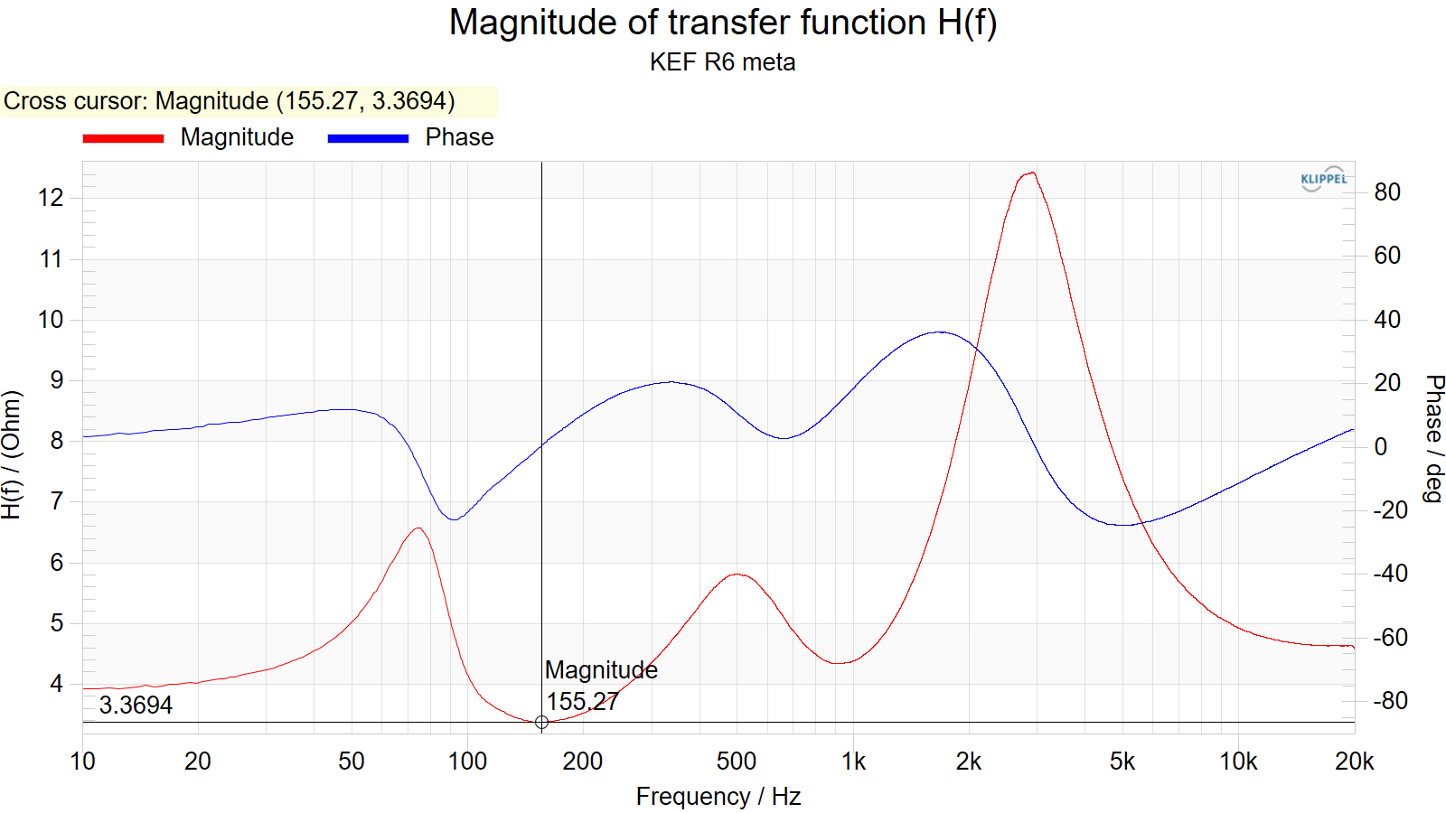

The R6 in particular is a very nasty load, going to 2 ohms at 180 Hz right in the power band. That speaker looks like a real amp buster. So bridged the amp will see 1 ohm in part of the power band. The R7 is not much better dropping actually below 4 ohms in the most power hungry region of the audio band. In other respects they seem very decent speakers, but I bet they have blown a lot of receivers and amps.
I don't know about R6, but the OP has the R6 meta, and that we have the official data from KEF, as follow:
R6 Meta | KEF Canada
NOMINAL IMPEDANCE
4 Ω (min. 3.2 Ω)
The actual measured value was a little better, minimum was about 3.4 ohm, that's a lot better than 2 ohms that you might have mistakenly read or assumed?
The R7 meta has very similar characteristics, and the non meta series typically would do better based on what I remember.

So we both know worse case scenario, 100 W 8 ohms, 160 W 4 ohms, would mean at least 80 W 2 ohms, and that's with 6 channels operating, and the numbers are for continuous sine wave signal, we also both know full well that music signal is not "continuous" sine wave, not even close, so for practical use, the MC7106 will have no trouble doing 80 W into 2 ohms, 40 W into 1 ohm and likely much more as I am using worst case scenario here.
So, now that you know the above facts, you might agree with my advice too, though you obviously have to know my "advice" is based on the OP's obvious preference of the Mc amp to his Emotiva amp so I don't want to give him an unqualified "No" answer, because factually speaking, if you happen to someone who can't stand reference level and 15 to even 20 dB below reference is good enough for him, and that he seat no further than 3-4 meters, the MC 7106 will have enough juice for those 4 ohm nominal speakers that dip below 4 ohms, to 3.3 to 3.5 ohm minimum briefly in the range 100 to about 260 Hz (that's not even 2 octaves).

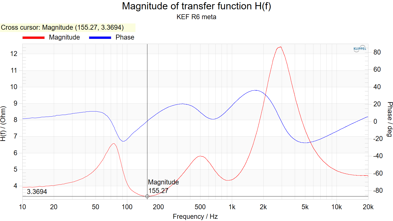

NOMINAL IMPEDANCE
4 Ω (min. 3.2 Ω)

OK, I read the impedance curve from the graph plot, but half and ohm is neither here nor there.
The issue is that the manual says not to do that. I think that is reasonable advice. On the whole I am against bridging, and consider it a risky endeavor. So the safest course is not to do it in this instance. I guess we will stand by our advice, and I stand by mine, which is don't do it.

To the OP, if you want to go ahead, make sure you know how to make the connections and it is very important to determine you actual "power" need, or tell us your seating distance as well as you desired max SPL you think you would ever listen to. Reference level is 85 dB average, that would be too loud to most people as it would sound as loud as one would hear watching a Star War THX movie in cinema that follows THX standard/guideline.
If you listen to a maximum of say 10 dB below reference, you need would be 1/10 of what you would need to listen to reference level. For me, I rarely go above 15 dB below reference, and even lower for music listening but ommv.
One of the often linked calculator that is easy to use is this one:
Peak SPL Calculator
For speaker sensitivity, instead of 88 dB for your KEF R6 and R7, enter 85, to allow for the fact that they are more like 4 ohm nominal speakers.
If you required amp power output is less than 100 WPC then the MC7106 should be very capable of driving your speakers for you need.
Manufacturers will always tell you not to drive speakers below certain impedance values such as 4 ohms for alleged/speculated reasons that will take a page or more to discuss.
Simple case in point using extreme example, many tiny satellite speakers and/or sound bars are rated 4 ohms or less, what kind of amps you think people use to drive them, I guess we, including TLSGuy and HD know the answers lol..
To be clear, I agree with such a conclusion based on the very reason you cited. My original point has been, among other myths that continue to flood internet audio hobby forums, some of us who know the truth (at least relatively speaking) should do more than the blanket statement approach.
Peak SPL Calculator
All the soundbars I have seen have their amps inside and are essentially active speakers.
