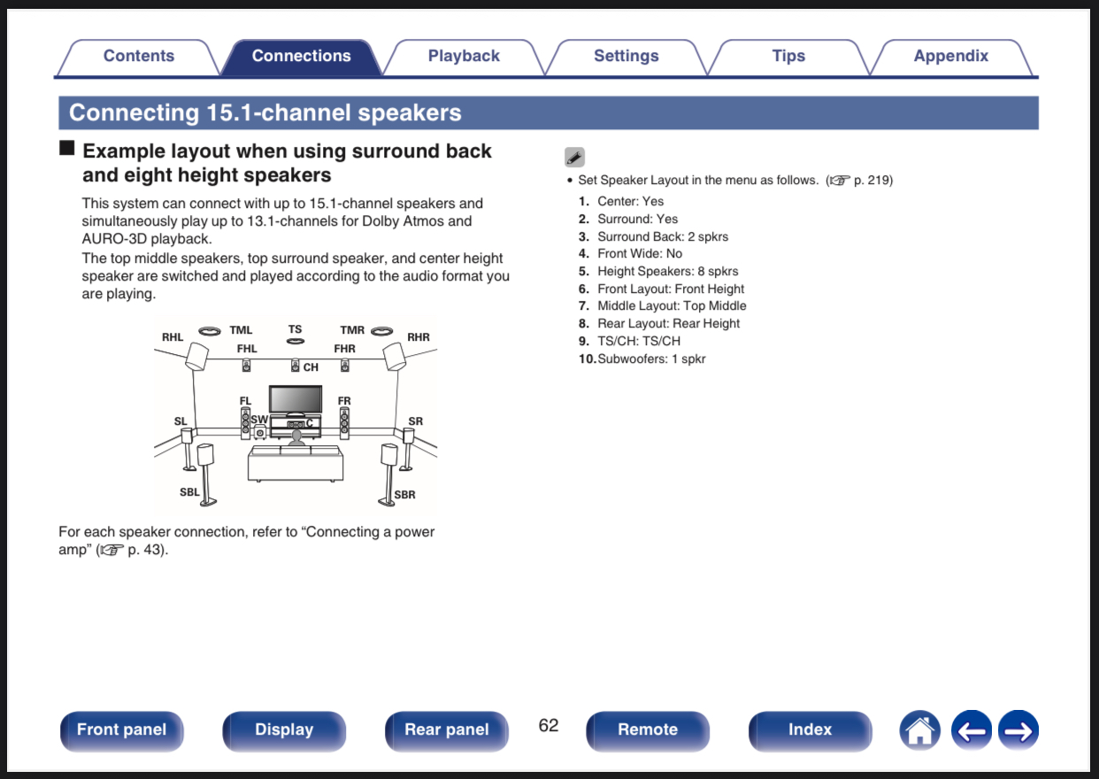

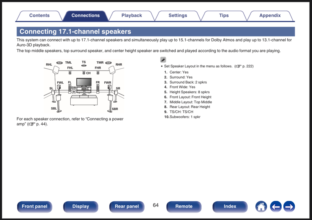

Now, for those who want their AURO-3D cake and eat their Dolby Atmos too, The AV 10 supports 17.1 channel speaker connections for a 13.1(7.1.6) channel AURO-3D configuration and a 15.1(9.1.6) channel Dolby Atmos configuration and will switch the output speakers accordingly based on the audio format.
When wanting both an AURO-3D and Dolby Atmos speaker configurations, the AURO-3D configuration will be compromised as SHL and SHR speakers will be replaced with RHL and RHR speakers. Dolby Atmos Top(Ceiling) speakers will be limited to the TML and TMR speakers. The Front and Rear Height speakers will be FHL, FHR, RHL and RHR.
Marantz AV 10:
This is a pisser for those wanting matching sets. The AV 10 supports 17.1 connections but the Amp 10 powers 16 channels. Those wanting 13.1 channels using the AV 20 are also f#%cked as the Amp 20 powers 12 channels.
Now, for those wanting 13.1(7.1.6) for both AURO-3D and Dolby Atmos, the AV 20 supports 15.1 speaker connections. The same Height speaker limitations from the AV 10 would apply here.
Marantz AV 20:
