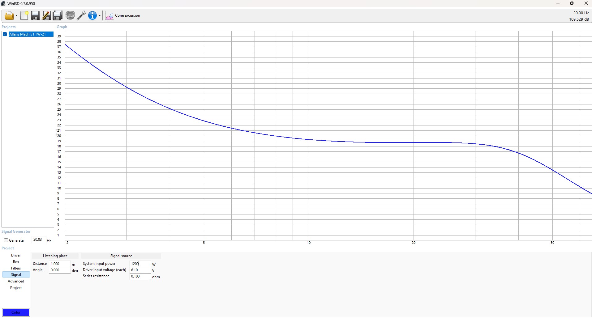

I appreciate your feedback and experience, but I have a few questions about your findings as they differ significantly from my own modeling.
  • Xmax Discrepancy: The manufacturer's website lists Xmax at 29mm, but your data shows 34mm. Could there be a typo in your parameters? One small key difference might be the enclosure volume. My net internal volume is 6.2 cubic feet (6.6 gross minus 0.4 for driver displacement and bracing), whereas your model utilizes an 8.2 cubic foot enclosure. This larger volume somewhat explains why your model shows higher excursion.
  • Graph Scale Contradiction: Your cone excursion graph cuts off at 18mm, though it should scale to at least 29mm or 34mm based on your data. Because the graph stops there, it shows 18mm of excursion at 6 Hz, which directly contradicts your claim that the driver runs out of excursion at 15 Hz.
For comparison, I modeled this in WinISD with 1,200 watts of input power and triple-checked the data. My graph shows 19mm of excursion at 20 Hz and 10 Hz, peaking at 23mm at 5 Hz.
Additionally, the designer confirmed this sub can play down to DC (0 Hz). I have also personally verified four of these units playing down to 10 Hz via a calibrated microphone and SPL graph. Given these gaps, I respectfully disagree with your conclusions and would love to figure out why our models don't match.

So, here is your model. I did put the correct x-max in my previous model.
With the reduction in box volume below the optimal sealed volume, there is some degradation. The native F3 has moved up to 44.97 Hz, and so Eq will need to be increased. So maximum acoustic power at 20 Hz is 115 watts. which will produce 112 db. at 1 meter. You need to high pass the driver and cut it off at 20 Hz, otherwise you certainly risk driver damage.
The good news it that these will still be very good sealed subs and well to the top of the pack.
Pursuing infrasonic frequencies is not a fruitful endeavor, and risks damaging your drivers, which would be a pity, as to me at least they appear to be excellent drivers for sealed application.
So, 12 db. per octave boost starting at 44 Hz and high pass them at least 12 db. per octave at 20 Hz. That should give you nice subs that have a good long life.
Thank you for adjusting the model for the box size. However, you did not answer my questions and instead focused on personal opinions.
Your model lists XMAX at 34mm, but the Mach 5 Audio website explicitly states 29mm of one-way linear travel. Furthermore, your model shows a cone excursion of 17mm at 5 hz, yet you claim the driver will suffer damage below 20 Hz. This is contradictory, considering XMAX is 29mm.
Many users run these subwoofers down to 10-15 Hz without issue, and I have personally seen an SPL graph confirming this level of performance. In fact, the subwoofer's actual designer states they can play down to 0 Hz (DC).
This type of misinformation is exactly why you faced pushback earlier in the thread. What concerns me most is that I have entered the exact same data into my own modeling software, yet we are seeing completely different results. While I appreciate your time, I need factual, consistent data rather than personal opinions to find this credible.

The first issue is that the high pass filter will not be a brick wall. The usual slope is 12db/octave so the sub would not be 12db down until 10 Hz. and only 6db. down at 15 Hz, which with room gain will give you good output to 15 Hz. All sealed designs should be high passed at around 20 Hz or higher, as the boost can get very destructive of the drivers. So, the model shows that you will have very good strong bass and hopefully units that will stand the test of time. Whether xmax is 29 or 34 mm is irrelevant as you are not going to get the driver close to xmax. Even if you drove it down to 12 Hz you still would not run it out of X-Max. However, you can see that below 20 Hz and especially 15 Hz, output is not increasing as power is increased. So, the right design is to high pass at 20 Hz. The drivers will thank you! As with the design, max cone displacement is around 15 mm. Chasing those sort of low frequency numbers is not wise or sensible. I have given you a good design and it will do everything you desire, and be reliable.
Please keep in mind that my build uses four of these subwoofers. According to WinISD, applying 1200 watts per sub increases the 5 Hz SPL from 85 dB (single driver) to roughly 97 dB. At 10 Hz, the four-sub array reaches 110 dB. This represents raw output, as I have not yet factored in room correction or cabin gain.
Your modeling still contradicts the evidence. The designer and manufacturer explicitly stated these drivers can play down to DC, and he certainly understand the mechanical limits better than anyone. Between the designer's specifications and real-world feedback from users successfully hitting 10 Hz, your conclusions simply do not align with the facts.
