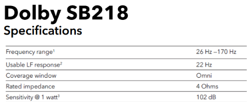

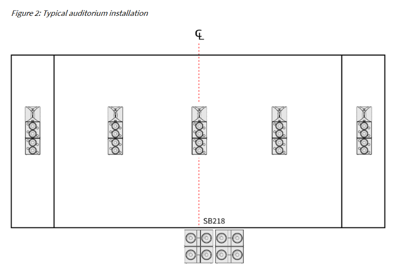

Percentage of professional commercial cinemas in the US, including THX and Atmos certified, with subwoofers capable of appreciable output below 20Hz: 0%
Of course to cater to the "Mines bigger than yours" market there are home subwoofers that supposedly go even as large as 80 or 100", however the way real deal commercial cinemas approach high output is multiple 18" drivers clustered together to take advantage of a principle called acoustic coupling and they are often mounted just below the screen and slightly off center (so the wall slap reflection from the left wall and right wall will differ rather than reinforce each other)..
In a Dolby Atmos theater, for example, you might be hearing a cluster of these 18" drivers:

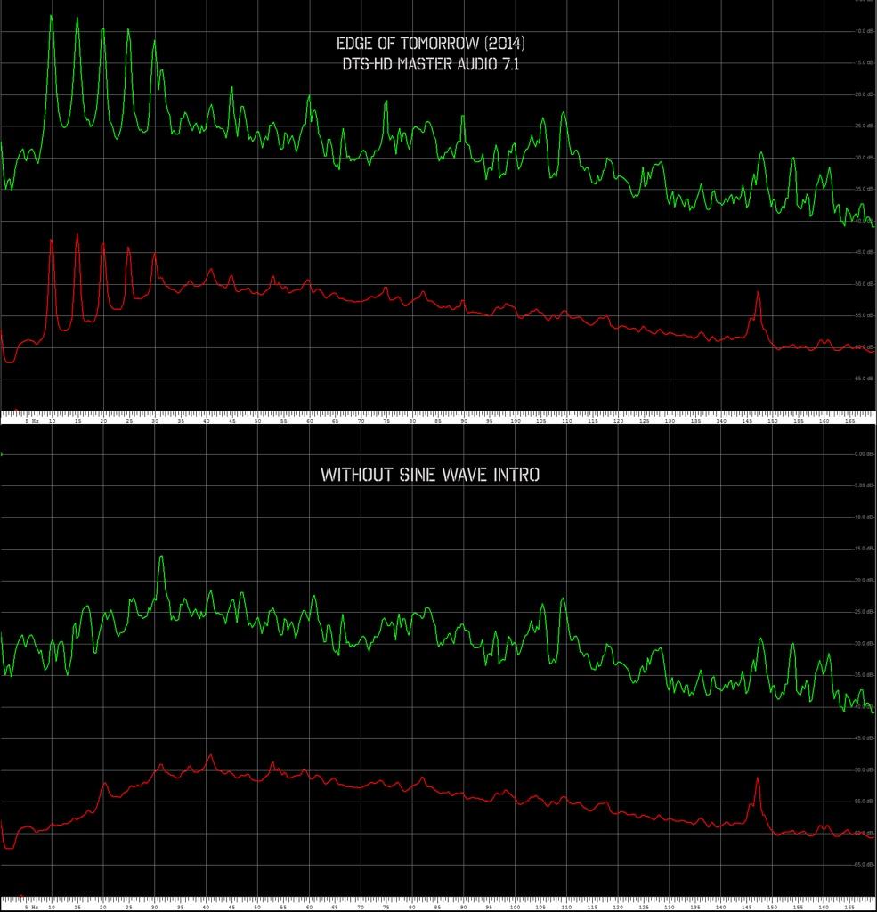

You mean the early releases before they realized they f'd up. . . . so they filtered away the sonically detrimental infrasonics for the subsequent releases to correct their blunder? Nor heard squat from in their own, professional production rooms in the first place? . . . And which now two fellow forum members have indicated they experienced no difference with the newer release UHD filtered version during that critical moment?
One:
. . . it most certainly still has an absurdly deep bass tone going off that is only felt or heard by the walks of the basement creaking and cracking. I've found no difference at all between the BR content and the UHD's.
Two:
I bought the UHD and felt it was identical also.
Sure, maybe the only reason they couldn't notice a difference is because they don't own 100" subwoofers. Or because what you really need is a either a 200" subwoofer or a cluster of more compact ones, but isn't a simpler explanation that what I wrote here is actually correct?
That opening note is deceptive though because exactly when the loud infrasonic tone hits so does a non-controversial loud bass tone around 30Hz !
And sure enough, after I wrote this we were shown that full length movie spectral plots indicated that 30Hz tone I specifically warned about was indeed still intact in the later releases:
And sure enough after I wrote this we were shown that full length movie spectral plots indicated that 30Hz tone I specifically warned about was indeed still intact in the later releases:
The explanation for that is simple enough. The new vs old graphs don't show that very low stuff is completely gone, just not as boosted as the first. There would still be that deep rumble and if the system isn't capable of producing it at full intensity anyways, the difference probably isn't that noticeable. In a system with a sub more like the one the OP is constructing, it would probably be much more noticeable.
