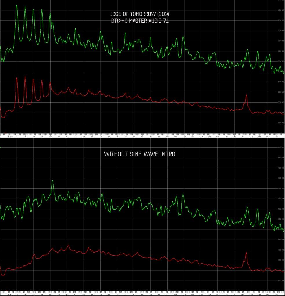

The question is not what some individual's system/EQ/sub/speakers/placement/room/mic does but what does the old vs. new versions of the movie provide natively when measured directly (electrically/digitally, not acoustically).

Here’s one that I could find.

Maybe they should start marketing subwoofers as "Edge of Tomorrow early release version ready".

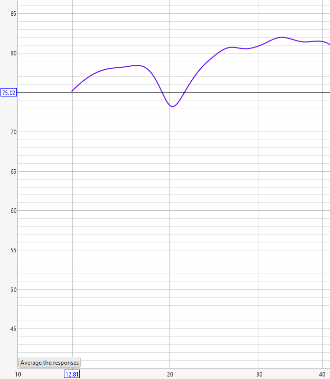

Took a look at my REW graphs for the theatre post ARC and tweaking:
Aside from the null at the listening position around 21Hz, it is holding the 75db or better reference level all the way down to ~12.5Hz. Better than I remembered. I'm not sure if that roll-off gets a lot steeper going forward but I expect it probably does put out a modestly "feelable" 8Hz if asked too.
I typically do my sweep 10Hz - 21kHz and the mic starts picking things up through the audio stack after the first few Hz.
To the OP: There doesn't look to be a hard cut-off in output below 15Hz with this ARC tuning - just the normal rolling off of the sub I'd expect when asked to go lower than it's optimal range. This is coming off of an AVM70 8k.

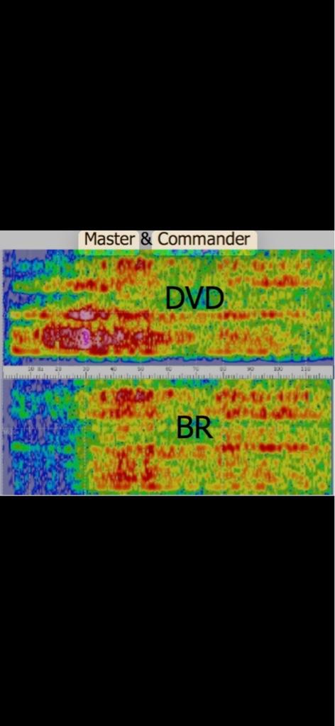

Some format releases aren't necessarily same as others. I seem to remember seeing measurements of ulf content in War of the Worlds on dvd being better than the bluray release....but been a long time.
Master & Commander is the main one that people complained about, saying the BD neutered the ULF of the cannons. The dts DVD has far more bass dwell than the dts-HD MA track on the BD. That may simply be that the audio on the DVD was over-boosted and the BD cleaned it up. People were hoping the UHD would make it more like the dts DVD, but it did not.
Yes, sounds familiar. Hard to know about the mastering done for any particular version unless someone measures it.

There were definitely others, but Master & Commander seemed to get the most people up in arms.
I just found the dts DVD for $1.58 used and ordered it lol.
Thank you so much for sharing this. It does at least confirm that there is no hard cut at 15 hz, using ARC genisys, which is awesome. There was another gentleman, elsewhere that confirmed this on his AVM90 as well. I cant say for 100% certain, but I feel its safe to assume my MRX 1140 should be no different with ARC Genisys.
