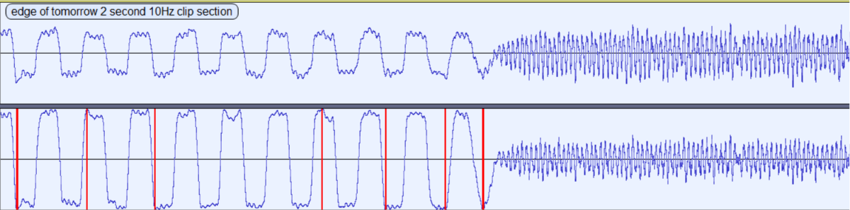

This EoT original release's square wave also shows some nasty clipping [depicted in red below] at least in this version I just measured:
