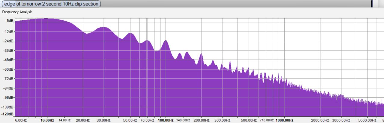

That opening note is deceptive though because exactly when the loud infrasonic tone hits so does a non-controversial loud bass tone around 30Hz !
It is convenient though that this happens in the movie's opening seconds so to get to it all you have to do is play the movie and BAM, it's there! It reaches its lowest point around 30 to 36s in, according to this YouTube scene:

It’s a 10hz square wave that nobody can agree on whether or not it was intentional. I’ve been in rooms that can reproduce it loud and clean. It’s not really necessary, but is pretty fun!
Edit: it’s also been removed the UHD versions. Hmmmmm….
dolynick
I test routinely with the UHD content and it most certainly still has an absurdly deep bass tone going off that is only felt or heard by the walks of the basement creaking and cracking. I've found no difference at all between the BR content and the UHD's.
Bingo. Evidence My proof that it is imperceptible the deep bass there can be deceiving (my point in my last post); and that the fun, deep bass there is the non-controversial 30Hz stuff not the 10Hz stuff they had the good sense to filter away for the later release.

Bingo. My proof that it is imperceptible; and that the fun, deep bass there is the non-controversial 30Hz stuff not the 10Hz stuff they had the good sense to filter away for the later release.
How can you say that? Dolynick even said his subs don’t go that low…
It’s been graphed. I’ll look for it later…
