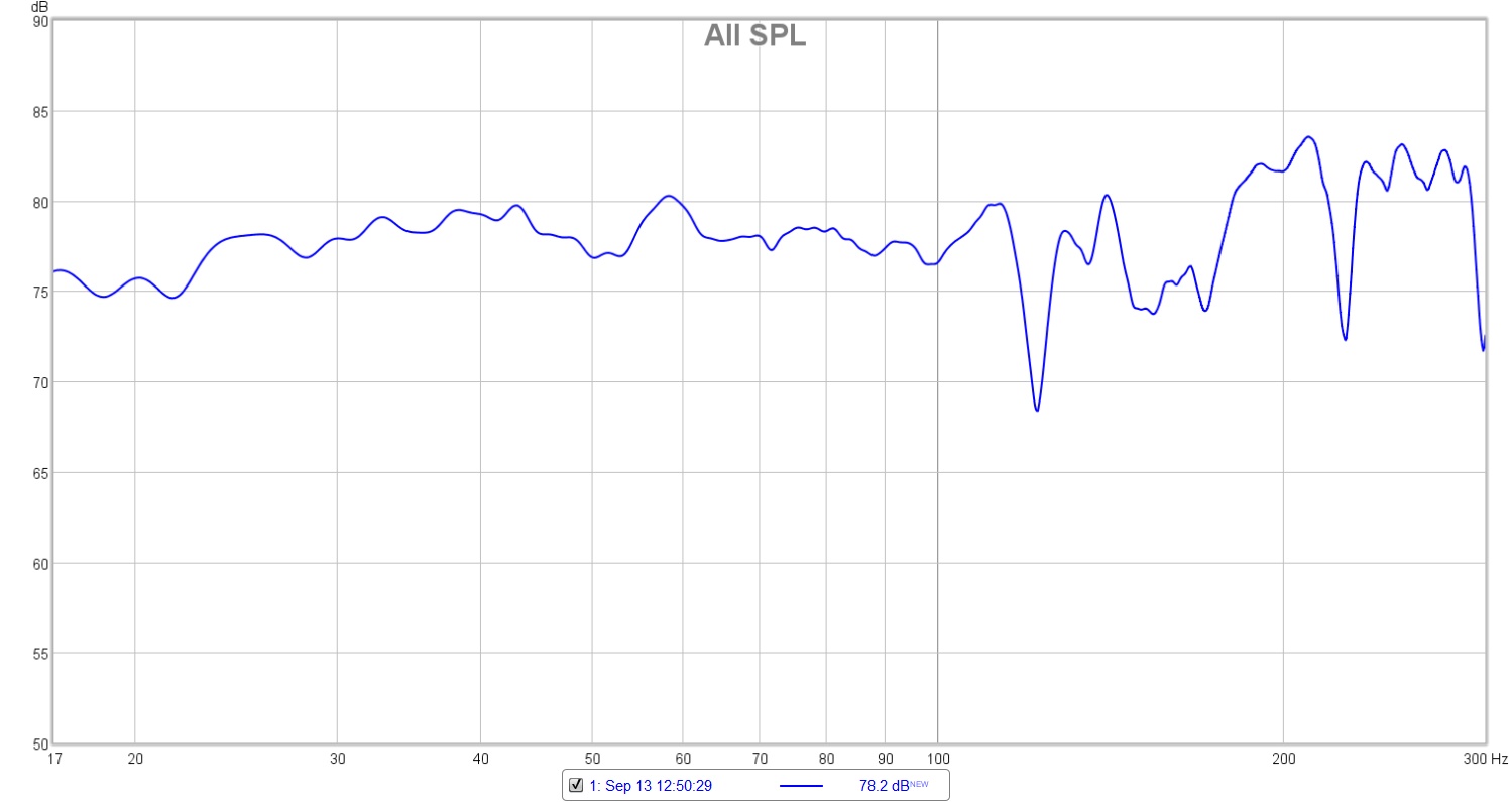

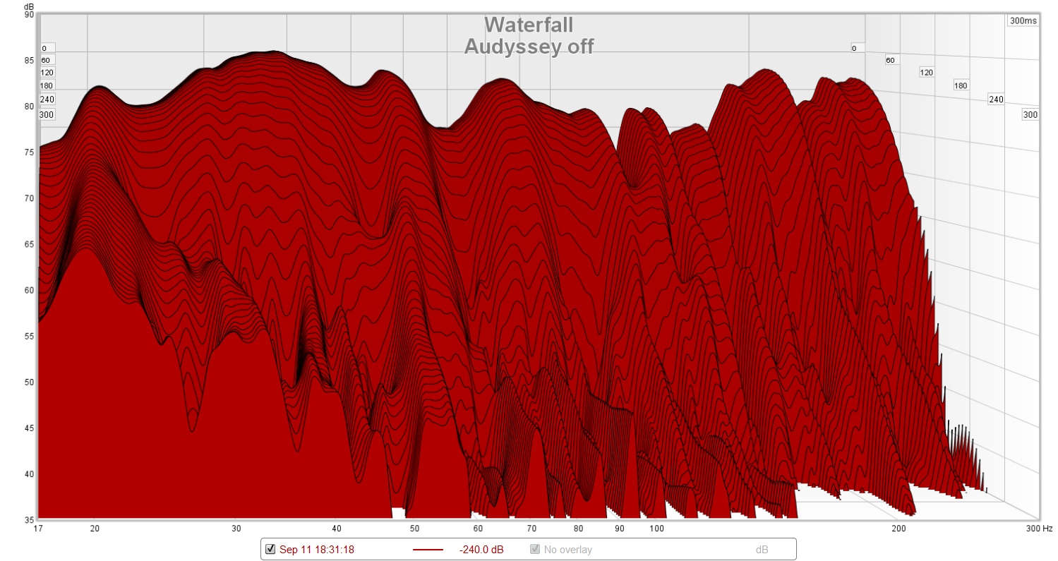

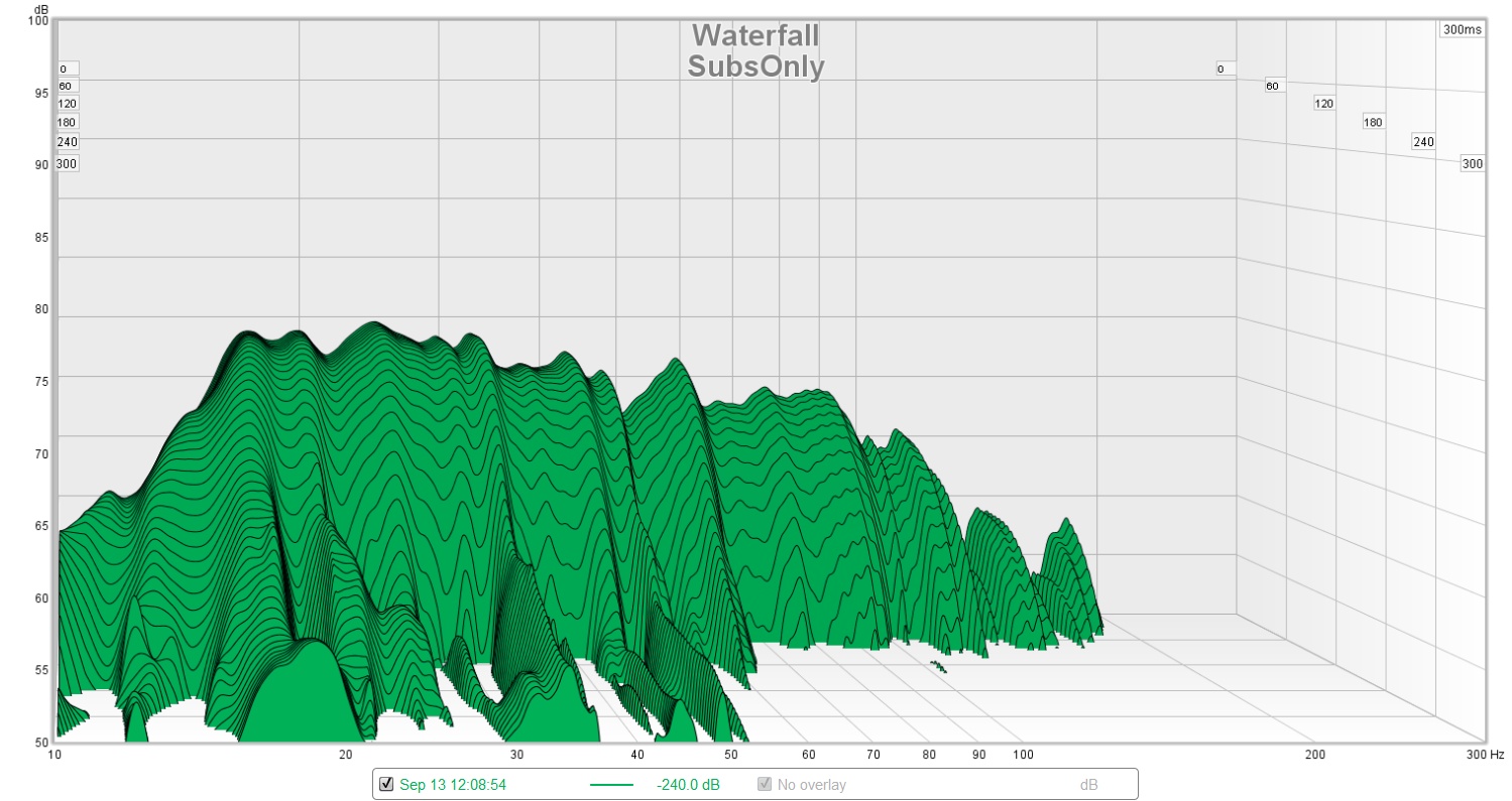

Here are the falls for Sub only and 7.1 (5 subs in total) channel, REW default setting.

Looks like 80. It's a subwoofer only measurement, no speakers. AVR crossovers are usually 24 or 12 dB slopes.

If this is a graph of a subwoofer rolling off at 12 or 24 dB per octave, then yes, there is something not right here because that subwoofer is not rolling off in any hurry and is going to continue carrying on and possibly canceling out some of what the towers are producing.

Can anyone describe the standard resolution of their waterfalls in frequency vs time that allows them to compare graphs to others, even in other rooms, that define waterfall's usefulness?
View attachment 22525 View attachment 22526 View attachment 22527

Then you do not know how to read that graph, but I’m not going to argue the color of the sky with you.
