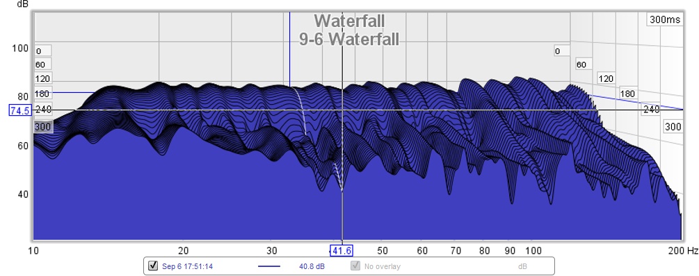

This is the waterfall from the same measurement. Not sure what to make of it.
Something is not right there!
First off, you need to determine the noise floor of your room! Usually 45dB is used, but should you have a pretty live room and something like HVAC or your fridge running nearby, that may not be the case. You can always measure it. This should be the minimum value assigned to your Y-axis. With the current 20dB you would likely never fall all of the way to the "ground".
But more concerning, you have a couple of latent "humps" around 30, 65, & 85Hz. The only way I could interpret that is the signal got louder after it had decayed. I suppose these may be reflections off of a wall, or something, but I never see anything like that in pro measurements; but maybe I am confusing outdoor measurements of subs with room measurements!
Lastly, around 120Hz, it looks like thing are steady with no downward slope. Either the noise floor in your room is close to 60dB at that frequency or you've discovered the makings of a perpetual motion machine!

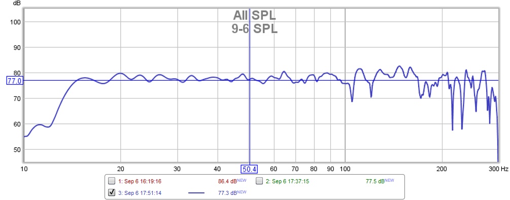

This is my in room response right now with no smoothing or room curve applied. It's also the graph to which TheWarrior was referring to when he said he could only assume my bass sounds bad, is full of bloat and I need to scrap the work I've done (with @ATLAudio's help) in these last 25 pages and start over.
I'm not seeing it? He keeps telling me that this in no way shows that I have a good bass response without measuring my asymmetrical room with vaulted ceilings and many uneven parallel surfaces to the nth degree. Am I doing something wrong? That's what I feel is being implied.
I think this is an excellent and enviable room response from a linear FR perspective. I'm confident Warrior is referring to things not shown by the averaged FR. Specifically, modal ringing and non uniform energy decay (time domain response). I suspect, he also believes the EQ used is heavy handed and messing up the phase behavior of the system.
I see there's a measurement of some sort below. Maybe they're more to illustrate from it. More to follow.
