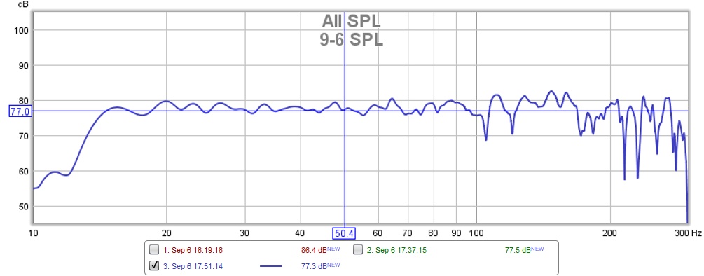

This is my in room response right now with no smoothing or room curve applied. It's also the graph to which TheWarrior was referring to when he said he could only assume my bass sounds bad, is full of bloat and I need to scrap the work I've done (with @ATLAudio's help) in these last 25 pages and start over.
I'm not seeing it? He keeps telling me that this in no way shows that I have a good bass response without measuring my asymmetrical room with vaulted ceilings and many uneven parallel surfaces to the nth degree. Am I doing something wrong? That's what I feel is being implied.

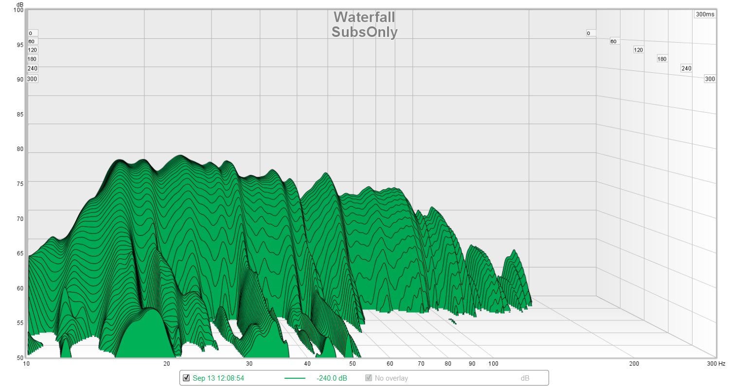

This is the waterfall from the same measurement. Not sure what to make of it.

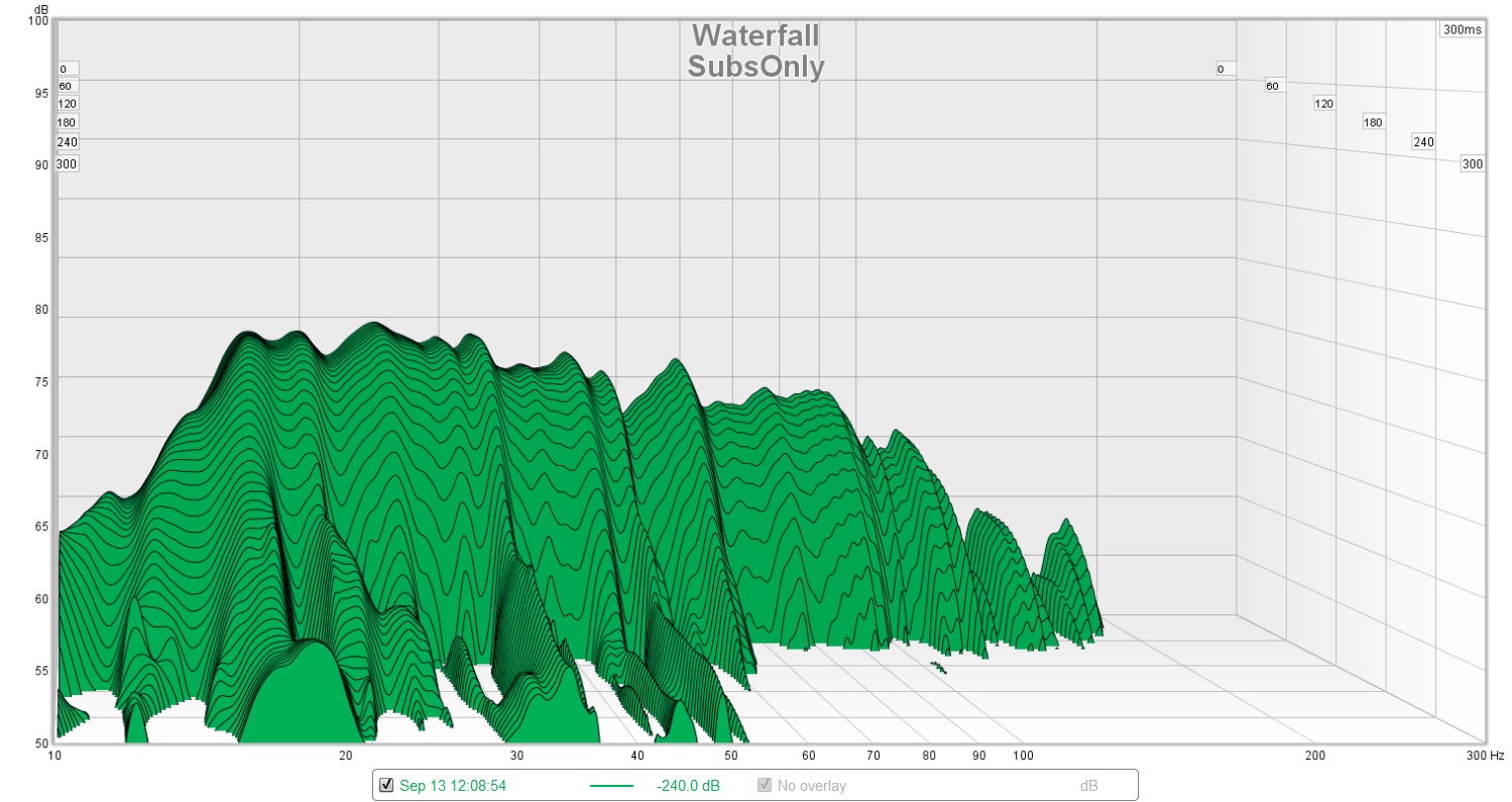

This is my Subs only waterfall:
The Z axis, marked 0-300ms are time slices. If you look closely, the line at 0ms corresponds with this,
Every subsequent "slice" on the waterfall represents the "FR" (residual sound energy plotted as frequency vs time) for that slice after the impulse tone was played.
What makes a good looking waterfall plot?
1) No frequency bands showing excessively long decay time. (Example, a persistent bump along all slices from 0-300 with minor drop in level.)
2) All frequencies showing even energy decay. (Even decay time results in "parallel slices".)
Have you tried the ETC plot? It is way easier to interpret than waterfall plots at the expense of losing amplitude resolution.
If you post the ETC plot for the above measurement, I'll correlate the three.

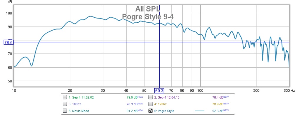

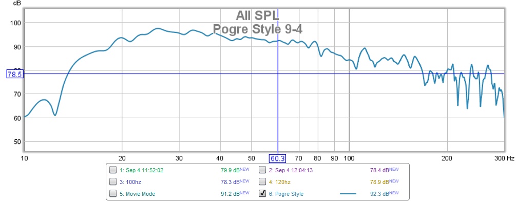

This is with my house curve. :p

That was subs only after running Audyssey. I assume Audyssey did the roll off in trying to integrate them with the other speakers. There are also dips at around 50 and 70 Hz due to the room, that Audyssey improved, but could not do more.
so, I'm not trying to muddy the waters but I told J I would share of my progress. this is post audyssey with +5 to the sub trim, and one with deq on top of that. It sounds great but I'm a little worried about destroying my subs with that much energy below 20hz. To my eye, i'm pretty flat to about 15hz which is great but thinking of putting a high pass filter down there. Maybe around 19hz where my subs are tuned.
Also, I tried posting my mdat file for anyone to peruse. It says the file is too large. ideas? I would be interested in someone going through it to provide insight. especially around that 50-60hz dip
