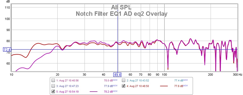

Okay dokey! After A LOT of help from @ATLAudio I learned my way around the mini much better. I made a notch filter! That, and played around with settings too. Got it tweaked in a little better I think. These are from this morning and includes my mains and subs in all of the sweeps.
Audyssey on
DEQ off,
Crossover 100hz
Then on the mini:
Uploaded filters from REW
+4db at 75hz
Adjusted Q to 5 to make it a notch filter
No smoothing.

It's not just pretty graphs either. This is the best I've heard my system sound. @Bucknekked is gonna have to come over again and check it out!
Wasn't without a lot of frustration, sweat and tears though. I have never ever ever done anything with eq outside of room correction. This is not for the feint of heart, but if you put in the time it's worth it. There's more improvement adding the mini than I thought there would be. I'm listening to some music right now with a big ol' grin on my face.

There is a fair amount I was missing before this. I'm listening to all of my music again. It doesn't just play really deep, it thumps you in the chest now. If you guys remember, at the start of this thread I said that my towers had more mid bass presence by themselves in direct mode that I wasn't getting with my subs on. That has flip flopped. The mid bass sounds better than the towers in direct with the subs on now. That was, ultimately what I was going for.
Everything I did was like a rough draft and I'm probably gonna redo it now that I'm much more familiar with the menus in the mini. Not today though... I'm gonna enjoy it for a while first!

I know the red is your final (for now) curve, but I'm not clear on what the purple curve represents!
KEW
KEW
His HSU subs with EQ2
With the miniDSP?
What do you attribute the improvement from 15-20Hz to?
That is the big difference, otherwise, I would consider the curves pretty equivalent (as in both excellent)!

Yeah, DEQ is off. I was going for flat. Of course now I have DEQ on and +6db for my subs. There's a house curve, trust me. Mebbe later I'll do a sweep.

Purple is eq2 on the Hsus. I started fresh this morning and re-did everything. I did stuff I wasn't supposed to mess with last night. yes, it's with Audyssey on, no DEQ
