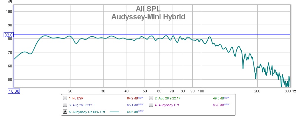

I'll check that out, thanks Bill. the last chard I posted, the hybrid, is that +/- 3db from about 120hz to about 15hz? Am I reading that correctly? That's really good, right?

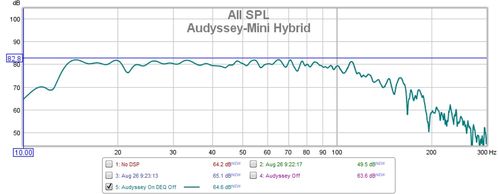

This is what I'm going with for now. I'm gonna get stuff cleaned up and put away. I have company coming over later to watch the fight.
I'm pretty damned happy with that. I can hear the difference too and loving it. 2 things Audyssey did that it's never done before. It made me turn the gains up on both subs (both are still under half way) and it set the distance for my subs at 17ft. It usually sets them at 13.9. that's not a complaint, I like the results. It's just way different.
*Edit: That's with no smoothing. I didn't even think to see what it would look like with a little smoothing.
That is a dream of a response. There isn't really much improving on that- that is flat. People with systems that cost many times that of your system do not have a response nearly as good. That looks to me like +/- 3 dB from 15 Hz to 125 Hz, and maybe even a tighter response than that. Congratulations!

Wut? lol. House curve? Isn't that what I just did?
What he said!
There may be some more tweaks you can do, but I feel pretty sure your system sounds better than at least 90% of people who have more expensive systems because of your tuning efforts!
Hopefully the fight tonight is mic'ed such that you will hear the sound of a KO falling to the mat with wonderfully perfect clarity!

At low frequencies, the plots without smoothing just don't get so jittery as the higher frequencies (you can see that in this chart as it is very smooth from 10 to 20Hz and starts to get crazy by the time it reaches 300)!
I'm betting if you took the speed of sound, calculated how long it would take sound to travel 3.1 feet, you would get a pretty good estimate of the duration of the miniDSP's ADC, internal processing time, and DAC!

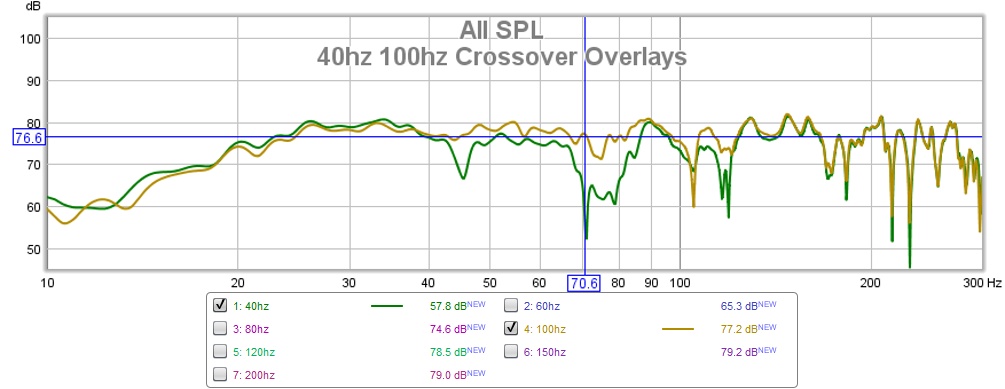

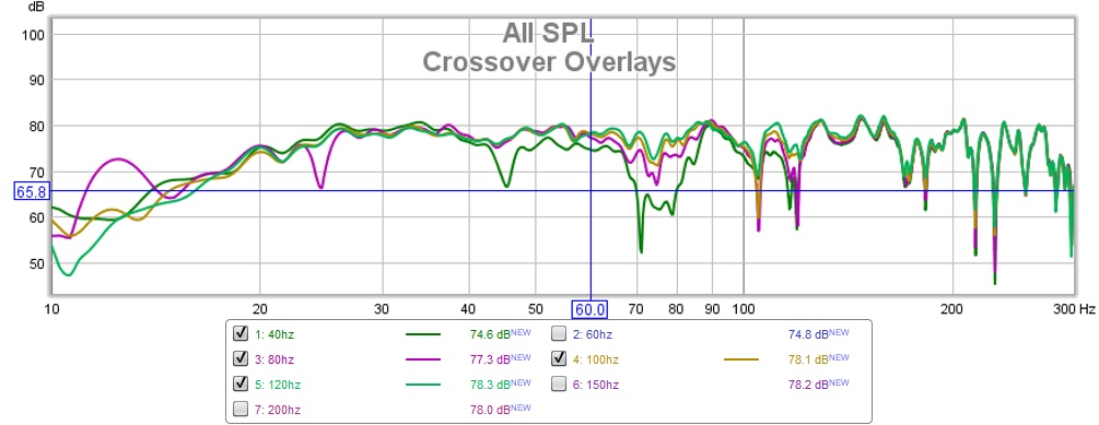

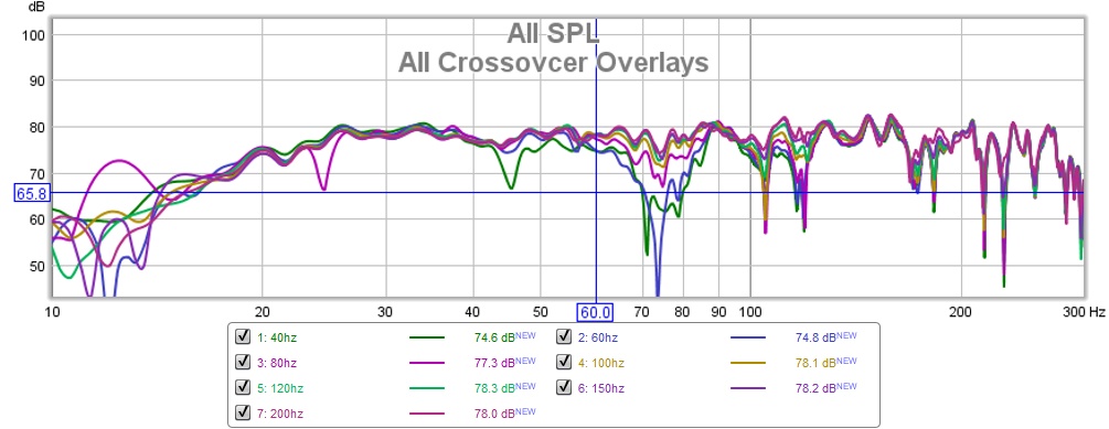

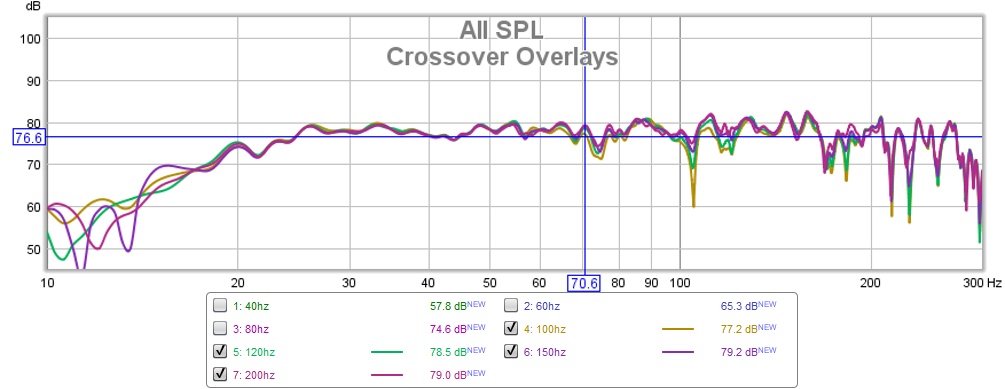

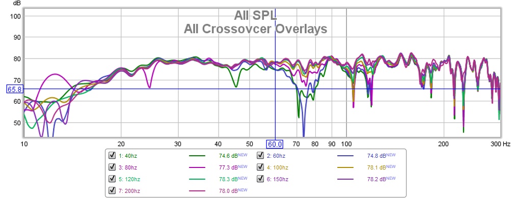

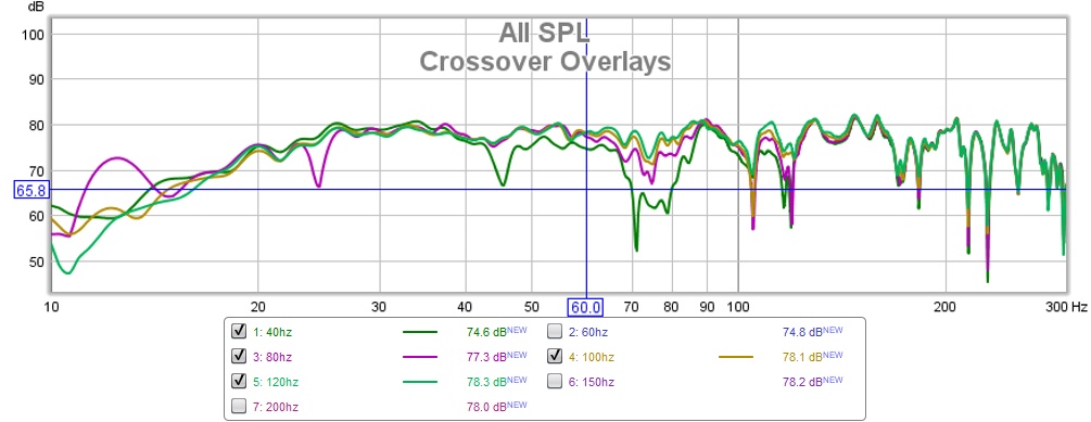

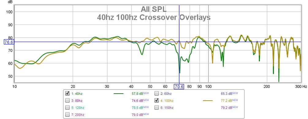

That's without my main speakers, just the subs. I just finished taking several measurements at different crossover points with my mains and my subs. It ain't as purty, but still with no smoothing. Seems like the less my subs are doing, the worse it gets.
I tried to do a few with only a couple of sweeps at a time so it isn't so difficult to untangle. The last overlay shows the contrast between setting my crossover point at 40hz and 100hz. I labeled all of the sweeps to make it easier.
View attachment 22026 View attachment 22027 View attachment 22029 View attachment 22030 I tried to do a few with only a couple of sweeps at a time so it isn't so difficult to untangle. The last overlay shows the contrast between setting my crossover point at 40hz and 100hz.

@Pogre
It looks like 100hz is a good crossover for you.
Put in a notch filter at 75hz, +5dB 5Q (guessing)
I don't see any reason to view without smoothing anymore, run it at 1/12th at this point and see how it looks.
