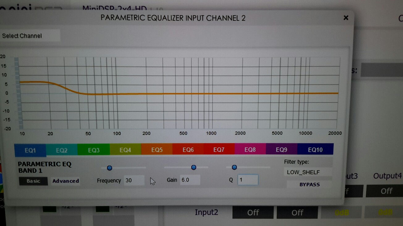

I think I have 10 bands altogether?
This is not where I have it set right now, ATL was walking me through setting up a shelf thingy. I'm posting this one cuz it's handy and wanted to ask if the boxes numbered 1 through 10 are what you're saying are bands?
Yes. That's basically how many EQ "sliders" you have.
