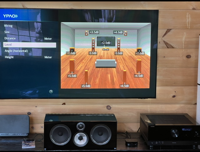

To add, in my experience the gain knobs on most subwoofers are pretty sensitive and it doesn't take much to turn them up or down so do small adjustments until you get it where you want.

Your speakers will be what they will be. How you get your sub in line is with the gain (volume) on the back of your sub. If your trim levels are at -10 right now then you're likely running hot. A lot of the time they instruct you to start with your gain at 50% (12 o'clock) but I find that's even too much. The gains on my subs are at about 9 o'clock.

OH! And I just noticed your sub trim levels are -7 now! Perfect!
But noticed the surrounds are jacked way up would like to see there placement in his room . I didn’t see what he’s useing for those or there locations .
Pogre
Pogre
They might just not be as sensitive as the main speakers. Did op give us a speaker list? If so I missed it and really don't wanna dig back through 20 pages to find it... lol.
Also @OldAndSlowDev, did you manually adjust your mains so they're at 0.0? I would leave them wherever YPAO had them. The idea is to have them all playing the same volume at mlp and room interactions and positioning can result in some differences.
