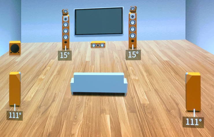

Can you post a picture with the angles and height measures, please?

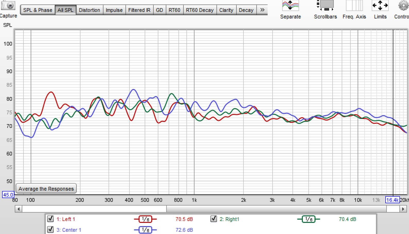

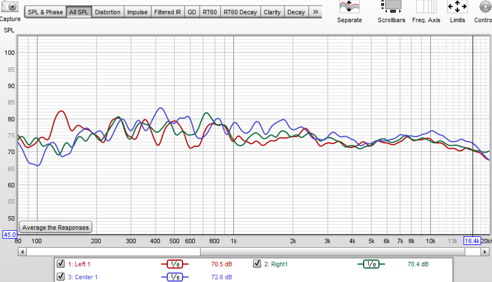

Here is the REW 1/6 smoothed of the measured YPAO FR and Center speakers, Straight 80 -20k Hz.
This is all I could do before family coming home. I will try to measure pure direct and corrected to see the differences.

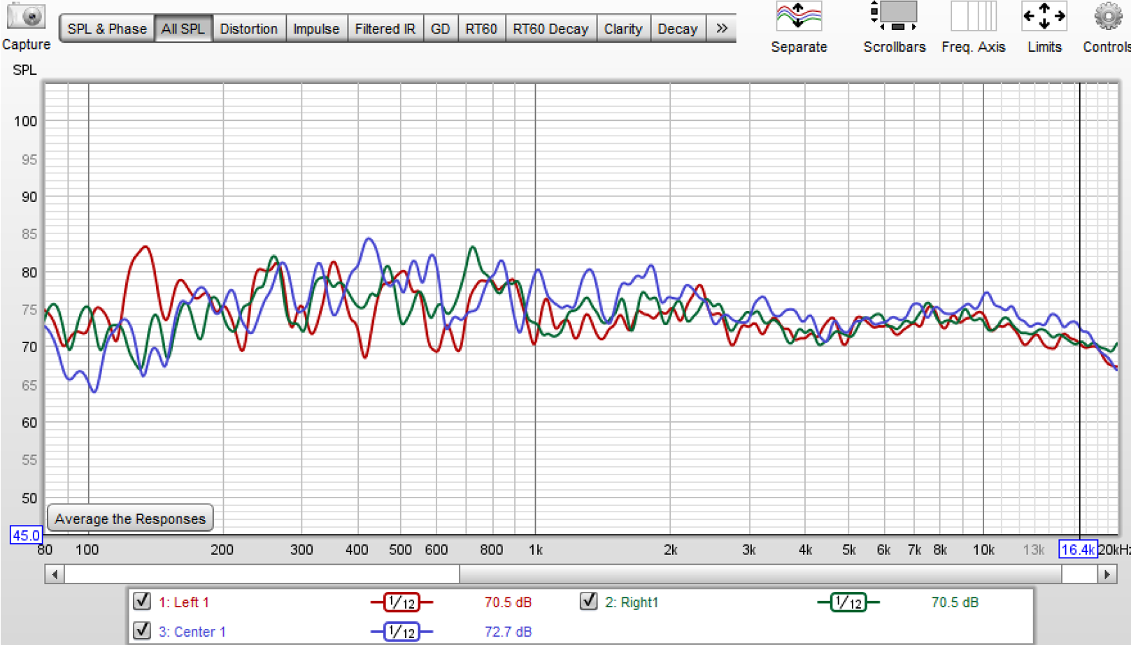

1/12 smoothed

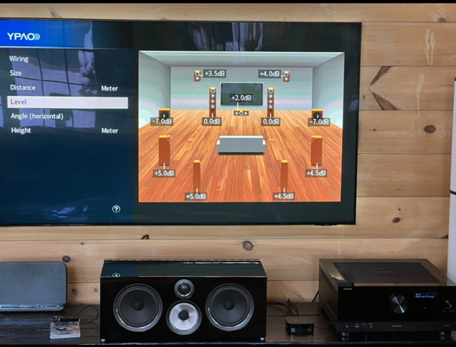

1/12 smoothed
My front presence are 1.5m above listening level. Front presence and front speakers are 21degrees to fit Dolby guidelines and respect Gene 80% guidelines (within half an inch error). Surrounds are 100degrees
I was interested how your AVR was showing this information. That is why I was asking for a pic. On mine there is information missing.
