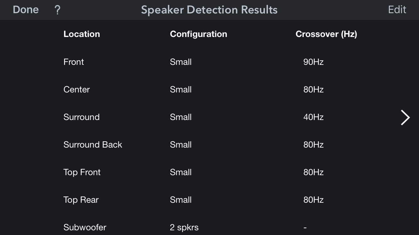

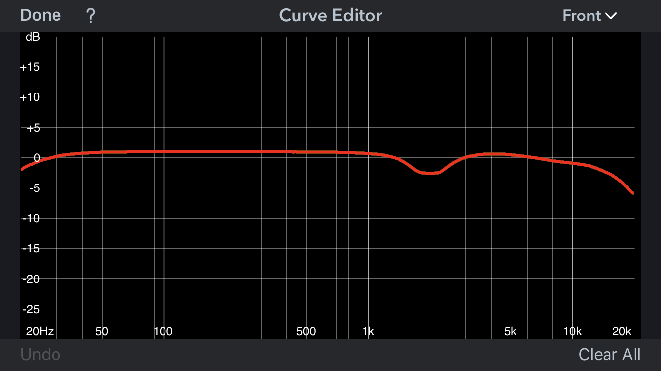

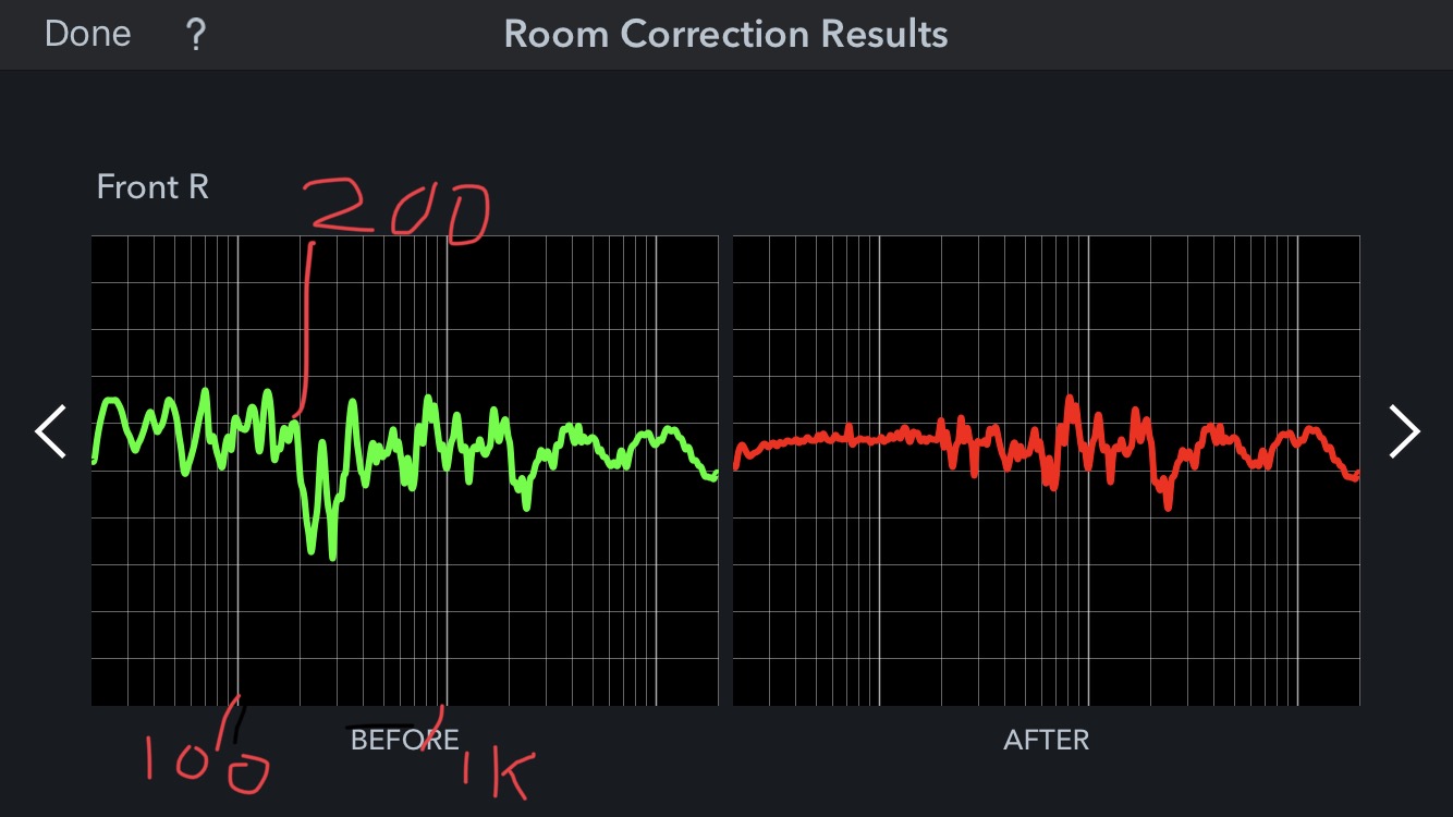

Here are some screen shots from audyssey pro.
Can a good speaker not play loud?
View attachment 23593 View attachment 23592 View attachment 23591
If the speaker sensitivity is in the 84dB/2.83V range and the impedance is 4 Ohms, it's not going to A) make a lot of amplifiers happy, B) reach the high SPL wanted by many people. 2.83V is the reference signal used for sensitivity, but you need to remember that it's equates to 2W in a 4 Ohm speaker, so 1W will result in roughly 81dB output. If you want 111 dB peaks, your amp needs to be able to produce 1000W, peak power. You will realize higher SPL at all frequencies because your room isn't anechoic, but the fact remains- your speakers are not sensitive. We read comments about equipment sounding 'effortless'- there's nothing effortless about driving a low sensivity speaker and my point was that loud does not equal good. Good is perceived, loud is measured and felt. If you want these speakers to survive, cross them over higher- your subs are producing more usable energy in the low end, anyway- using the B&Ws in the same range is probably costing you output and smoothness.
Also, the screen shots are from how Audyssey adjusted the response- if you want to know what the mic received, invert the graph and you'll see dips in places where the speakers don't want to see a boost, e.g., 25Hz.

The slope isn't infinite, but it's a lot steeper than if they were passive and I think you're looking at 60Hz as being boosted, when it was a peak in the response and has either been pulled back, or it's a phase cancellation. There are other peaks in the 50Hz, 40Hz and 25Hz areas, post Audyssey.
I would like to see the response without any EQ.
PENG
I thought I was in fact looking at before vs after , didn't he post both?
For avr , Audyssey can boost up to 9 dBdB . I just check mine, the FR has 3 to 5 dB boost between 60 to 85 hz , that's not insignificant if one pushes the speakers close to their limits .
He showed curve editor and results, but there's no "before & after". I haven't seen that representation from an RTA, either- it's much smoother than what REW and others show. 3-5dB is pretty mild, really. Look at the dips and peaks in the areas of just over 200 Hz, just under 300Hz and around 350Hz- those are drastic- the difference between the last two is around 16dB, upward.
