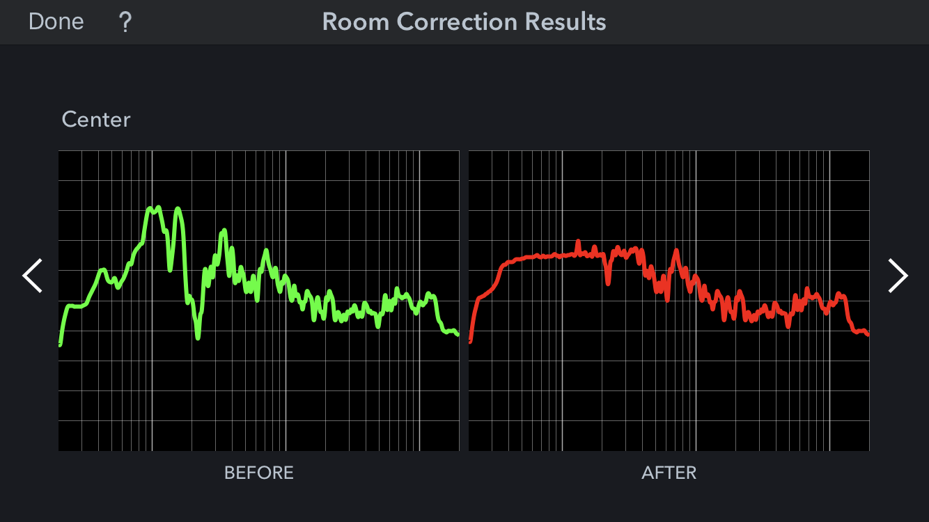

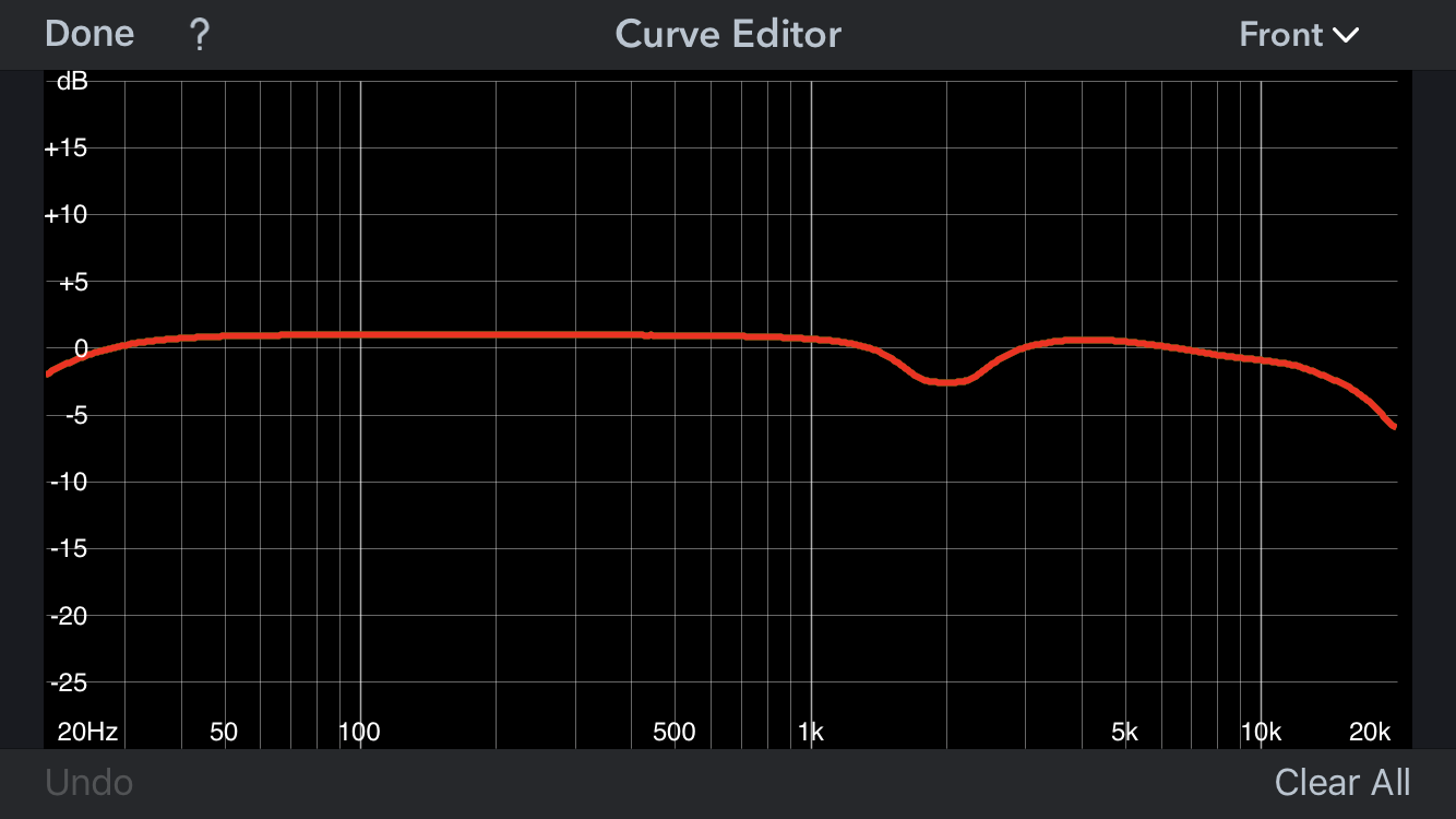

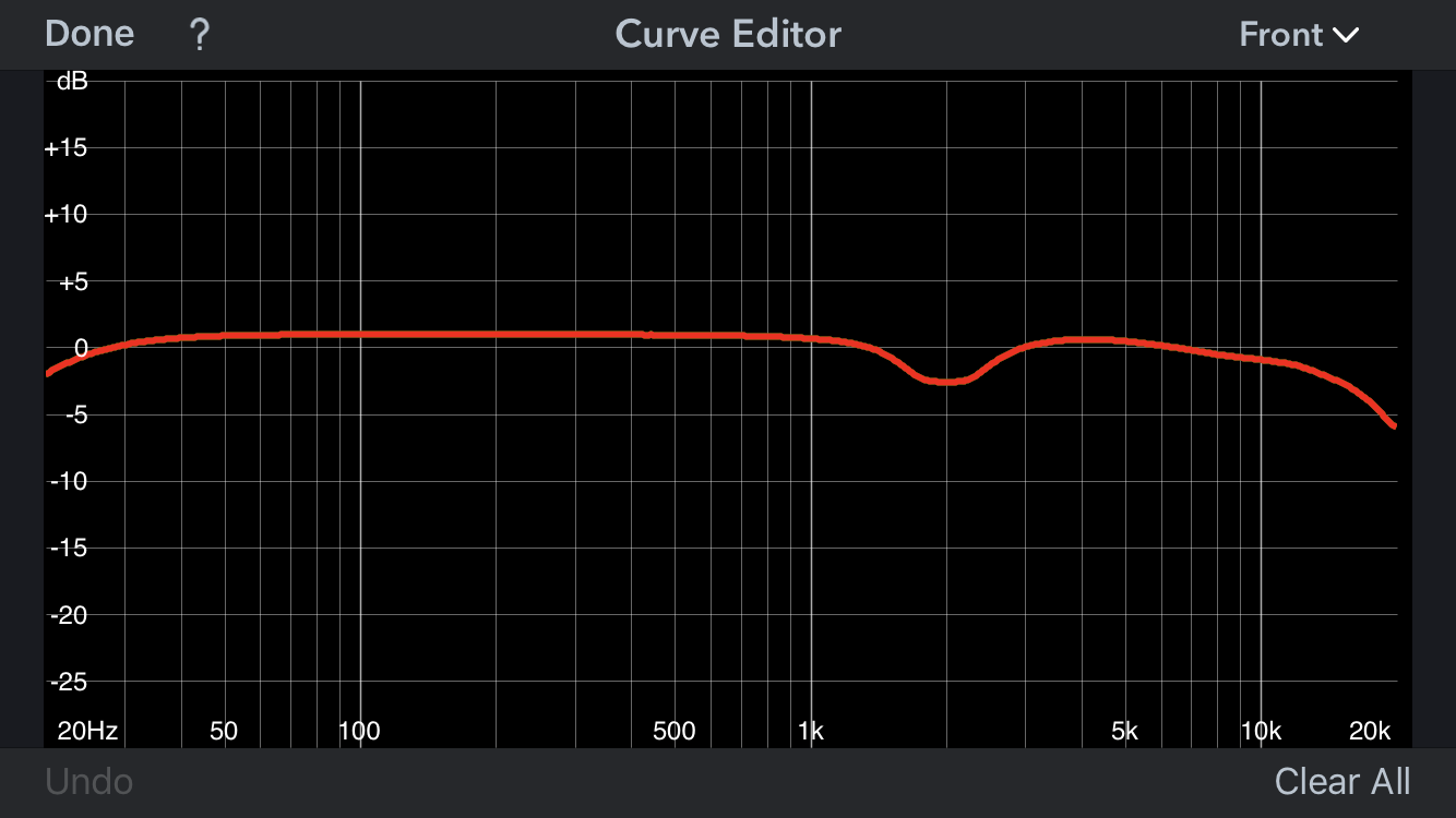

He showed curve editor and results, but there's no "before & after". I haven't seen that representation from an RTA, either- it's much smoother than what REW and others show. 3-5dB is pretty mild, really. Look at the dips and peaks in the areas of just over 200 Hz, just under 300Hz and around 350Hz- those are drastic- the difference between the last two is around 16dB, upward.
I have no experience with the App so I would assume you may be right, or may be not. Regardless, I thought your point about boost by equalizers, like the example you cited, could well be the issue discussed here. As you said, it would be great if the OP can plot and post some REW graphs for us to use the before and post Audyssey effects.
Is this not a "before & after"
PENG
As I said before, I thought what you posted were in fact before and after Audssey did it's thing but for some reason Highfigh didn't seem to agree for some reasons. It is hard to decipher though without seeing the scales.
Questions:
1. Could you make it show both the x-axis frequency in Hz and the y-axis spl in dB? If yes, could you change the resolution, or what it might call "smoothing"?
2. Are those graphs just there after you ran Audyssey, that is "as found", or it's the final "as found" after you ran Audyssey and then use the Editor App to make changes?
3. Can you also post the camera shots of the graphs available under "check result" without using the Editor App at all?

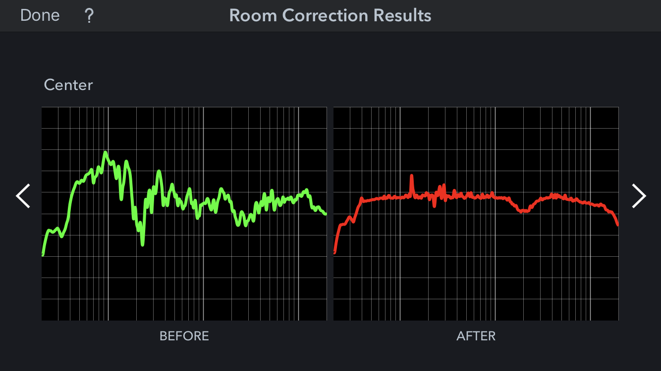

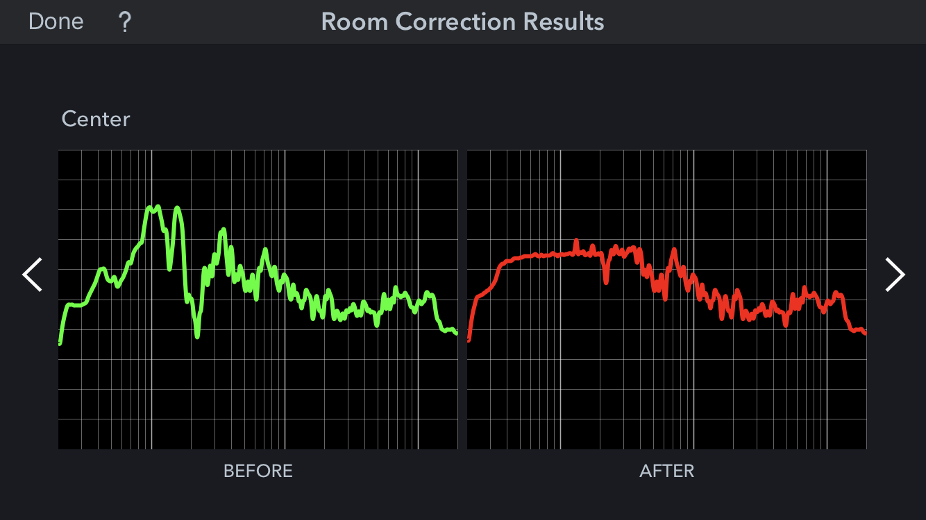

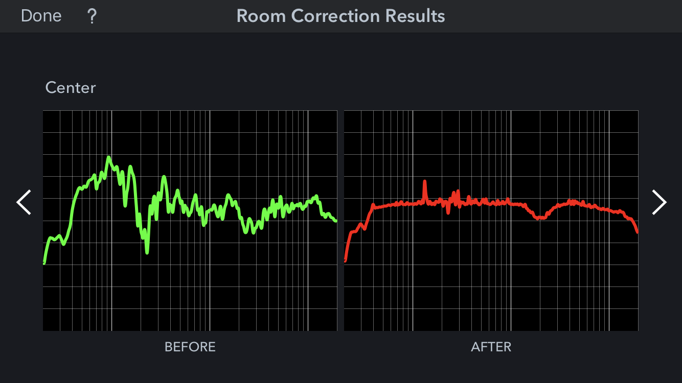

Unfortunately the pro ap doesn’t place the numbers on the scale on the before and after so you will have to use this as a reference.
Here is my old b&w 7 series htm71 s2 that I have had since July and has survived through 8 804 d3 woofers being blown with no problem.
And here is my brand new diamond center htm2 d3 that blew a woofer within 20 minutes of the first movie that I watched.
You can see that both graphs are almost the same but 1 speaker lasted half a year with no issues and 1 well not even 1/4 of the way through a movie. Does anyone have any suggestions?

Here is my left and right
Here is my 7 series center
Here is the 8 series
PENG
I can see a lot of boost in the 60-80 Hz range 130-150 Hz (mid bass) and it is a tough one to solve because you can't increase the XO that high. For quick action, you can certainly try to raise XO for the L,R,C speakers to 90 Hz and listen to 5 dB below reference, that's 80 dB average, still quite loud.
Or you can take the time to try and move the L,R speakers a couple inches at a time in the hope that it may eliminate or reduce the dips that resulted in the boost by Audyssey. To do that, without using something like REW, it could take you hours because after each move you won't know the effect until you re-run Audyssey. You could shorten the time by just doing the main seat after each move, and only do all 8 positions once you find the sweet spot that does not cause Audyssey to boost so much.
Remember every 3 dB boost will cause the power output to double at that frequency, so 7 to 9 dB boost that the graphs show could be significant enough to cause some failures you have been experiencing, when combined with the fact that you listen to reference level SPL from 15.5 ft in a large room. The KEF R900 that you mentioned in your other thread will have much better chance surviving.
Obviously you can also select Audyssey LR bypass, but then you may complain about lack of bass in the range of 60-80 Hz and 130-150 Hz, or you may not miss it at all, or even prefer it.
