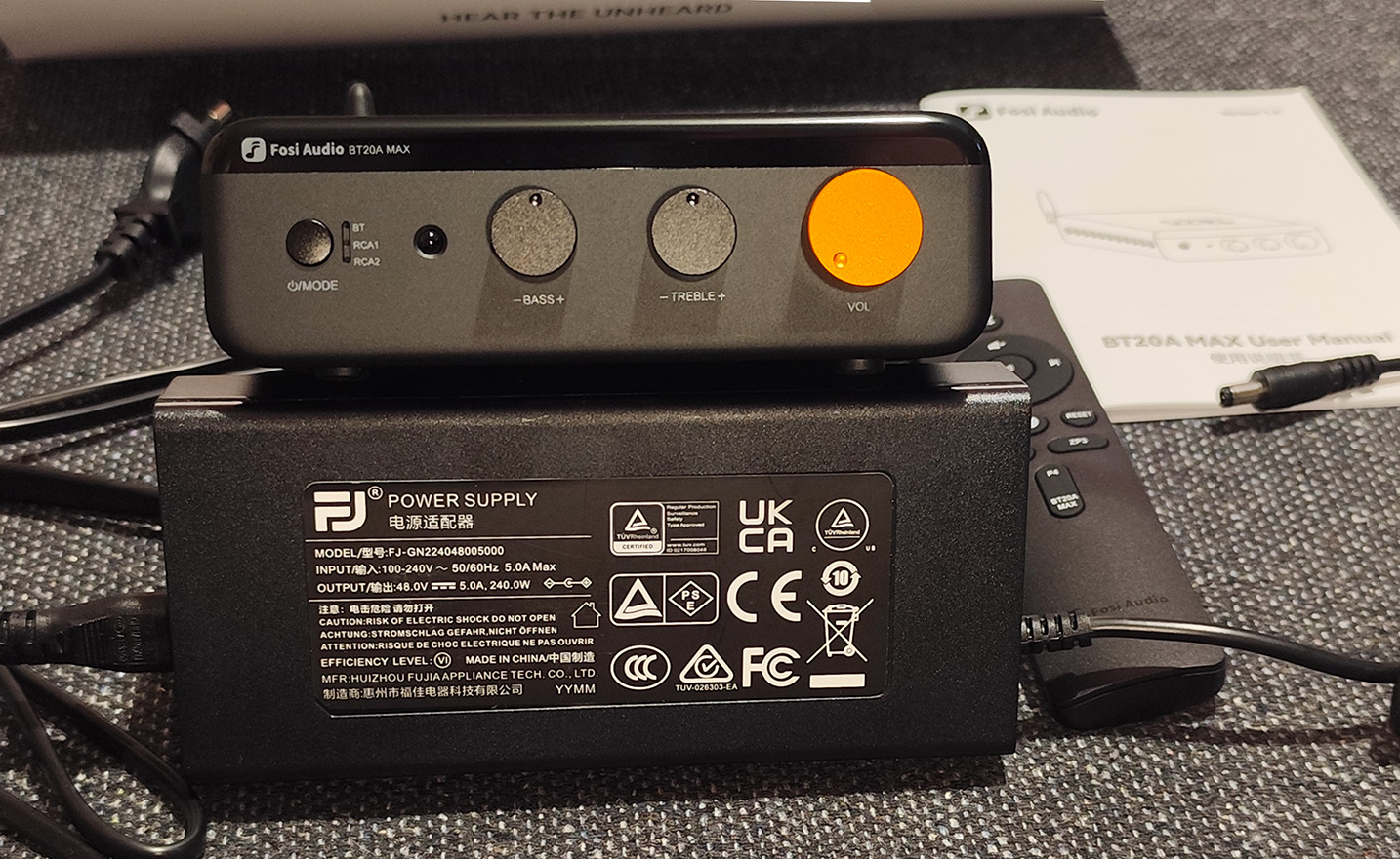

I received a new package from Fosi audio. Thank you very much for trusting my neutral reviews and thank you for not expecting anything "only positive" from my review. I was given free rein to write an honest user review. Let's see what arrived. Their latest desktop compact amplifier, the BT20a Max, arrived to me before the New Year. It was supposed to be introduced at the end of 2025, but the final date was postponed to January 10, 2026. The price ranges from 280-320 USD, depending on the power supply output (32v 5a - 48v 5a and 48v 5a Gan), but as is usual with Fosi promotions, I see a 20% introductory sale on their website. This price may vary. At the time of writing this article, I saw this price on the official website.

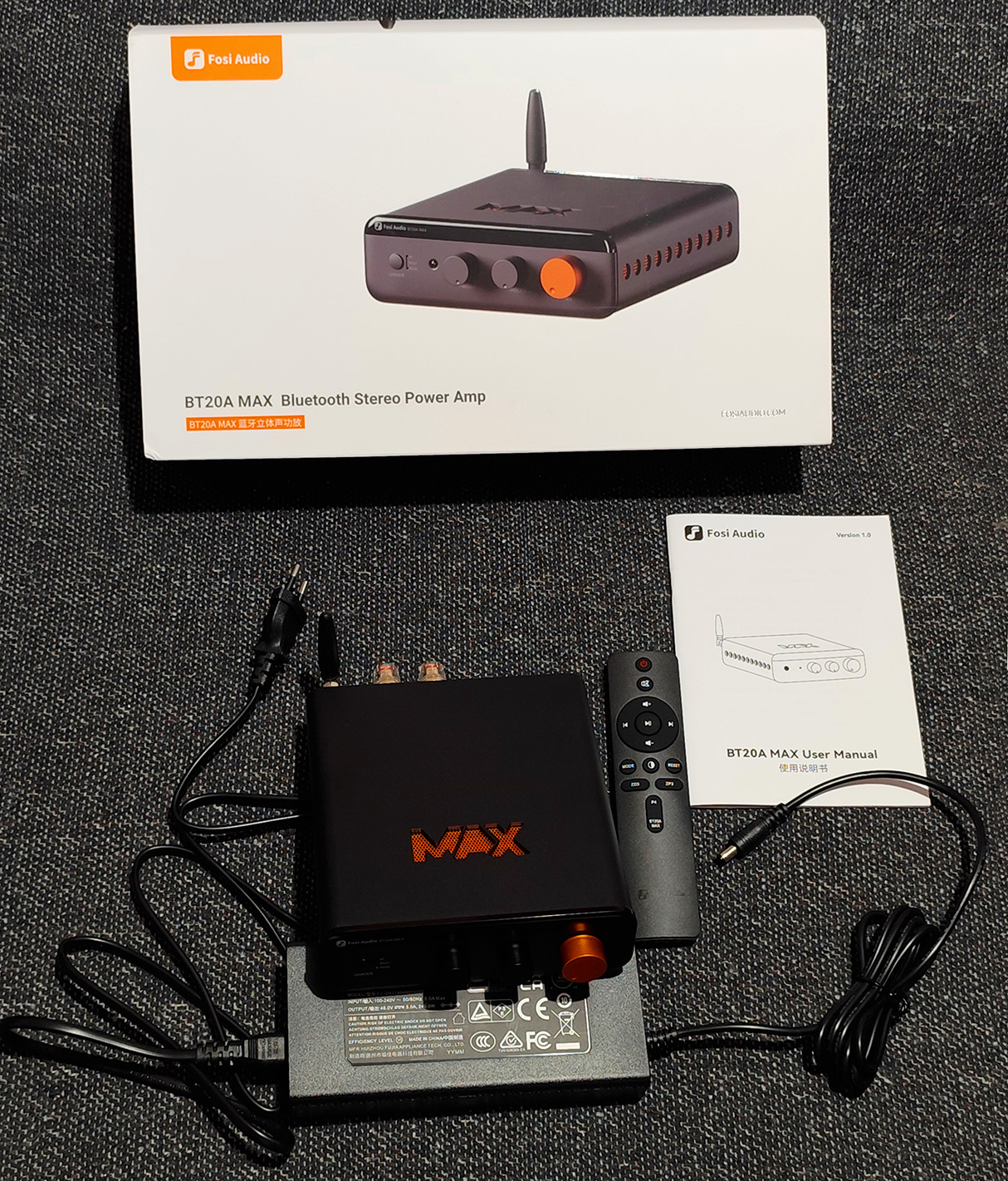

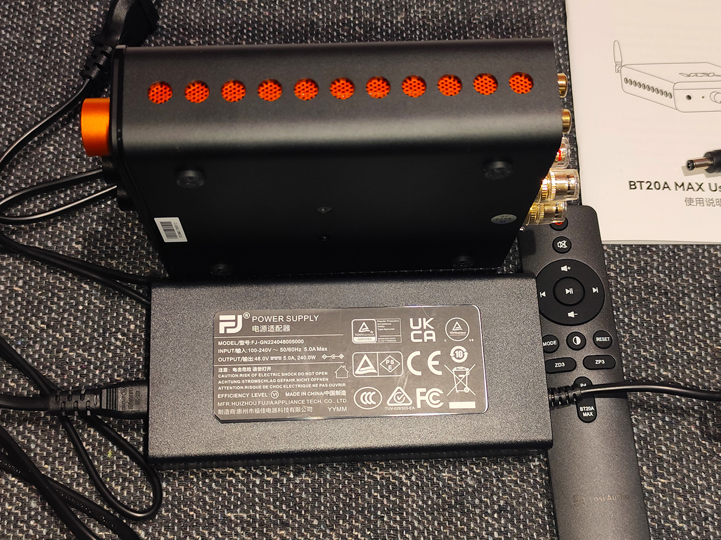

Let's not wait any longer, unpack and see what's in the box:
Contents: BT20a max
48v 5a Gan power supply
Remote control
Bluetooth antenna
User manual.

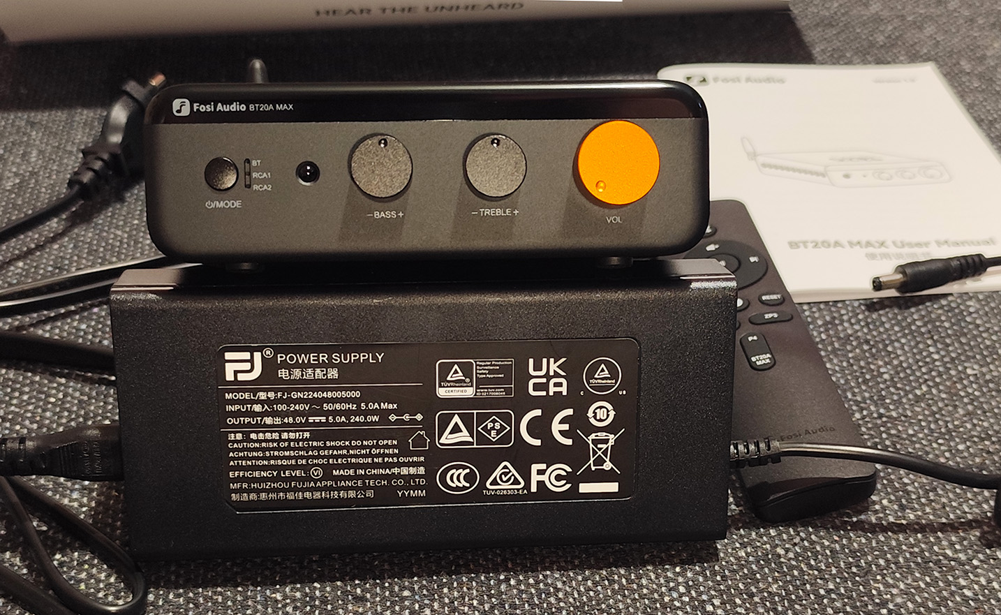

Before we start, let's take a quick look around, front panel:
It's immediately clear that the design is new, obviously I'm mainly thinking of the front panel here. It's different from what we're used to. It has a designer, rounded front panel. With a plastic decorative strip on top. This is the first device with all four edges of the front panel rounded. We find a power button on it, which is also the channel selector. Here we can see that we have 3 input channels. We see a series of LEDs that indicate the currently used input, the remote control sensor, an equalizer and a motorized volume control. The layout is very logical, I like it too.

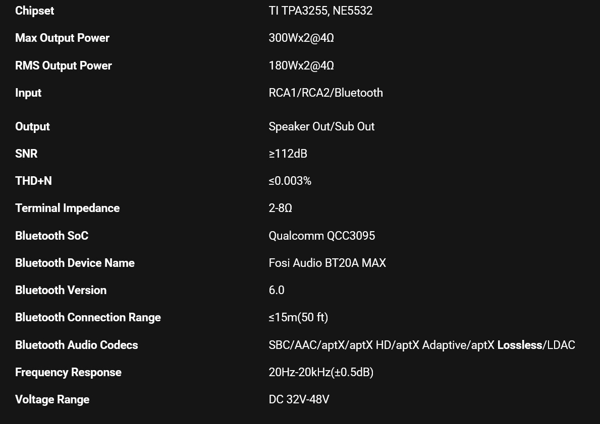

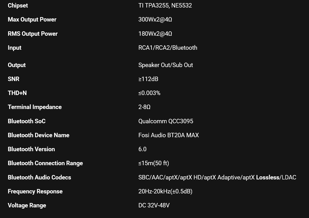

The device has very good parameters. I don't usually fill my reviews with specifications, I prefer real-world usage reviews. If you want more details, you can find everything on the manufacturer's website. I'll mention a few:
Hi res Bluetooth Audio, With Bluetooth 6.0, the BT20A MAX supports a wide range of high-quality codecs, such as LDAC, aptX and aptX Lossless, Qualcomm chip: QCC3095. PFFB (this is Fosi's first stereo amplifier with PFFB) 2x300 watts on Ohm, Hi pass filter, snr 112 pcs. distortion 0.003%. Separate power supply for digital and analog sections. Elna capacitors. Built-in cooling.
Factary Data:

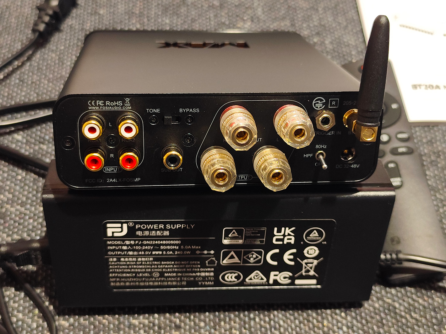

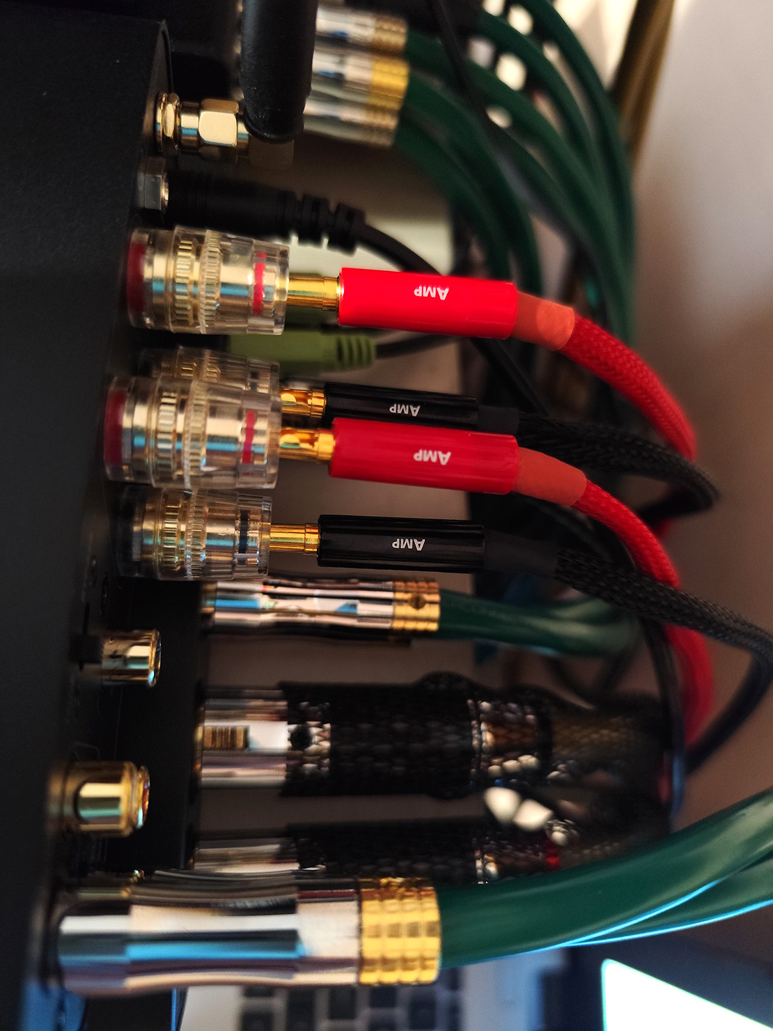

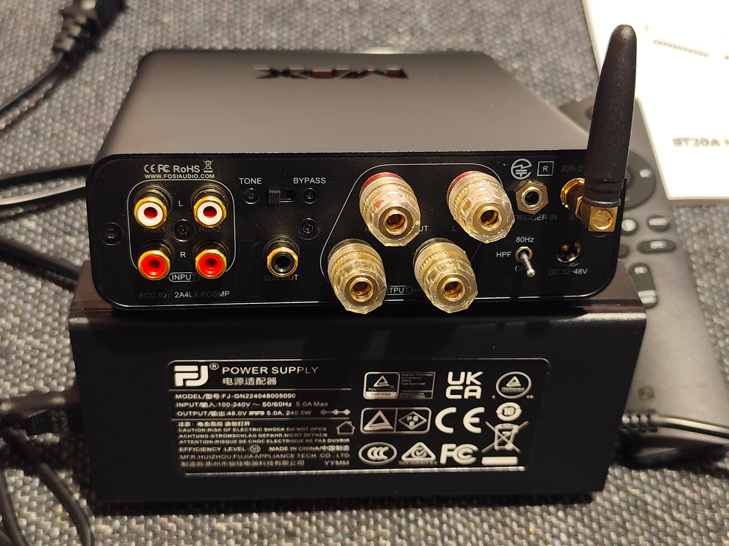

Backside:
From left to right we find two RCA inputs. Then a bypass button to turn the equalizer on and off. Below that we find a sub output, then the speaker outputs. These are easy to use with your fingers, not too small. They are larger than the v3 banana sockets, the same as the LC30 banana sockets. They are better because they are big enough for your fingers to comfortably reach and tighten well, but unfortunately they do not fully accept the standard banana plugs. Only about half.
AudioQuest SureGrip 100 BFA banana plugs:
They are not deep enough. In any case, the connection is stable. The sockets are not loose. They hold the plugs tightly. I think this may change in the future if possible. It would be nice if they were made of copper and gold plated. These banana jacks are similar on several of their devices. I recommend that in the future we use a jack that accepts standard plugs along their entire length, and is also big enough to comfortably reach and tighten them if we are not using the plugs, but clamps or a fork. Let's move on. Next is the trigger input. There is no output, so further chaining (stitching) with a trigger is not possible. (This is not a problem, because it is not needed at the end of the chain, just an option) Below it we find a high-pass filter switch, which, when using a subwoofer, cuts off the bass from the main output at 80 Hz and sends it to the subwoofer output so that we can use the 2.1 system. Next to it are the bluetooth antenna and the power supply input.

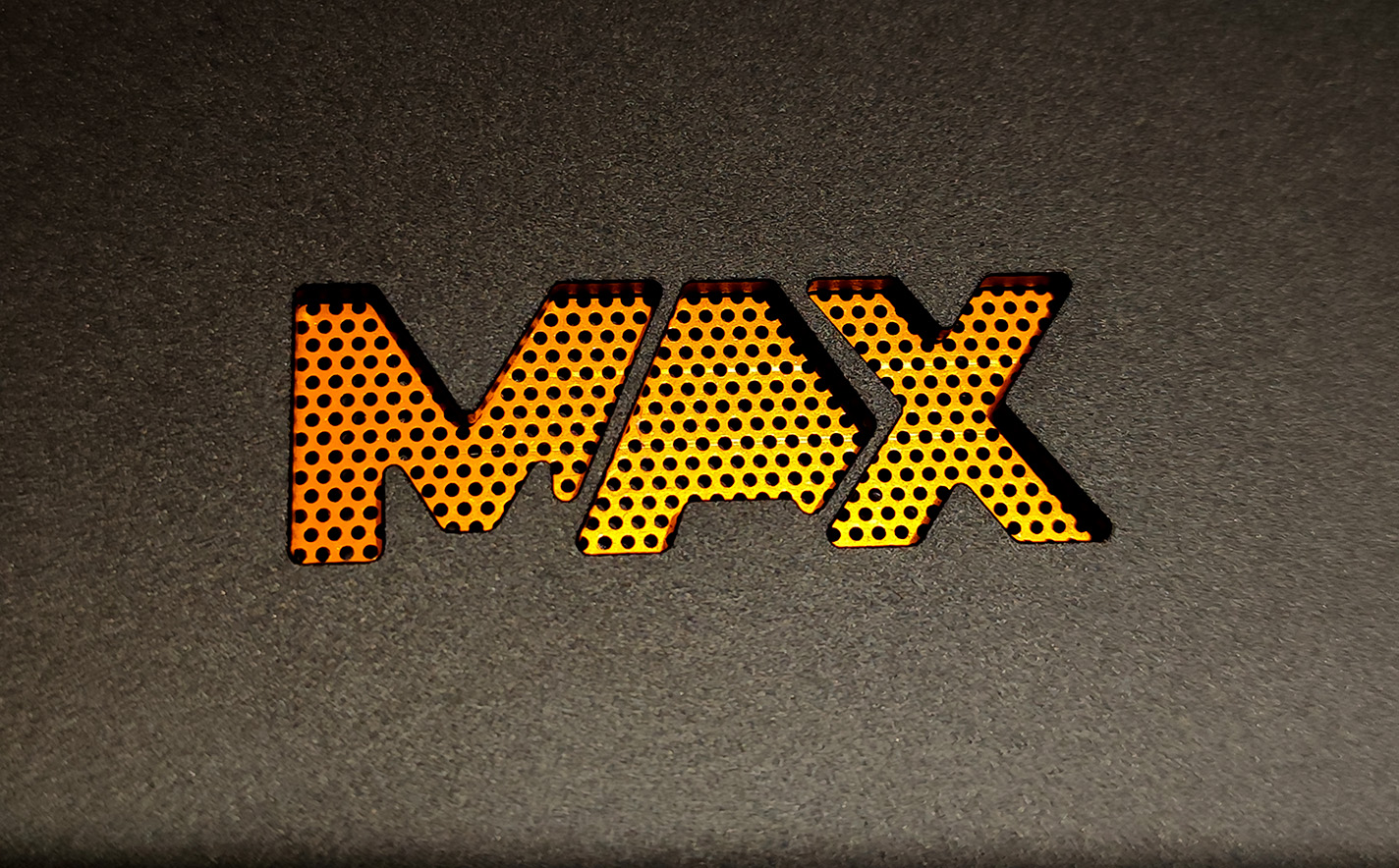

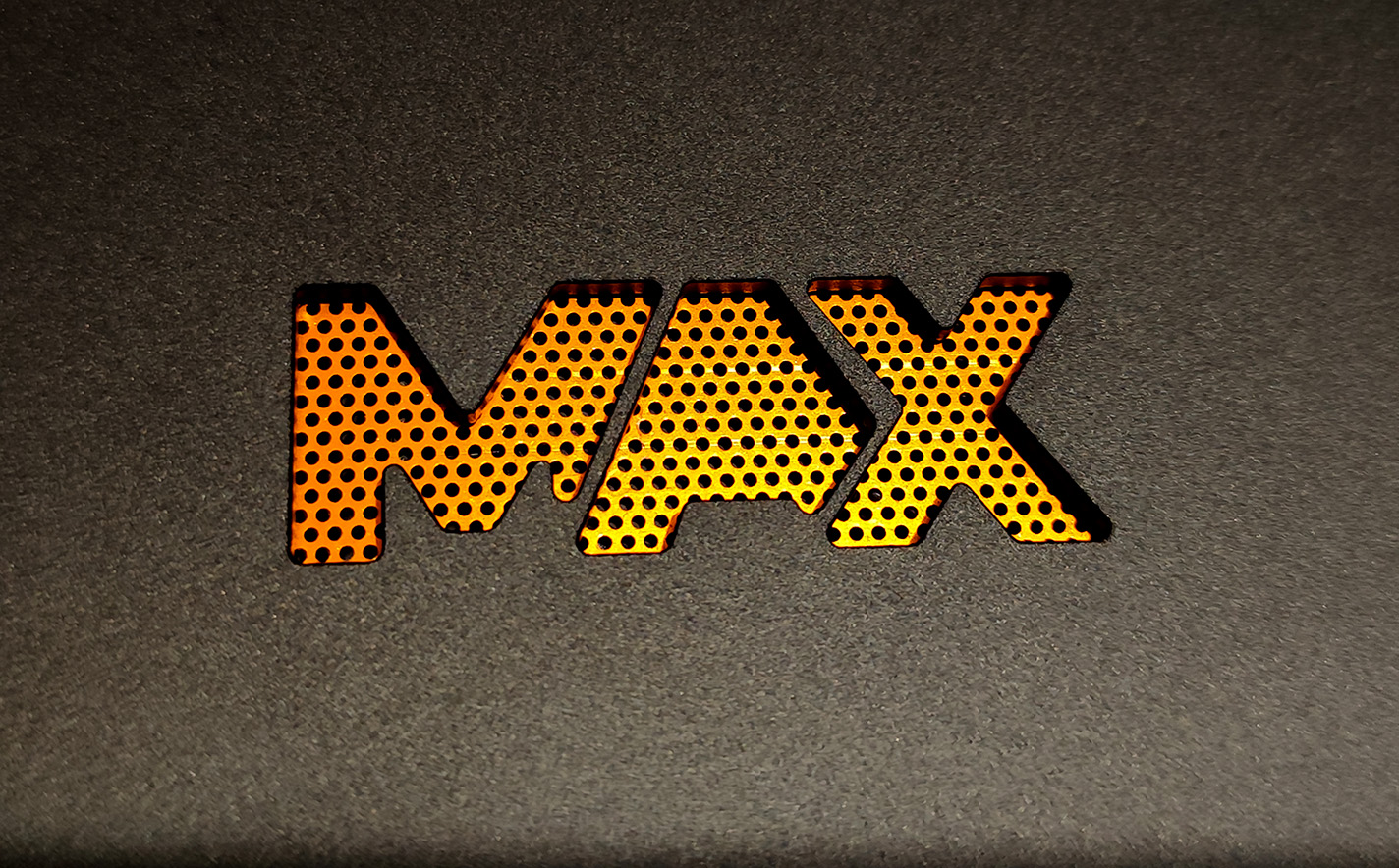

Top vent hole „MAX”

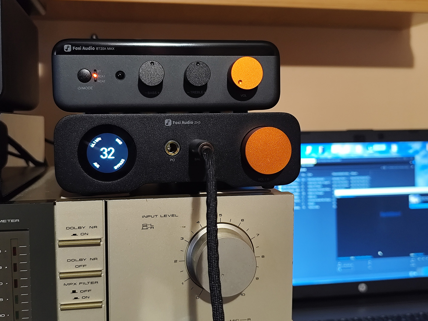

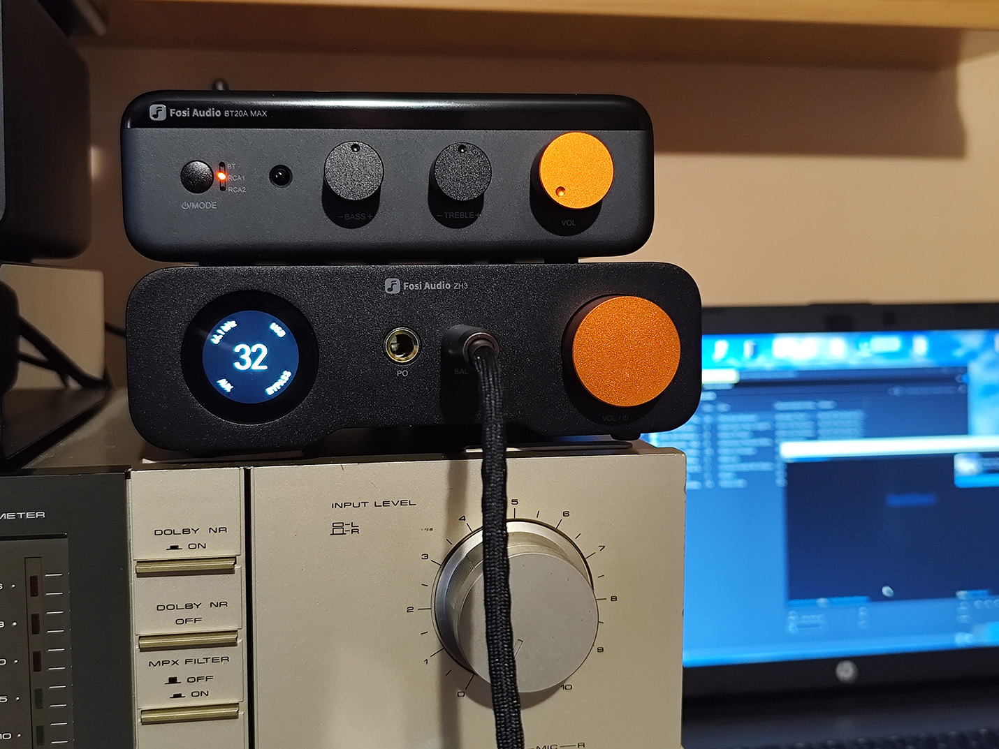

From the external dimensions it is clear that we cannot really pair this amplifier (on top of each other) with any other Fosi product. If it had been a little wider, it would have matched the members of the za/zd/zh series and then there would have been room for a balance button on the front panel, which would be a great help for those listening to music in an asymmetrical room, and perhaps an additional RCA input and a trigger output on the back panel. This is just my imagination. But this way, it would have fit into the family of existing devices with its dimensions. But it was not designed for an existing device family. This is a new device. Used separately, it is a very nice device. It should be treated as such.

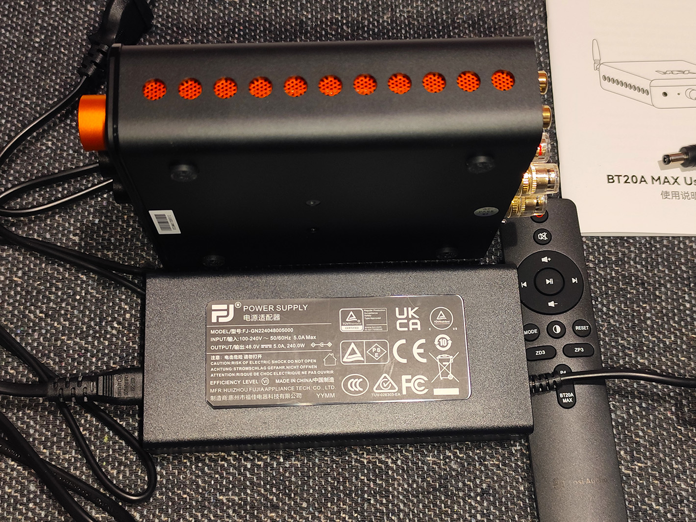

Side vent holes:

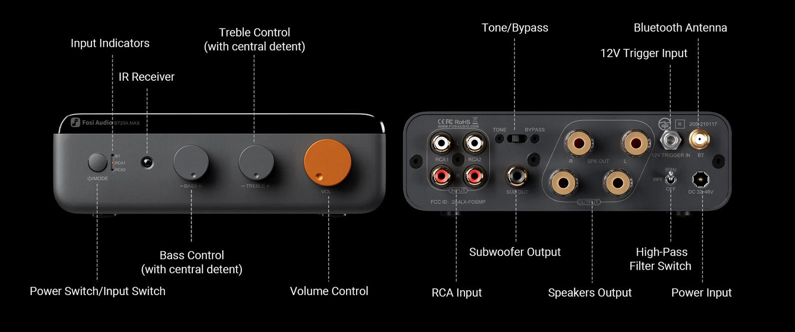

Controls and connectors:
I usually never use the Bluetooth connection. Regardless, this is a very useful feature. If you need it, it's there. Of course, it provides convenient use, there are those who will love it just because of the bluetooth connection. But I don't play music from my phone at home. I did it just now for the sake of thorough testing. I like to use my reliable cables and my playback devices or the PC player software. During the test, I played many high-resolution files with the full version of the Poweramp application used on my phone. Every detail sounded very good. Whether it was a hi-res or a plain flac file in the phone's player, it was always sufficiently detailed and true to the instrument. The space is very good. It has the same good quality as my v3 monos, and in fact better. Although in the past I have modified my V3 monoblocks with a few extra capacitors, better banana sockets and op amps. In addition, I use them with better quality and double-priced xlr cables than the rca cables of the new comer bt20 max . I don't want to exaggerate the sound again, which is why I compare it to the v3 monoblocks. What can be said about the mono sound quality of the v3 is also here, and even a little better. The Bt20a max provides a very pleasant listening experience. In a home environment, it can easily hold its own in the main hi-fi system. It won't have many other challengers or real competitors in your office thanks to Bluetooth 6 connectivity, two analog inputs and excellent sound quality, as well as its compact size and remote control.. The sound quality is great, very good space, large power reserve which is more than enough for anything. I paired it with large floor-standing speakers. This small amplifier has the power needed to deliver a punchy sound. The equalizer can be turned off, but it does not introduce noise that can be heard by ear into the sound even when used. The equalizer effect is correct. Good remote control. Unfortunately the ZH3 is not one of the devices that can be controlled with a remote control. This would have been really good.

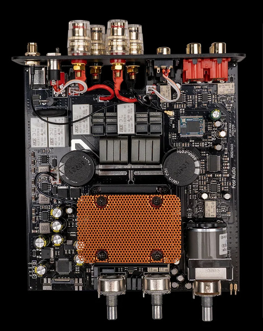

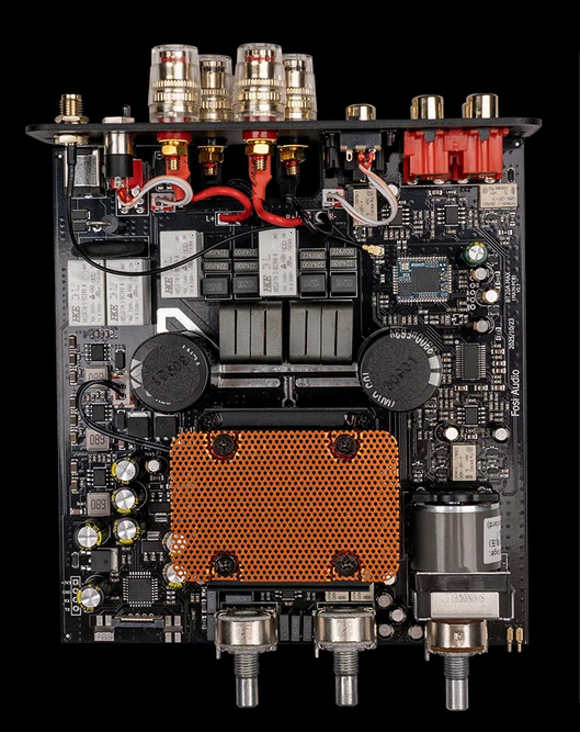

Since I already took it apart because of the fan, I also updated the op amps, although the ne5532 is a very good op amp, but I hear it as thin and digital to sound, so since I had many opa1612 and opa1656 and oracle II 02 at home in reserve, I put the opa1612 in it.
Note: The factory ne5532 is in a socket by the way. The possible versions for modifying the op amps are limited because the integrated cooling fan reduces the space, so only normal height I.C. s can fit without removing the entire fan. Since the op amps are under the fan and a little further in, some manual dexterity is required.
I spent days doing a/b testing using the lc30 so that there would not be a momentary pause in listening when switching. I have to say that (I repeat) everything that can be said about the v3 monos in terms of sound quality is also present in the BT20, even the stereo space is slightly better, and I really like my monoblocks and I think the op amps are better in them (akliam LC5). That's why I'm going to get negative comments because according to the measurements there's nothing audible between the op amps. But I feel like these aren't expensive op amps, and some of them I can't hear better because I spent too many dollars on them. Even among the similarly priced ones, there are some that I've thrown away because I liked one and not the other. For example, the opa1656. For me, this sound is not right. That's all for now. Let's skip on this theme..
Another positive observation: The buffer capacitors in the BT20A Max are larger than those built into the V3 Mono.
Inside BT20A MAX:

Due to its unique size, it cannot be stacked directly with other Fosi products.

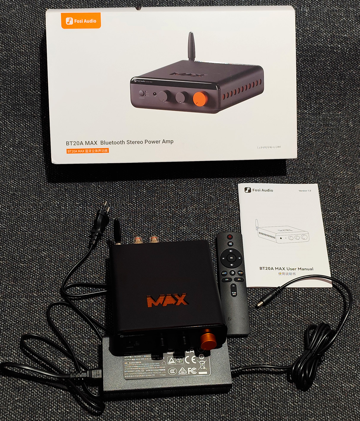

Contents: BT20a max
Remote control
Bluetooth antenna
User manual.

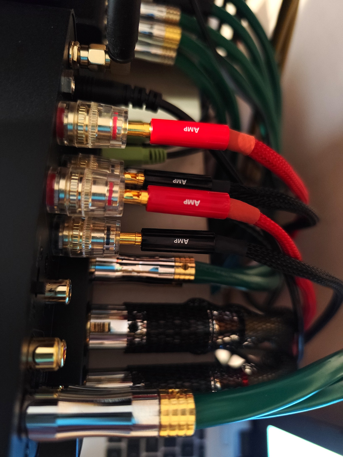

Backside:
