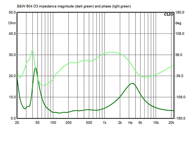

However they also measured the impedance of the speakers and got this.
At around 100 Hz the impedance is 2.4 ohms and does not even rise to 4 ohms until 500 Hz. This is the range where all the power of music is, not in sub range. In sub range the impedance is actually quite high due to the tuning peaks.
So in fact if you take this data and recalculate sensitivity at 1 watt 1 meter, then these speakers are in fact only 80 db 1 watt 1 meter. What this means is that these voice coils will be taking huge amounts of power in the 100 Hz to 500 Hz range, and therefore heating.

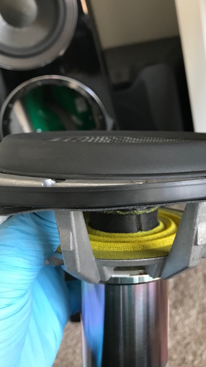

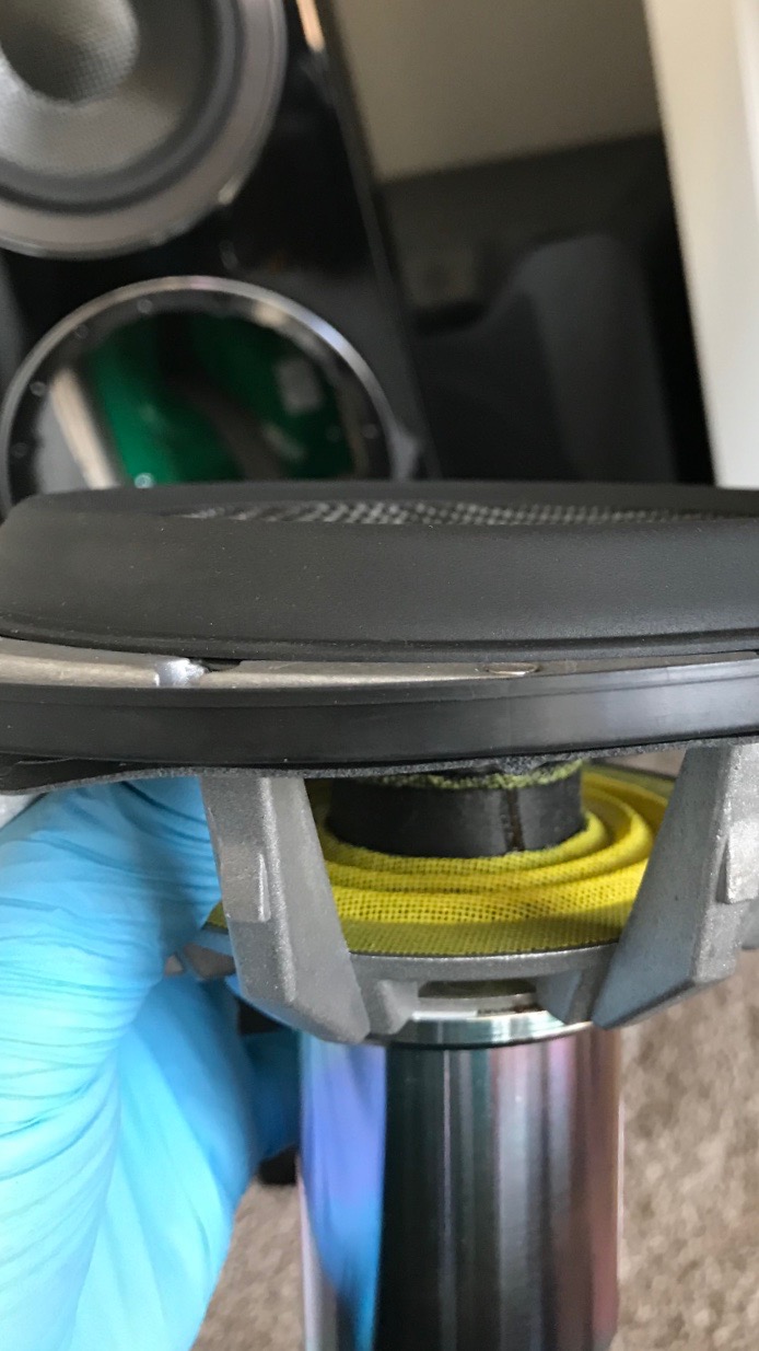

I just pulled out the bad woofers and as you can see in the picture above the part that is failing is the glue that holds that yellow part onto the coil. Do you think this is still from it heating up? I never have any problems with music listening it seems to happen with movies.
That is an interesting photograph. It looks to me as if the adhesive held, but the cone tore away from the VC former. These cones are two layers of a carbon fiber with foam sandwiched between them. You can clearly see the torn and shredded foam.
This is most likely mechanical damage, but could be a combination with heat as well, if the VC former heated up enough to make the cone loose integrity at that point. Given the actual true sensitivity/efficiency of these speakers, I would expect a lot of VC heating if driven hard from a powerful amp. It would be interesting to see if the VC is discolored in any way.
This likely is a limitation of the design concept, which is fundamentally building a speaker with 6.5" drivers that has a 3db point of 24 Hz. This is attractive in Europoe, as using subs is not popular for multiple reasons. I bet if you played classical and jazz in most European sized rooms, they would sound excellent and you would have no need of a sub. Get it in North America and you have larger space and a penchant for ugly dynamically compressed music.

That didn't separate from the cone, it separated from the spider and that would be due to over-excursion. If the VC doesn't rub, this is likely a case of the speakers being driven hard plus equalization- the best combination for killing woofers, especially small ones.

The impedance of the woofer at 20Hz is about 20 Ohms, so I think the over-excursion was caused by boosting a higher frequency.
