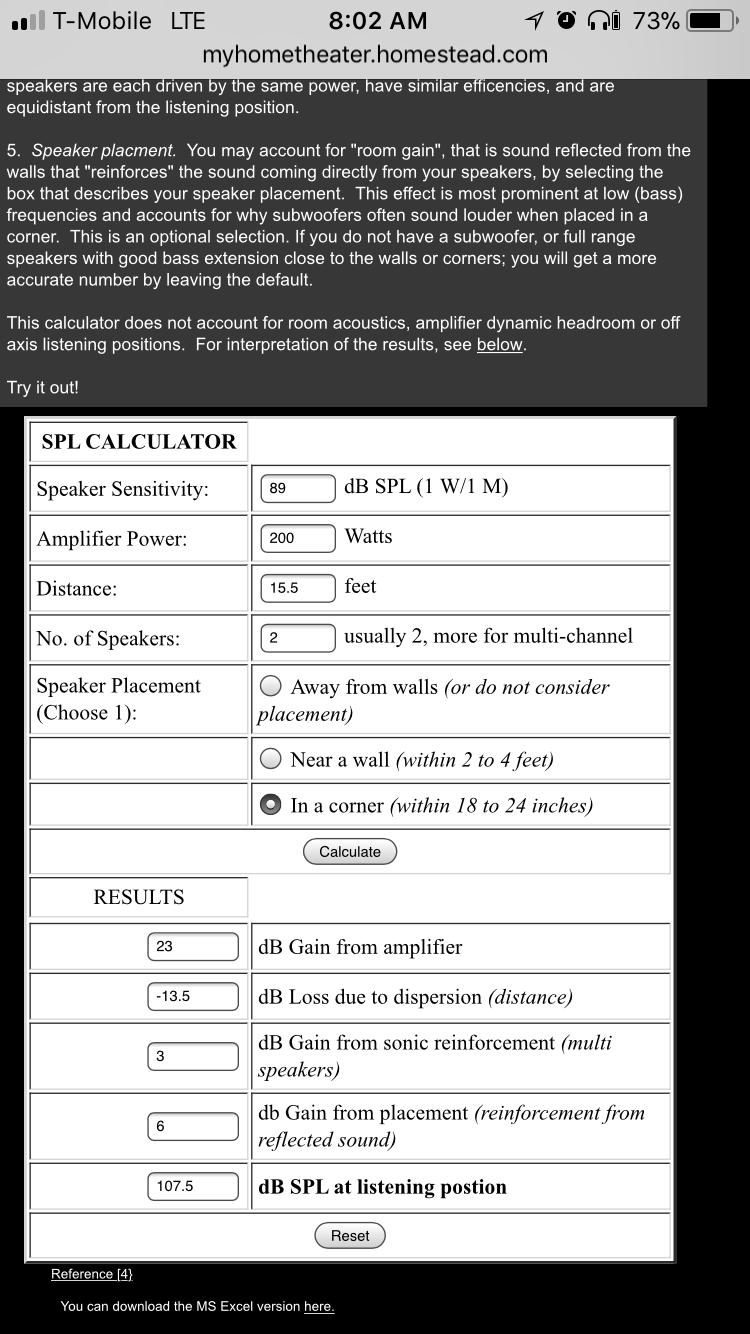

1. The speakers are not designed for the kind of spl you need. This is an educated guess only, without knowing your room dimensions, amount of acoustic damping, sitting distance, and to certain extent the media contents you have been mainly listening to (types of movies, music etc.).
If you don't want to provide the into, you can use the online calculator linked below and let us know the results. It won't be very accurate but should be good enough to help troubleshooting.
http://myhometheater.homestead.com/splcalculator.html
