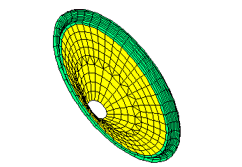

so if the cones have a cross over that would make a difference? in breaking up. hmmmm we have to find that info out
An illustration of speaker cone break up:
Cone behaving like a piston (sounds good)
Cone breaking up (sounds bad)
An ideal speaker cone always behaves like a piston, but in the real world all speakers have a frequency above which they start breaking up. It is up to the speaker designer to find out how high a woofer can go before break up begins. Consider it an upper limit. Then he knows how to begin designing the crossover.
In the Pendragons, the 10" woofers will be breaking up well below the lower limit of the 1" tweeters. And there is no crossover to prevent them from breaking up.
A crossover can only reduce the magnitude of the breakup.
If you reduce the magnitude of the breakup adequately for these 10 inch woofers, then you've got a big gap, probably between 700hz and 2.5khz I'd imagine.
That's an equally poor sounding speaker in its own way if it's lacking that critical upper mid and lower treble range.
