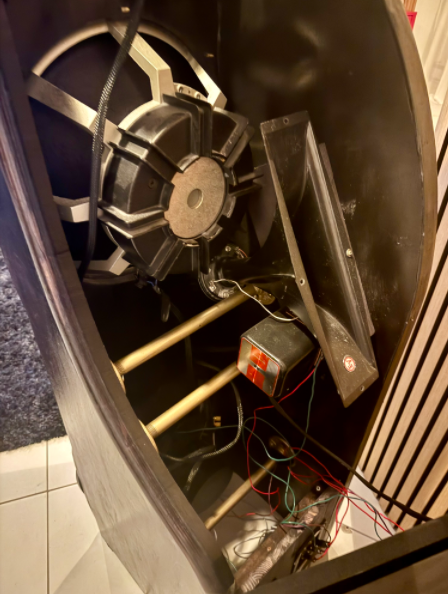

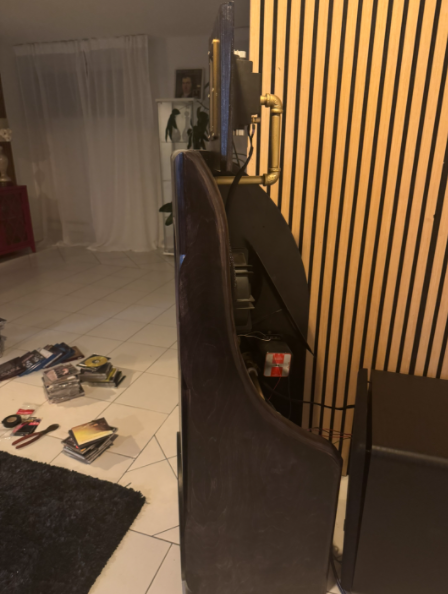

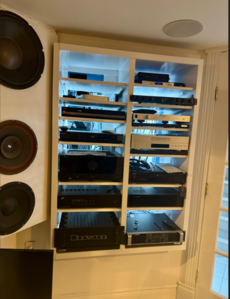

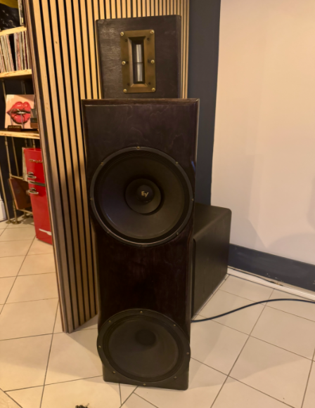

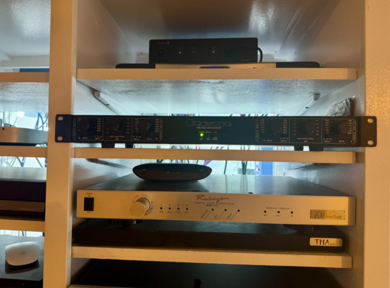

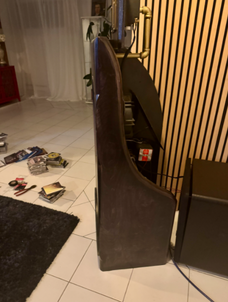

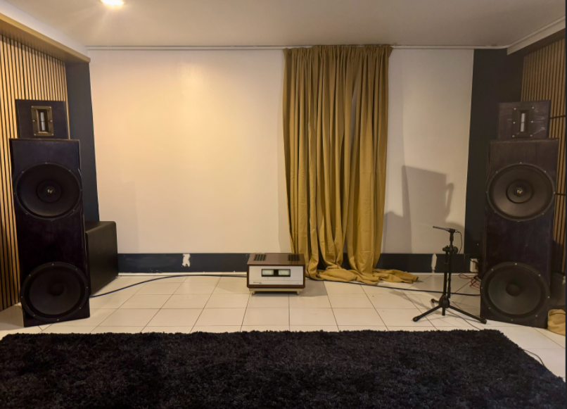

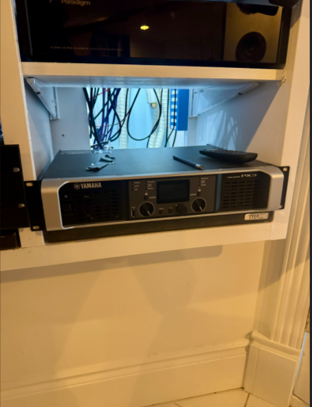

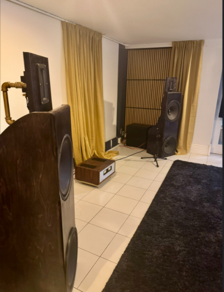

Here are the pictures to help get a better visual
I took pics to show the alignment of the drivers. Also the plotting of Dominic Petoin and the rack to identify the xovers and amps.
The small EV horn is an idea from a parts express winner of a sound off. He added this to his OB's and figured why not. Adds depth to the stage, that's all.

I added pics to better explain than I seem to write.
