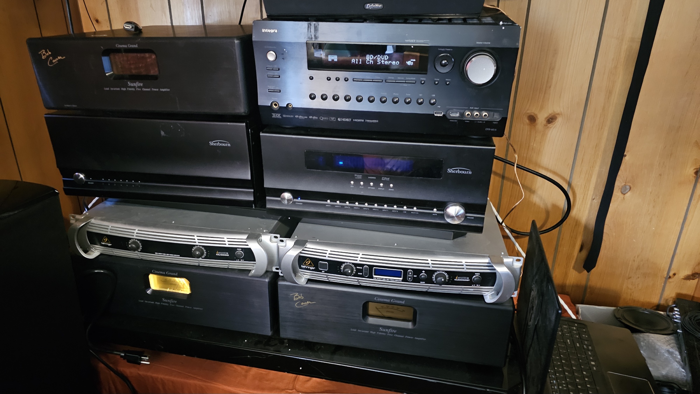

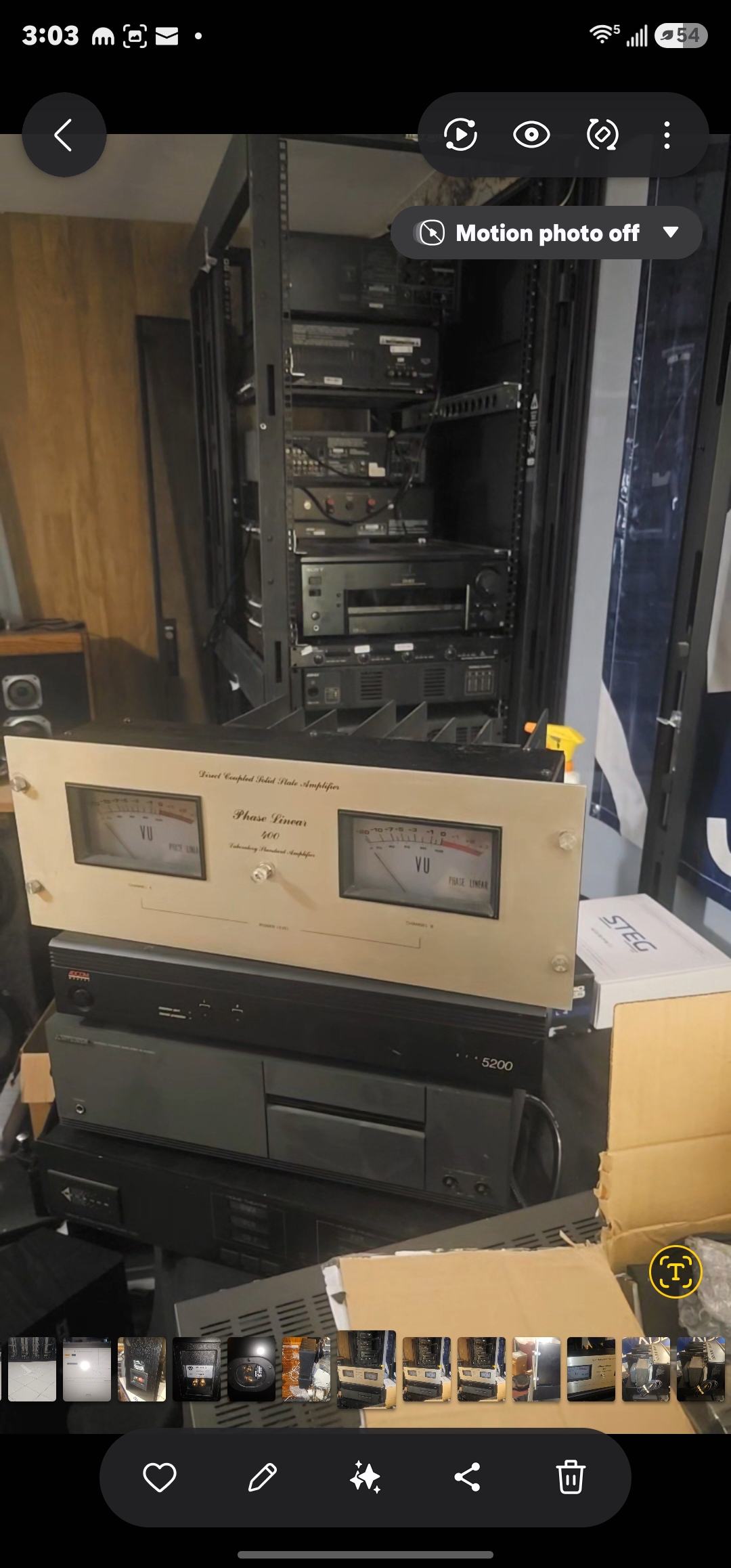

Wow getting pics to fit on here.. Haha sheesh. View attachment 79942View attachment 79943
Not sure what you are about here. First of all, whole house audio is a terrible idea, and thankfully well on the wane. It gives homes the atmosphere of a "shopping mall'.
Now when approaching a design as complicated as yours, you need to make detailed plans before any building starts. These are both engineering plans in terms of equipment, interconnection and speaker systems. But as important, of not more so, is detailed architectural plans. That means an auto CAD program, or if you are a washed up superannuated geriatric like me, then it means, pencil, paper and and an architect's ruler.
You must make detailed drawings before stating any build out. If you don't you will create an unhandy mess.
I see one bad mistake for staters. You show an equipment rack with major heavy equipment you can't get behind.
When you built the room you need to carefully mark the room layout with a 'carpenter's' pencil. I also I made cardboard cut to the size of the bases of larger items, to make sure everything would go together perfectly.
It is crucial to be able to get behind complex systems as the number of connections are immense.
Make sure you put cables that are behind walls or above ceilings in conduit. Cables fail and technology changes, so you need to make cable changes easy as that is a common occurrence. Do not make that mistake.
Careful planning and execution will make everything turn out just the way you wanted, and make service straightforward.
Trust me: - "Sod's Law" operates and you have to think of current and future problems, so good access and relatively easy service is essential.
If you can't fix it, you won't, so don't let that happen.
