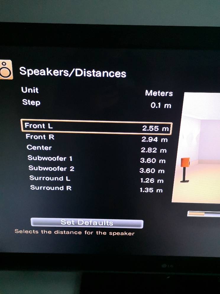

You should be getting messages if it's not working during setup.

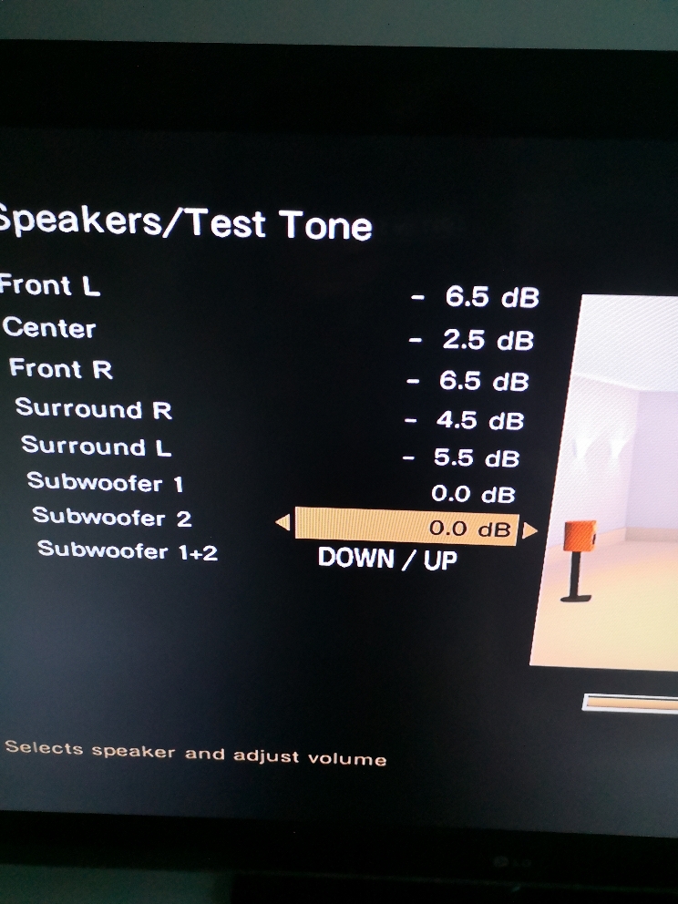

What are the distances and levels for sub 1 and sub 2 in the speaker menu?
There are the distances and levels. The SW is plugged in the SW 2 and it has sound. I just changed in the SW 1 and ......nonsond on the sw

Okay, those look like the default settings. Meaning Audyssey didn't do anything with it. So it looks like you haven't even gotten past the setup stage as far as your sub 8s concerned. Did it ever prompt you to adjust the volume/gain as a first step in the setup process? Something is definitely not adding up, but I can't tell if it's a glitch with your receiver or user error. When you run setup again can you take some screenshots of each step?
There are too many ways to make a mistake setting up to make troubleshooting this very easy.

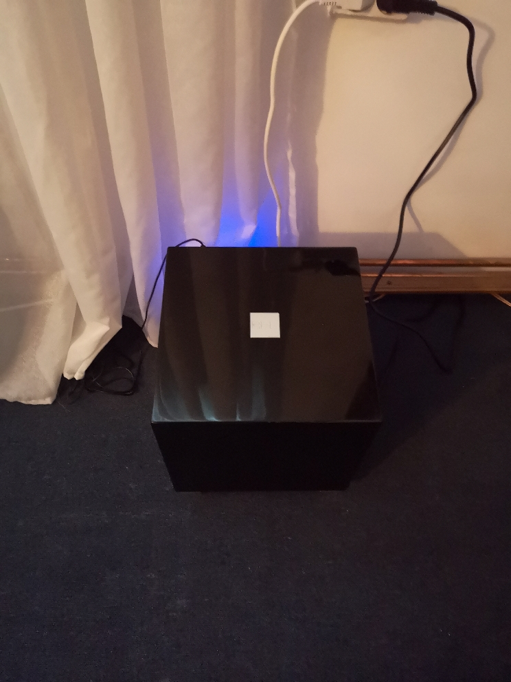

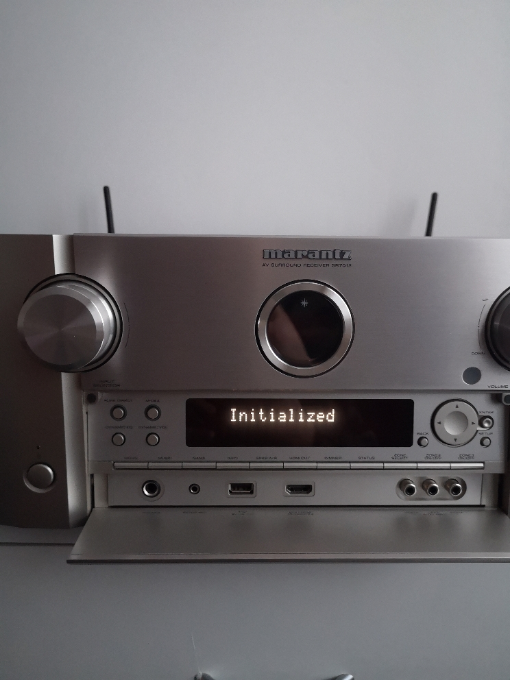

I just got home and I am doing a factory reset and I will post here every step. The SW is plugged in the SW1 and as the last photo show, I don't hear any sound on my SW1......actualy there is a fade sound on my sw. The receiver is at half sound as the se and I bearly hear it.

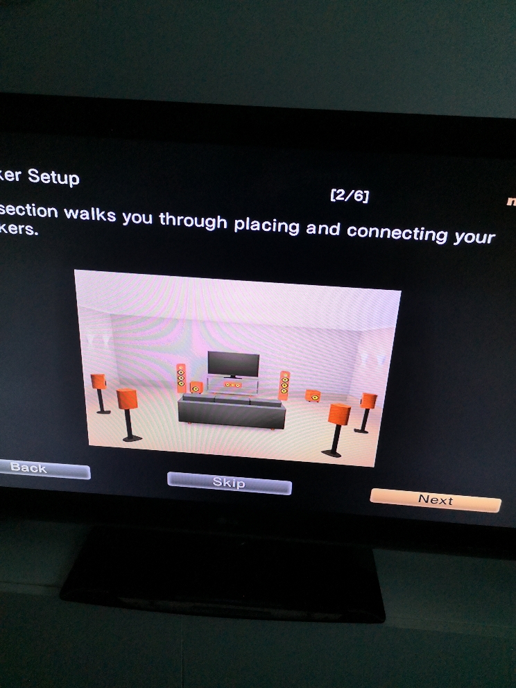

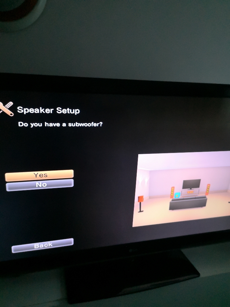

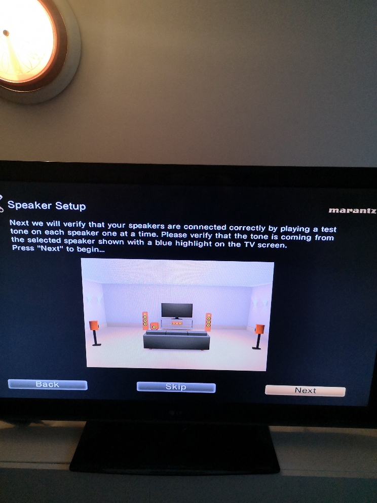

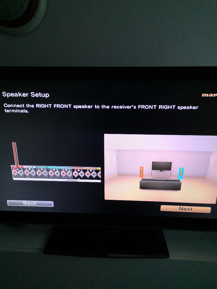

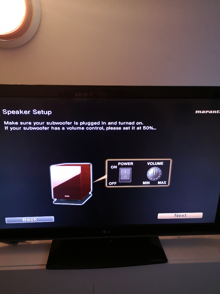

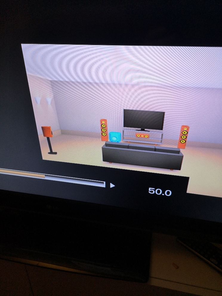

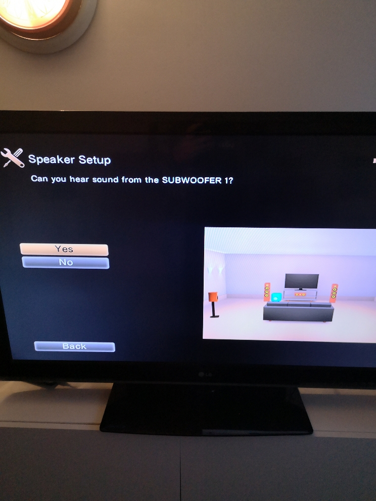

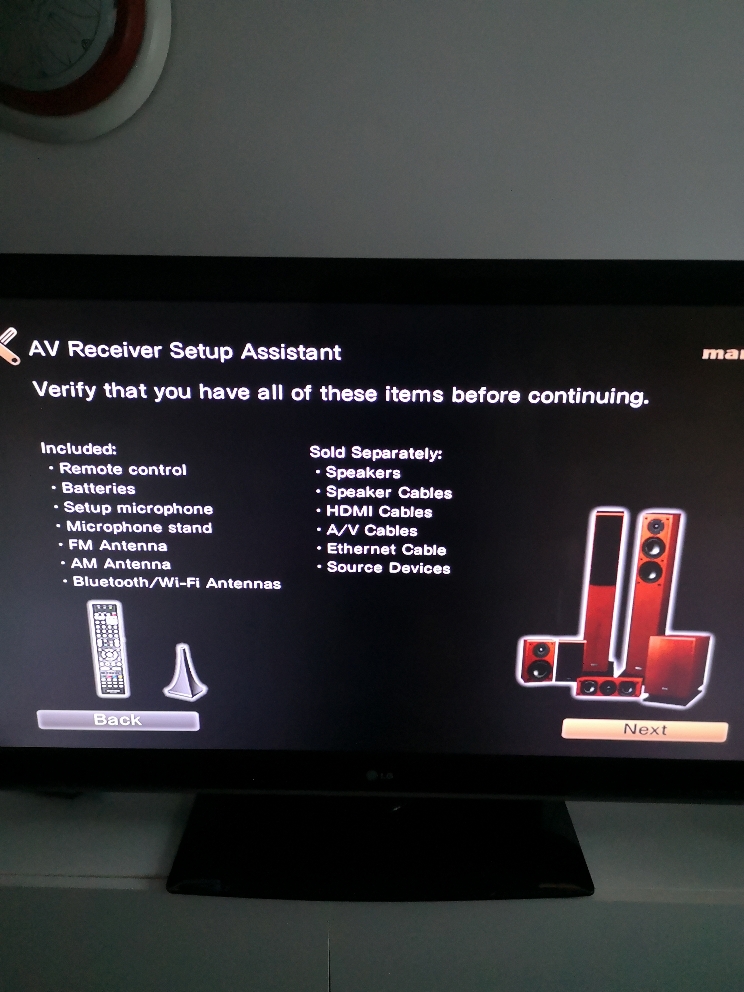

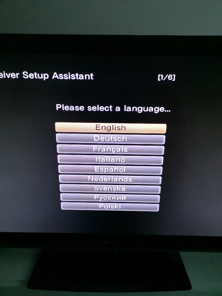

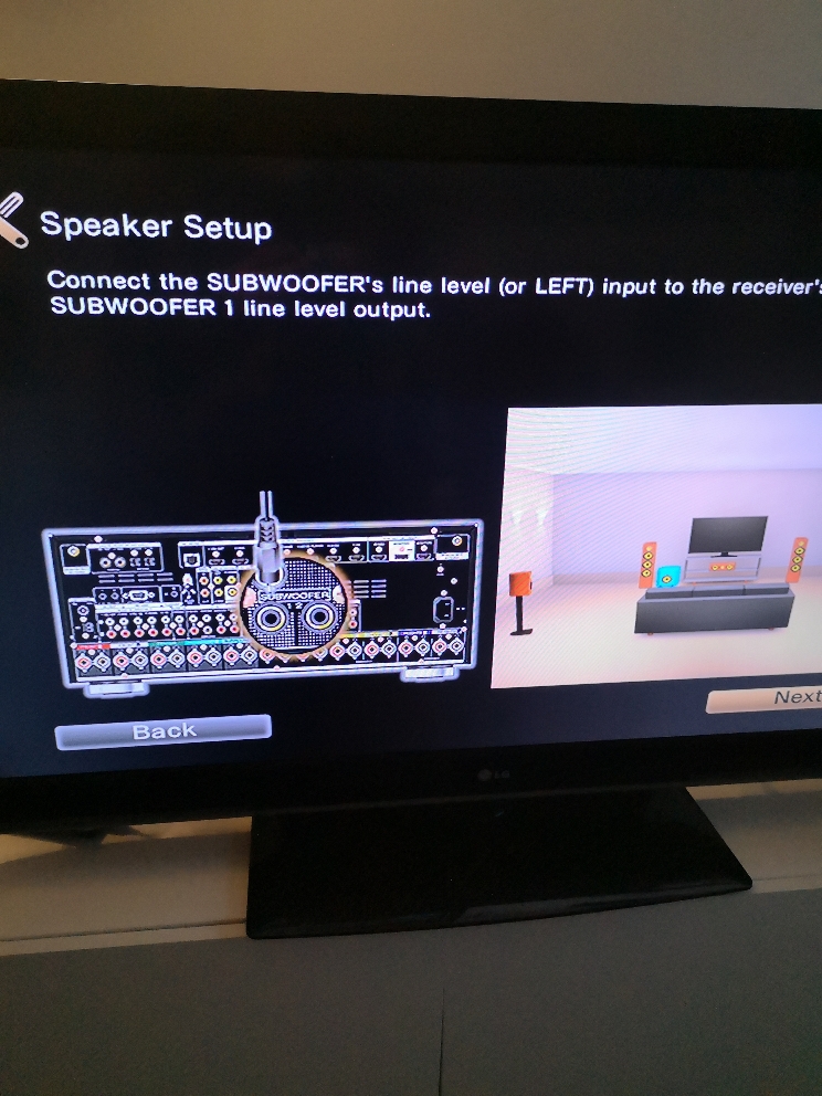

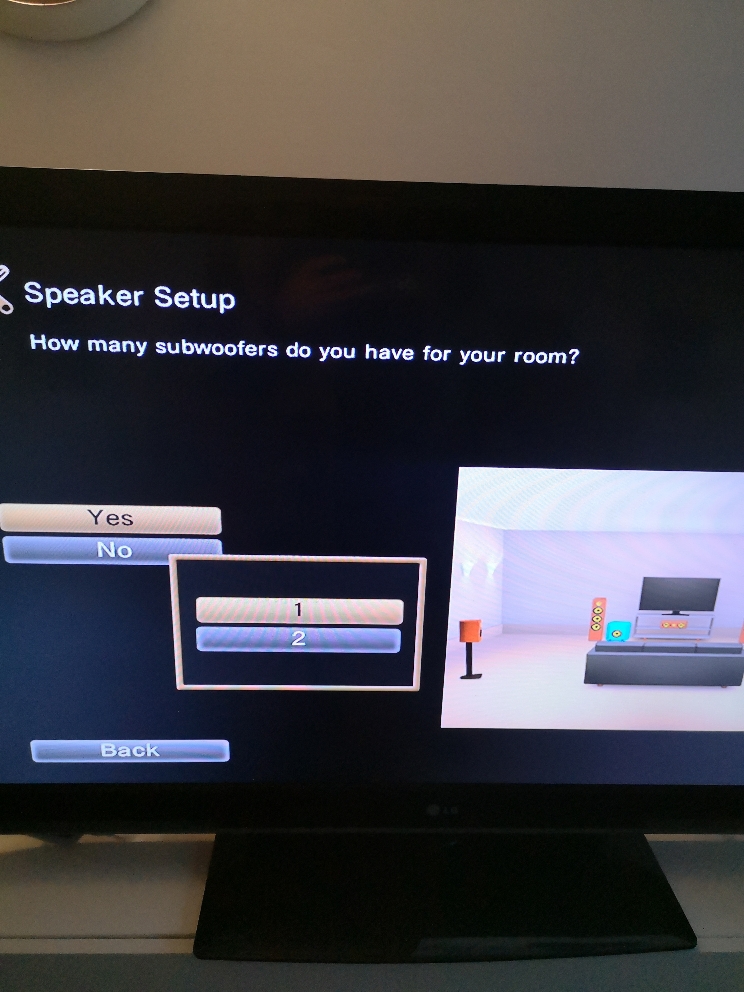

Hi. Please check below all the steps that I have done.
Sent from my EML-L29 using Tapatalk

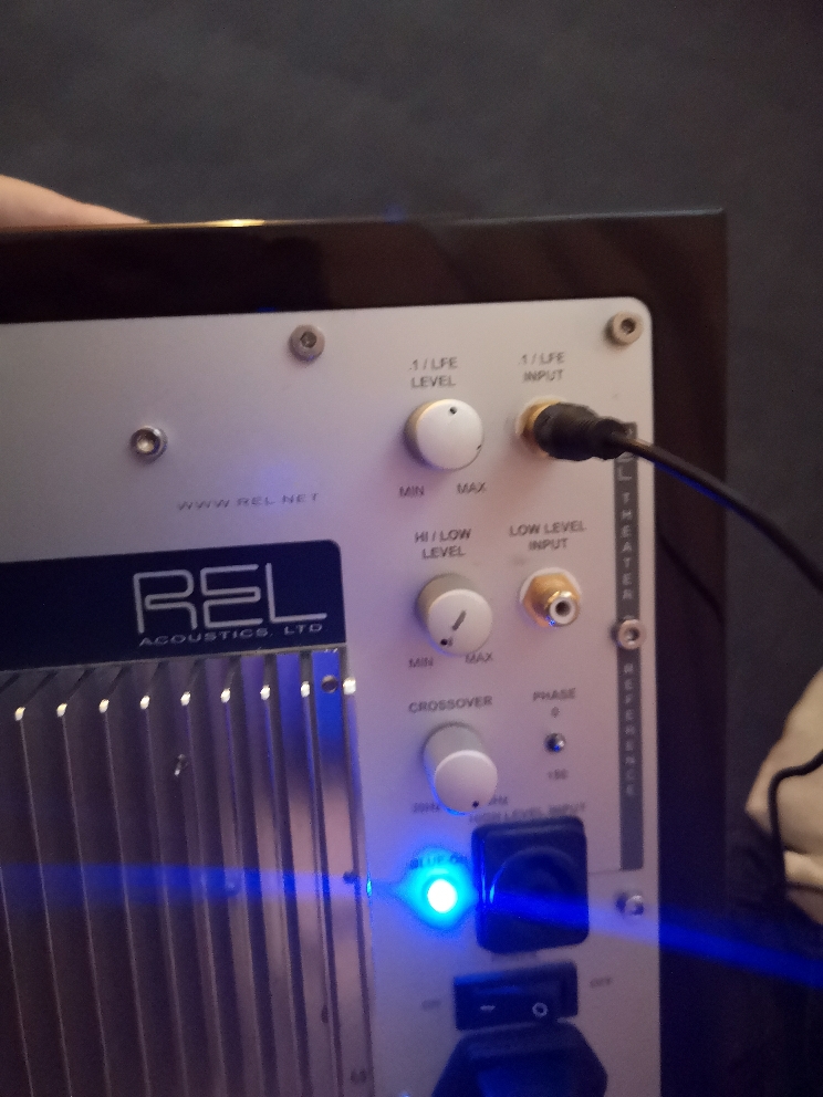

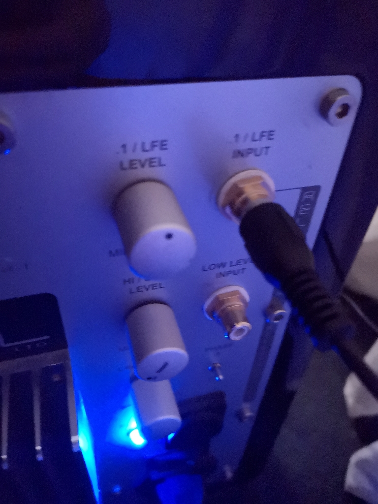

There is a sound in the subwoofer but very low. The receiver is at maximum and the SW is very very low ....with his volume at half.

and what happens when you move the .1 level knob..nvm Shouldnt make a difference since it works on sw2
It is a little bit loud, but not how it supposed to be

so its working now?

again move the knobs .. and verifying all worked as you have it ok in sw2?
C
comunicator2009
In the SW 2 is working
So you are getting sound then? Just not loud enough? That's where a message should pop up asking you to adjust the gain or volume nob on your subwoofer. You haven't posted an image of that screen though.
