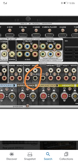

Hi guys. I have some issues with my SR7012. When I connect the subwoofer in the SUBWOOFER NO1 it doesn't work at all. When I connect it to SubWOOFER NO2 and I select from the menu 2 subwoofers, it works. I don't have Atmos speakers yet. I am using only 5.1 for the moment.
Does anybody encounter the problem?
Thanks,
Michael

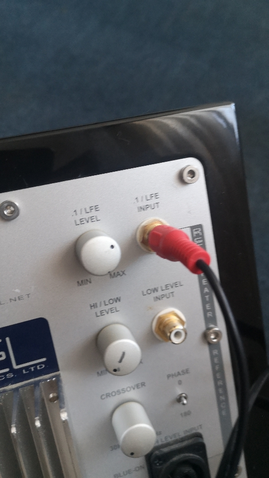

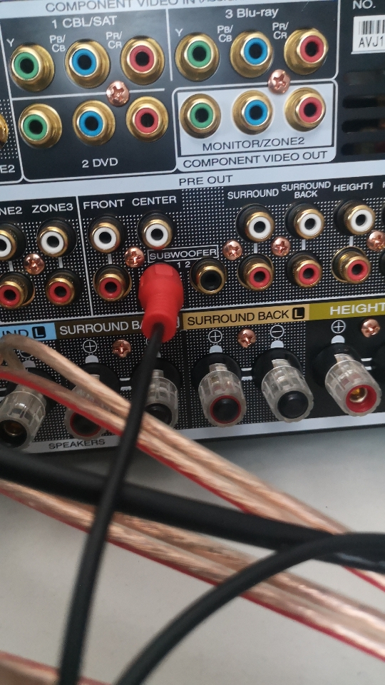

Yes, like 2 weeks a go (not new). I have tested today with another subwoofer.....the same. 2 subwoofer active......plugged in the first one ...nor working....plugged in the second one...worked. It is possible that the channel is dead?

Worst case can use y connect and just use Sub2 for both subs.
C
comunicator2009
Yes, I am using it like that now.
