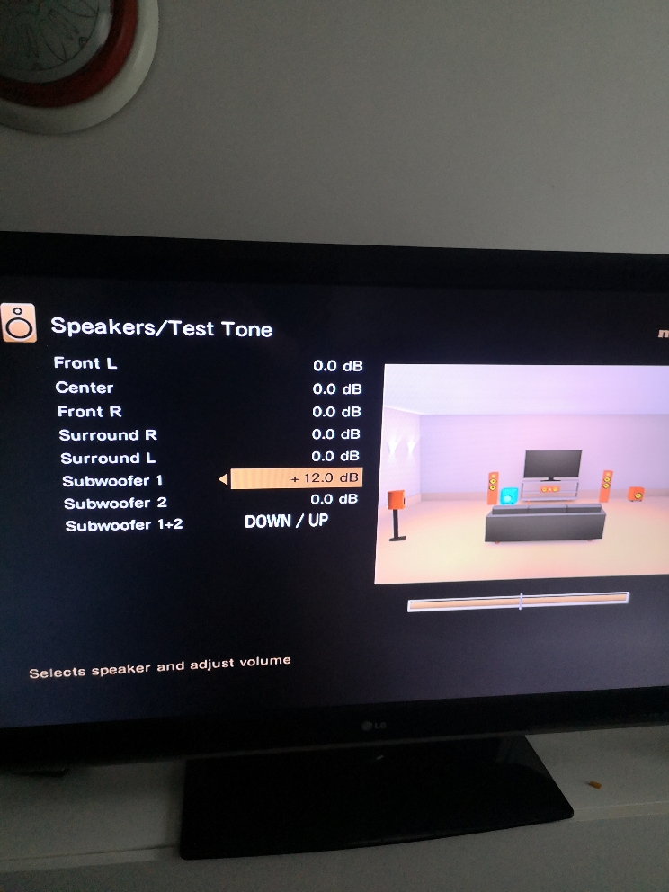

That's enough resets for sure. The thread is getting to long to trace back if you have tried the following:
1) Go to speaker menu, level and adjust SW1 to +10 and use the test tone to see if the sub now sounds louder.
2) If that doesn't work, use analog input (ext. DAC, CD player etc.), use stereo mode with the sub connected to sub1, and on the audio menu select stereo with sub on, and see what happens.
Just trying to see such changes can make a difference and narrow down the issue, not to fix the issue as such at the moment.
1. No sound at all!
2. No sound at all!

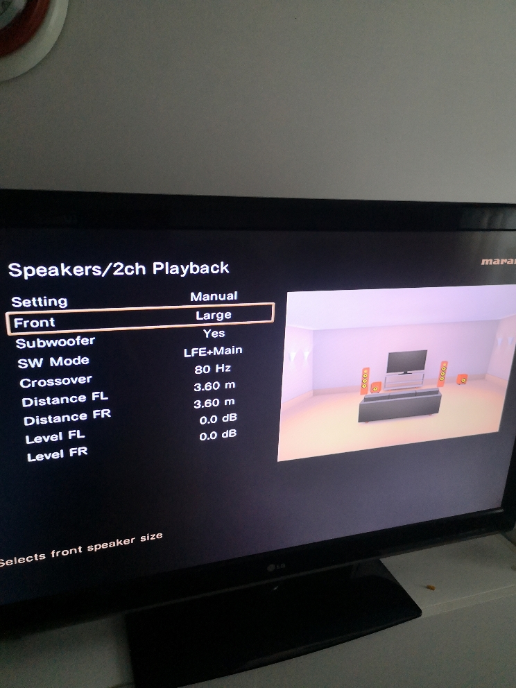

one i would set to small
and lfe. not large and lfe+main. may sound stupid but reach back there at the sw1 connection and giggle it to see if its loose making sure there is a solid connect..and i still say since seller had it to sw2 he knew of problem and never told you.. why else would he use sw2

Yeah, plus I just noticed too that he has LFE + Mains turned on so it should still work.

There's a language barrier here that's not helping at all either. I'm beyond the point of confused with his descriptions. "No sound at all", to "it's not loud enough", to not seeing a satisfactory answer as to what happens during setup when Audyssey asks him to adjust the gain on his sub.
So, when I make the factory reset and I arrive at the speakers test tone....there is a sound ....not loud. When the setup is finished and I go the the meniu for the test tone....no sound....that's so wierd.......

granted you’ve done resets. i would set reciever to factory default and restart process as if you just got it. set it up and you dont actually have to do audessey you can do the speakers manual with the test tones to hear everything is working. audessy you can do after. do the setup step by step.
Sent from my EML-L29 using Tapatalk
does it get louder as you raise the db’s in test tones.. including sub
So during setup it will play the tone and have you adjust the volume on your sub? Are you able to adjust it where Audyssey wants it?
I think your expectations need to be adjusted. That test tone in the menu for the subwoofer is very quiet. It just is.
