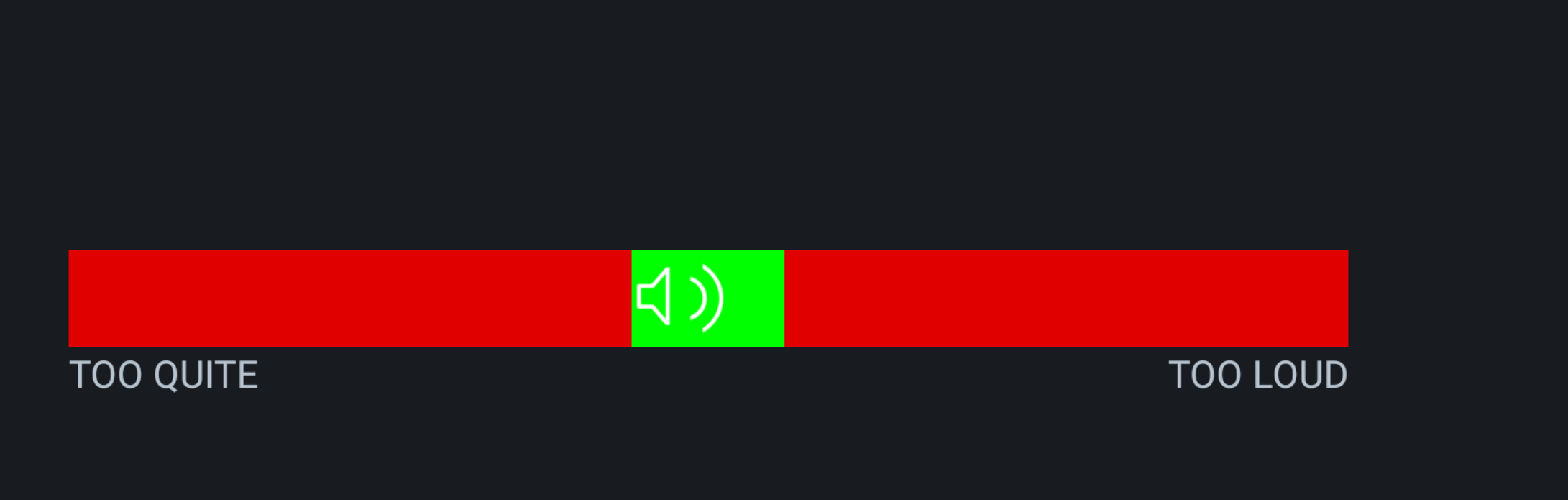

I want to know what happens when Audyssey asks you to adjust the volume on the back of your subwoofer. A bar should come up that is red on the ends and green in the middle. It should ask you to adjust your subwoofer's volume (gain) until it is in the middle (green section) of the bar onscreen. Are you able to adjust it so that it's in the green?

What happens when you get to this step?
Are you able to get it in the green?

There is no such thing in the meniu.
Sent from my EML-L29 using Tapatalk
There should be. That or a message saying no sub was detected. This is what I've been asking you about from the start of the thread. It's the first step in the setup process.
Not all the audyssey avrs have this particular format.

If his is the SR7012, it should have that for sure.

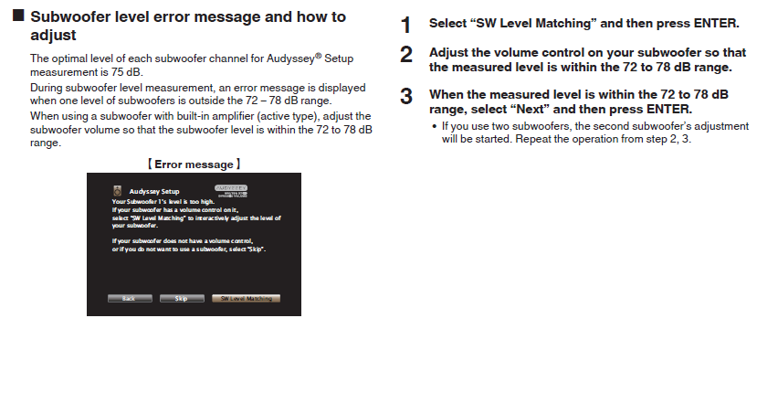

It is true that in the manuals, they never show the image of the onscreen meter bar but they do talk about the error message and the onscreen bars should be there when you run setup to that point. Both my Marantz AV8801 and Denon AVR-X4400H has it, your 4520 probably has the same too.
Below is from the SR7012's owner's manual, exactly the same word for word for the Denons.
Been long enough I don't recall the exact contents of the screen on the 4520, but does have a dB readout as well as the red/green thing. Usually the D&M stuff is fairly similar for GUI, tho. No colors on my Onkyo setup, just a dB readout (but has also been a while, pretty sure :) ).
Overall, tho, I would like a step by step confirmation/recap of what his Audyssey setup is with screen shots....but overall is sounding like he's got an avr issue of sorts he can't straighten out....
