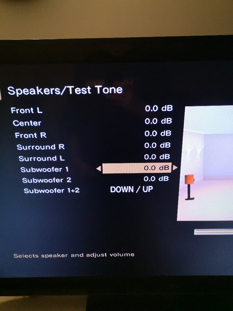

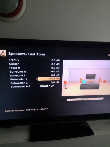

There could be multiple reasons, but I think most likely a loose connection. Someone ask when you ran testone you heard sound but at that point did you turn the volume up to see if it gets louder? Again, not a fix, just part of the test.

PENG
At maximum
Sent from my EML-L29 using Tapatalk
I think he/we meant turn the master volume up also while playing the test tone, not just the level trim settings that your screenshot shows. When you turn the volume up, the onscreen display bar should show up and could go up to +18 in the relative scale of 98 on the absolute scale.
I did that, and no sound at all
