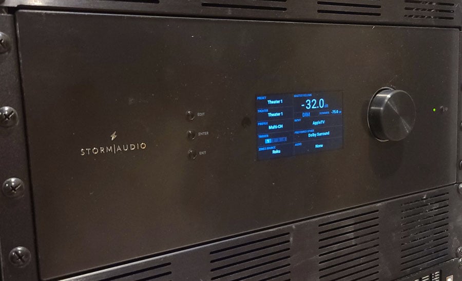

Here is Gene's review of the Storm Audio with Dirac and information related to multiple subs. Maybe he can update the review with an ART update at some point but it is a process to swap out 13+ channels just to test the same product feature in different brands. (Which I'm not even sure ART was available when he did the physical review of the Marantz)
