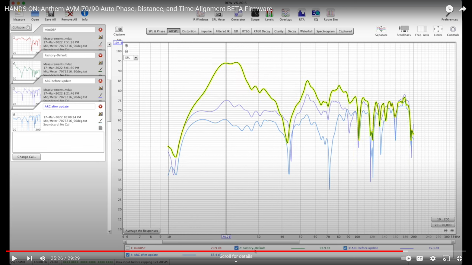

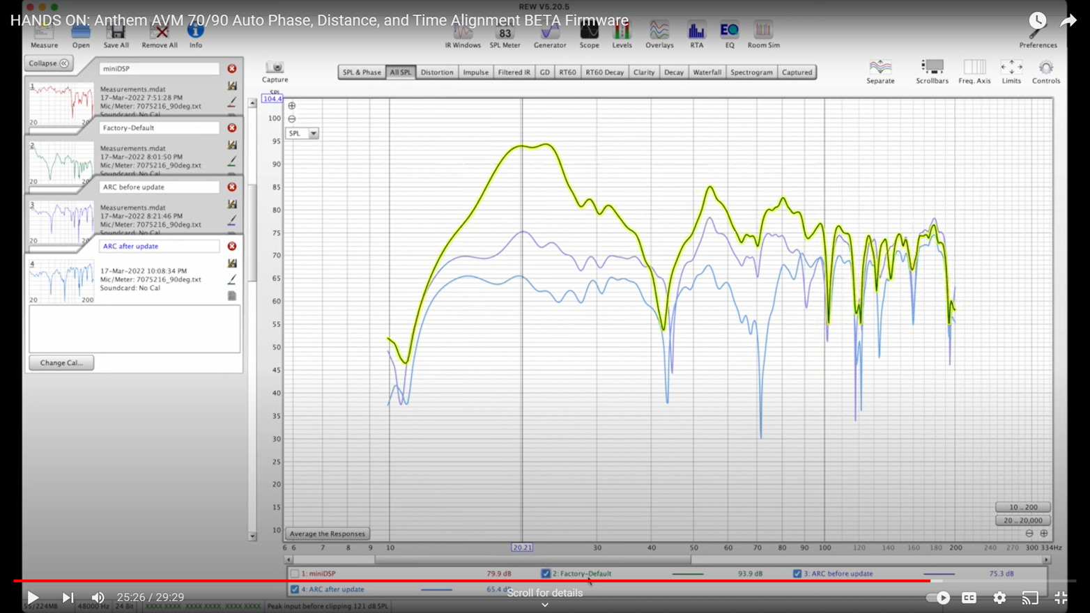

HANDS ON: Anthem AVM 70/90 Auto Phase, Distance, and Time Alignment BETA Firmware - YouTube
In this video, you can see that the reviewer also found that running ARCG, out of box without any manual intervention, resulted in a suck out at below 50 Hz, very similar to what I have discovered.
Again, I must say this again, as long as one knows about it, a couple hours of tweaking can still end up with great results, though as the reviewer said, you really have to know what you are doinng.
Conversely, for those who don't know about issue, then I guess "ignorance is bliss" would apply. For me, I hope future ARCG versions will fix the issue. I am not too hopeful though, because I got the feeling that the vast majority of Anthem users are very happy with ARC G so Anthem may not feel the need to do anything. Quiet wheels never get the grease!
